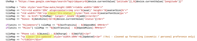

After the recent API changes I’ve finally switched to this app and it’s working very well thanks :grinning:
Could I request that classes like the above are added to the html attribute please? This makes it much easier to style the tile to fit in with the rest of the dashboard.
