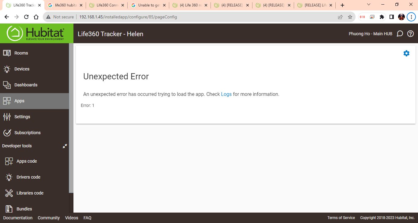

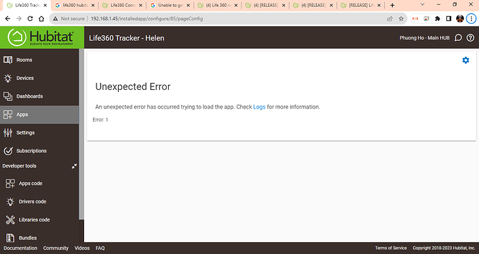

I tied that, but when I go the the Life360 Tracker I still get this error:
What AM I doing wrong?
This is the error in the log:
java.lang.ArrayIndexOutOfBoundsException: 1 on line 100 (method pageConfig)
java.lang.IllegalArgumentException: Command 'sendHistory' is not supported by device 186. on line 716 (method userHandler)

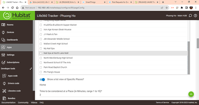

Hi,
Is it possible to increase the list of locations for the child driver? I have quite a long list and when I tried to select locations to track, the list got cut off and not show me the entire list.
Thanks!
Please show a screenshot of what you're seeing.

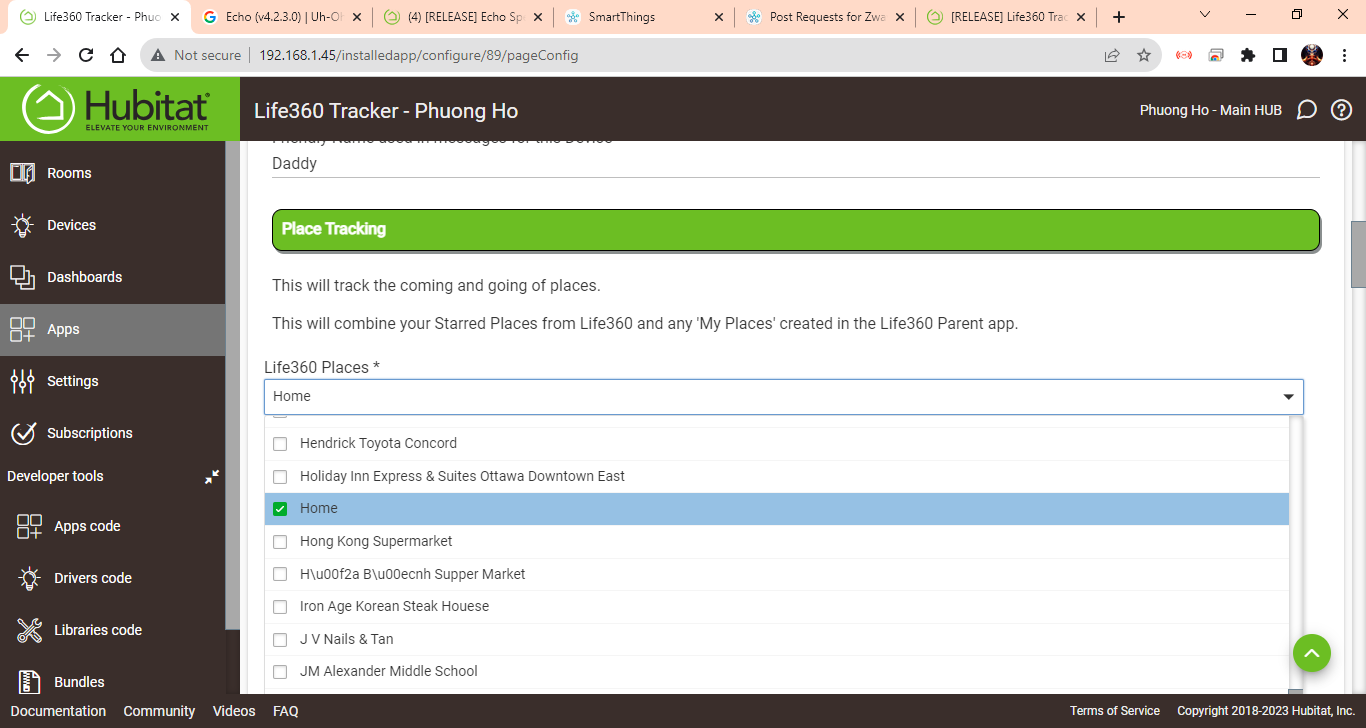

Attached is the screenshot:
The it only show 30+ places in the list. It won't ley me scroll past that.
Thanks for looking into!
Weird, I have over 100+ places and they all show up in the list. There isn't anything in the code that limits the size of the list either. Not sure what browser you are using but if it isn't Chrome, then give Chrome a shot and see what happens.

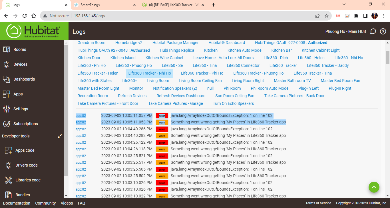

I am using chrome. This is the error I got from the log:
app:822023-09-02 10:05:11.057 PMerrorjava.lang.ArrayIndexOutOfBoundsException: 1 on line 102
app:822023-09-02 10:05:11.053 PMwarnSomething went wrong getting 'My Places' in Life360 Tracker app

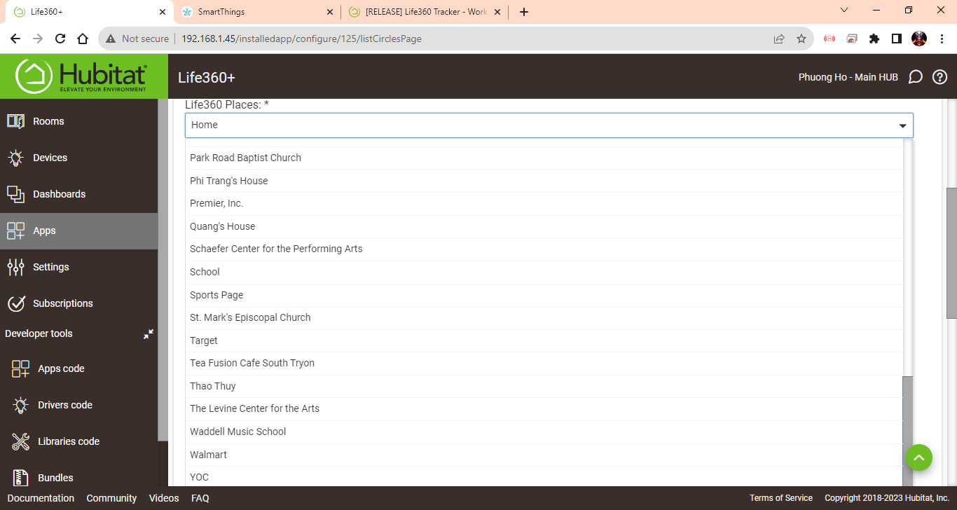

All the places are there in the Life360+ though:
I got all the way to the YOC which is the last place on my list in life360. Just the Life360 Tracker - Child Driver not show places. it only got up to "Phi Trang...." place and won't let me scroll pass that.
Are you using 'My Places' in the parent app and are you using the free or paid version of Life360? Can you show me that page?
No I am not using 'My Places' in the parent app. I am using the paid version of Life360 with unlimited places.
Okay, can you show me the actual 'My Places' page though.. just in case I see something
Try the new version 2.2.2. Turn on Debug Logging and make it error out again. Post the screenshot of the debug log.
