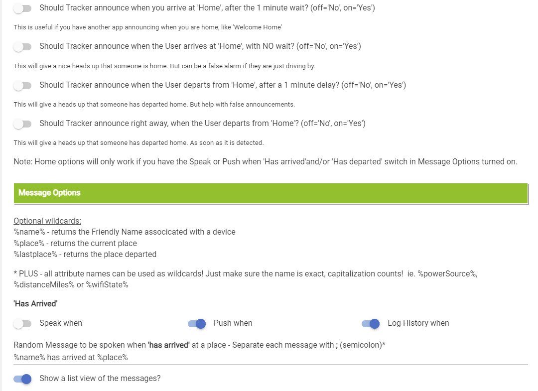

@bptworld: Firstly thanks for all the hard work. Sorry for asking this question but is this app still working fine with C7 and the current HE firmware? I installed the app (Life360 with States as well) and set it up. Everything seems to be quite fine. I get notifications if a user arrives a specific place, I get notified if someone is in the move but unfortunately I don't get any notifications if someone departs home or one of the other places. Can you maybe help out with this and please tell me which type of debug logs you need. Just from HE or do I have to turn on debugging logging in the dedicated child app? Would be so nice to get this to work.

Hi, turn on debug logging in the child app. Make sure to post a screenshot, not a copy and paste.

Hi @bptworld: please find below the screen shot of the debug log from this morning. Arrival notification works well but no departure notification. I also saw the error message in the log file.
Hopefully that helps to find something out and please let me know if you need more information.
Thanks again for your support

2.1.9 - 10/29/22 - Fixed typo
Thanks for the very fast response. Will try it out immediately. Just ran into another issue which is not related to Life360 Tracker. Just wanted to update the bundle using bundle manager. Will post in the dedicated folder. Will keep you updated in regards of the Life360 Tracker app.
Thanks for the update. 2.1.9 seems to work fine now.
