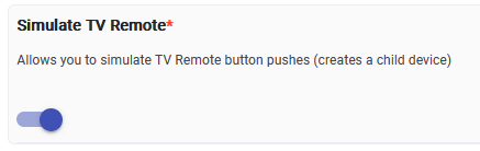

@jbasen have you enabled......
Guide worked for me once that was enabled

Yes, I have enabled Simulate TV Remote. I appreciate your letting me know that the guide function worked for you. I'll have to dig in deeper to see why I'm having problems with that one command as all the others seem to work fine.
Thanks again

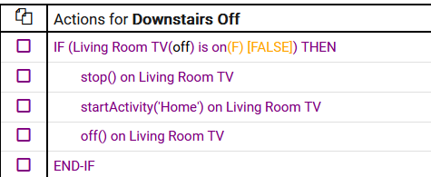

Can totally see why you'd want to do this, but it's not a function of the driver. At least I don't think it is. I'd suggest you use Rule Machine (or Node Red or ....) to perform these actions to the driver under your preferred circumstances.
If using RM, for example, you could trigger off TV Switch turning on, and have the action be getActivity. If you wanted to do last activity, you'd need to stuff that in a hub variable I would imagine when the TV was on last.
Make sense?

Yeah it's an odd one. When I use the remote to power on it always goes to the home screen. Also, I setup the LG ThinQ Alexa Skill yesterday so I can power on/off by voice (to replace my Logitech Harmony Alexa Skill), that also turns on at the last used activity. So it seems the power on of the remote is different to what the TV's API uses to power on, which makes sense as the remote uses IR for power on/off.
Good idea on the RM, I can just set it to 'Home' before power off. Assuming I can work out how to do that with a conditional action to check it's on first!
I think this should do it, will test later!
