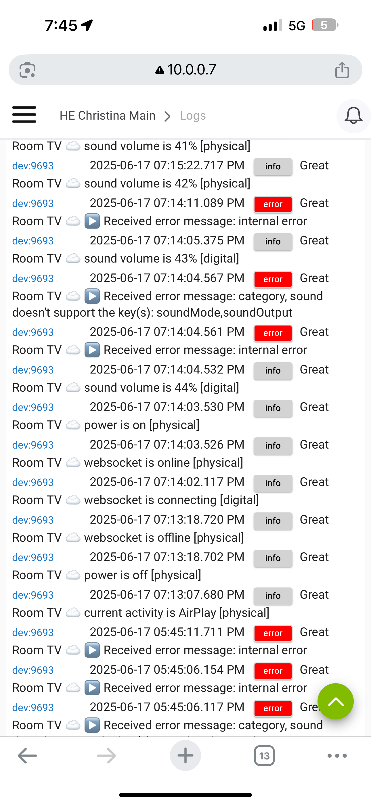

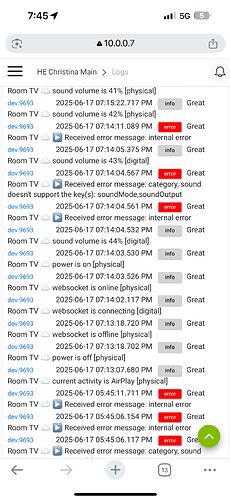

LOL no sooner did I say “all good”, that I started getting a string of errors in the log. Note, the TV at issue wasn’t/isn’t even powered on (nobody was in the house all day today), so I’m not sure what triggered this or what it means:
