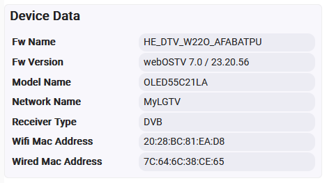

Do you see the MAC addresses in the Device Data section from the Device Info tab?
{C09BF61A-19EE-4D5A-961E-4C71EC97E7C0}
I also found this info online about enabling Wake-on-LAN:
Ensure that the TV can be woken via the network. For the CX line of displays this is accomplished by navigating to Settings (cog button on remote)->All Settings->Connection->Mobile Connection Management->TV On with Mobile, and then enable 'Turn On via Wi-Fi'. For C1, C2, C3 and C4 it's All Settings->General->Devices->External Devices->TV On With Mobile->Turn on via Wi-Fi. NOTE! This step is needed regardless of using WiFi or a cable.
Thanks for the info on WoL, will test further tonight.
MAC address is not populated:
It appears that the TV does not expose the MAC address. To address this, I have released version 1.1.1, which utilizes the Hubitat built-in function getMACFromIP() to determine the MAC address.

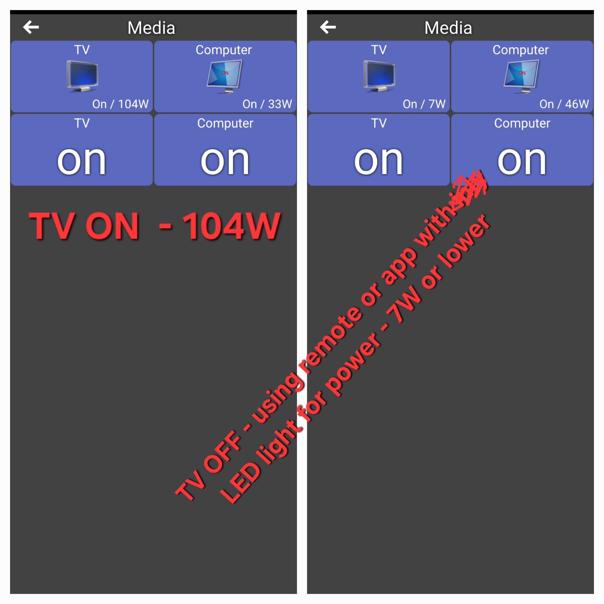

My TV is connected to a plug socket to enable turning on from a button controller or Google Home.
I did turn it on remotely, but again I was not able to turn it back on after turning it off using the app, will need to check when I am home.
Also, can you clarify if the getMACFromIP should populate the MAC address in the Device Data?
Thanks again

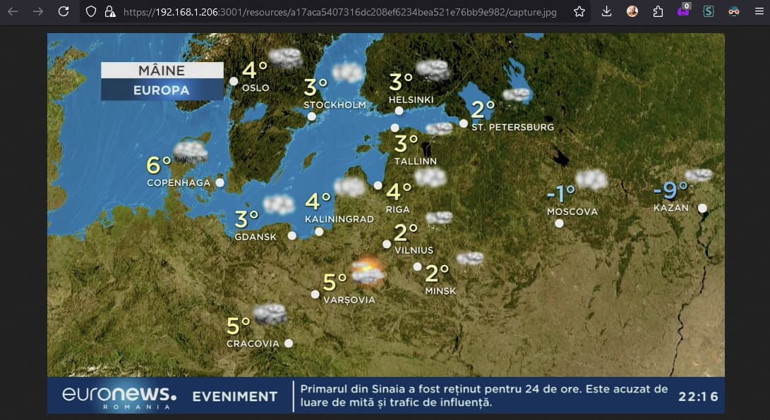

  • Add "Take" command to take a TV screenshot
Fixed
  • Correctly identify event type (digital vs physical)
The screenshot image URL (hosted directly on the TV) is saved in the "image" attribute. Example:

I'm having the same issue with this driver as the driver by mrferreira89. TV will turn on around 50% of the time although it does turn off 100% of the time.
When it doesn't turn on Log shows:
dev:1452025-01-23 03:54:55.117 debug route to host (Host unreachable)
dev:1452025-01-23 03:54:55.077 warn oh snap! failure: No route to host (Host unreachable)
Then I have to use either the remote or Thinq app to turn it on, after which the Hubitat commands will work.
