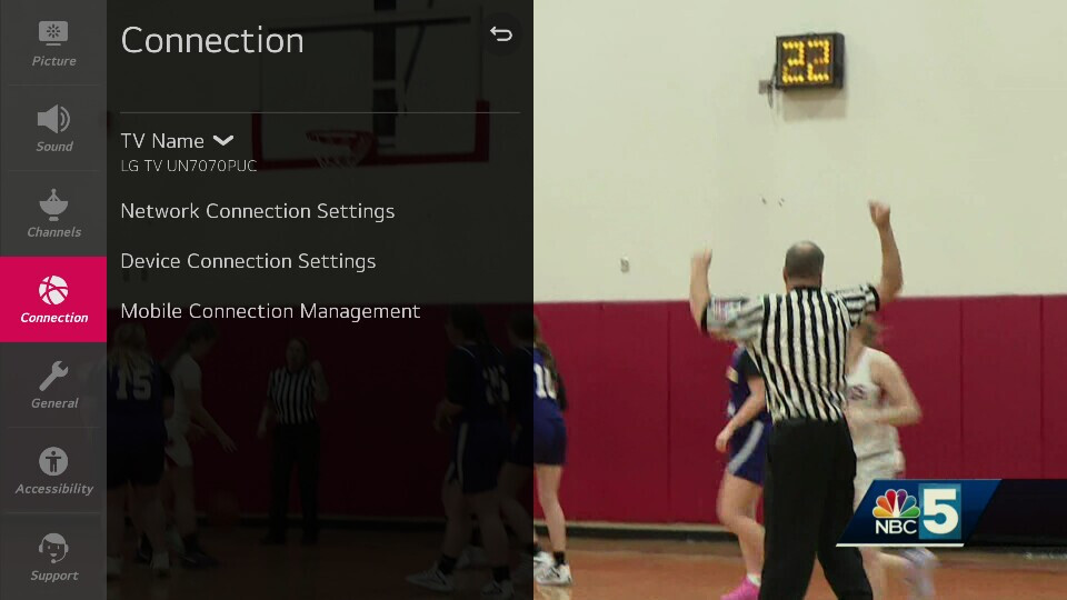

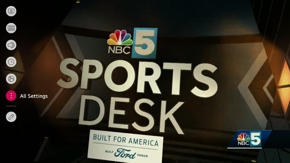

In case anyone is looking for this info, I enabled Network IP Control the following way on this model: first, go to "All Settings"
Then move the cursor to Connections but do not select it.
Type 82888 on the remote to get to a hidden menu

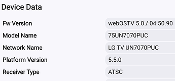

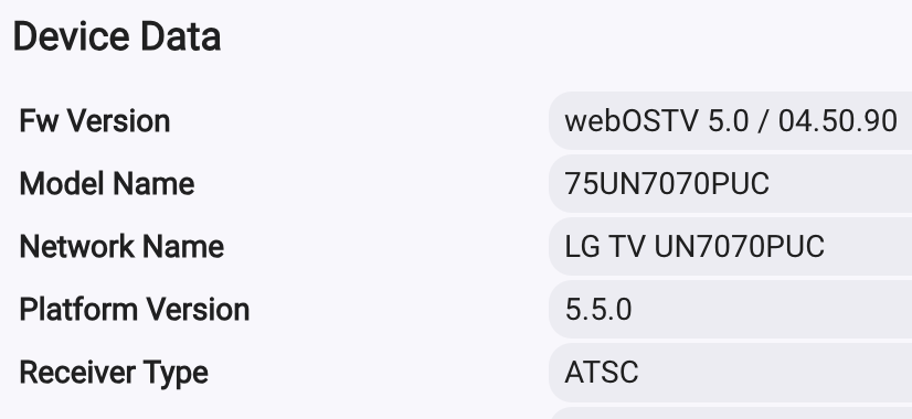

Thanks! works perfectly.
Tested model:

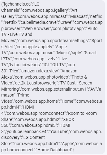

Here is my activity list as requested a few days ago...
