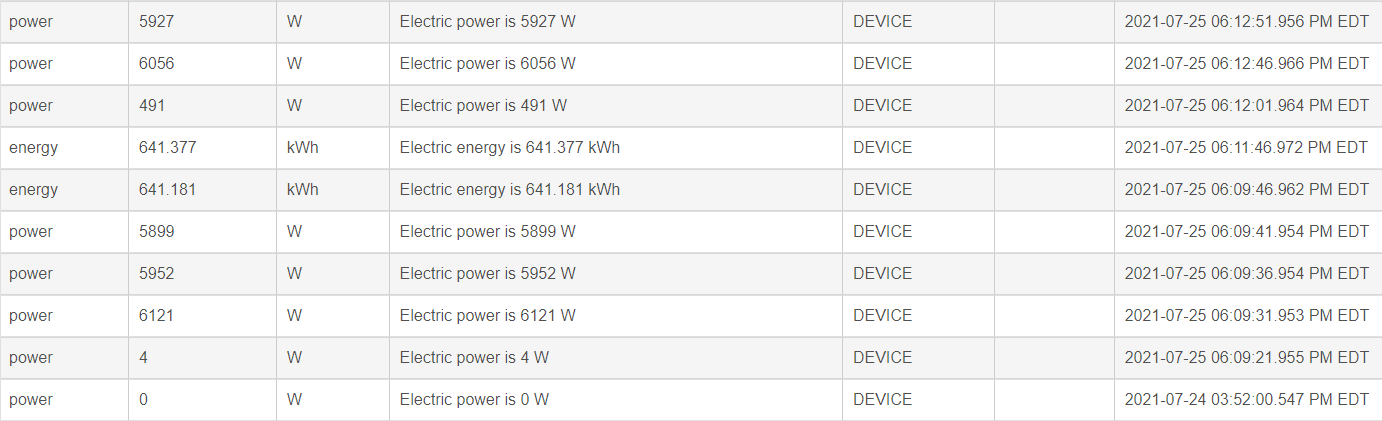

I've been having an issue lately (unfortunately I'm not sure exactly when it started) where I get a "dryer has finished" notification almost immediately after starting the dryer. Here is the event log of my Aeotec HD Smart Switch. You can see where it reported 0W when it finished a load yesterday. It reported 4W when I turned it on then jumps up to 6kW once I started the cycle.
Here is the event log for the virtual device the app creates. You see the same thing as above, but for some reason thinks the switch turns off and then back on. I'm not doing anything other than putting clothes in the dryer and starting it.

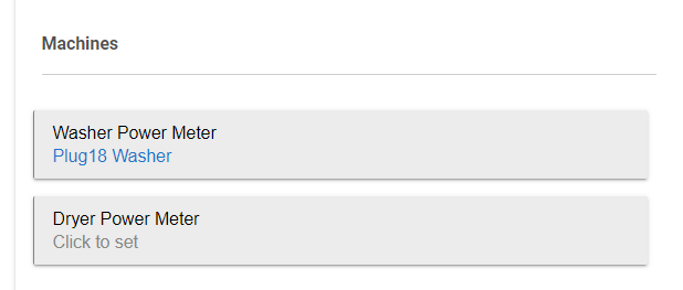

This is how my preferences look.
I'm using the latest version available in HPM. I do not have a button or contact sensor set in the app.
@mark.amber I had forgotten I made the washer & dryer optional. I need to add an additional check so you don't get the error. Thanks for pointing it out.

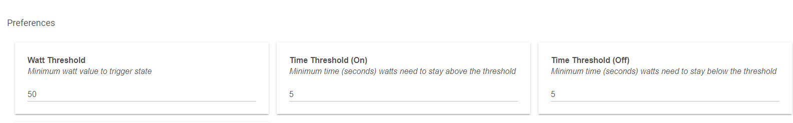

I have a question. Is there any way in the laundry manager to set the power level at which the washer is considered "OFF"?
When my washer completes the wash portion of the cycle and starts to refill the tub for the rinse cycle, the power drops to 5 watts. Laundry Manager sees that as the load completed so an completion announcement is triggered. We know that the load is not complete, so we just wait for a second announcement indicating the rinse cycle is completed and the load is finished for real this time. I presume if we did a second rinse, that we would have to wait for a third announcement. it would be better if we could just get a single announcement when the power drops to zero and stays there.
@rwclements228 You could set your time off threshold to a larger value… long enough to account for the refill time.
How do you do that?
As far as I can tell, the only user entered parameter is the reset time. I have that set to 20 minutes.
Where can I find the time off threshold? Is that something that has to be midified in the code?
@rwclements228 You do it in the device settings.
Devices > Laundry Washer > Time Threshold (Off)
Thanks so much. I did not realize I could adjust the washer parameters in device settings. I will play around with the settings until it works properly.
Thanks once again. After I adjusted the parameters, the Laundry Manager properly announced the end of the full washer cycle without the intermediate interruption after the wash cycle. You were most helpful.
