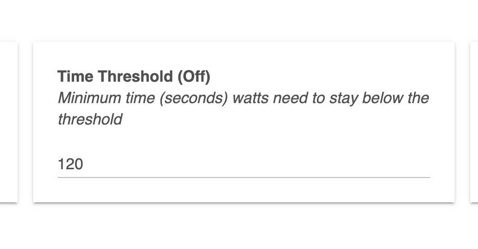

I am getting several finish notifications, It looks like my power plug drops to a value below threshold for just a second 2.021W and I am getting a message it has finished. Is there a setting that will wait X time to see if it goes back up.
Thank you, I was looking in the app not the device. Thank you for pointing it out.

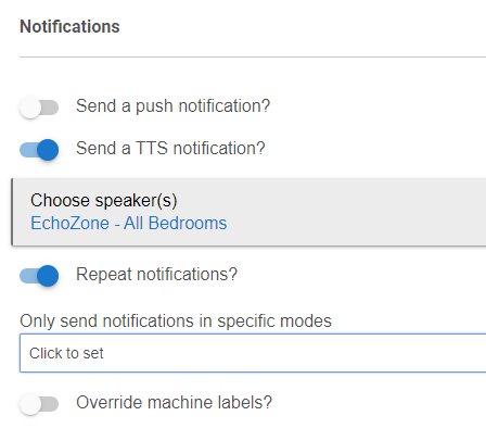

What is the difference between 'push' and 'TTS' notifications?
And did 'Repeat Interval' go away?
(this was from your original posting and I don't see it in my version of Laundry Manager)
I noticed the other day that I was getting TTS notifications even though I had modes set for the "Only send notifications in specific modes" option. I believe line 236 is the culprit as modesTTS is not defined anywhere in the app.
I'm not sure what your original intent was but I modified it to be:
def modeTTSOkay = !modes || modes.contains(location.mode)
This makes it send the TTS notifications based on the modes selected.
Push notifications are text based whereas TTS (text to speech) is for spoken notifications (Alexa or Google).
It should still be there. I would try toggling repeat notifications off/on.
Thanks for finding that bug. I will fix it.
That makes sense I guess. I was thrown off by seeing the speaking devices show up in the Push Notifications device selection list.
That fixed it. Thanks.

Been working pretty well for a while but now it's been seeming to ignore the time settings. Anything I should be checking? When the power level dips below threshold for even just a tiny moment, the device changes to "finished"
This app works really well. I would love the ability to also use it with my dishwasher.
@markbellkosel84 Are you noticing that the power attribute gets updated consistently? It's odd that it would stop working suddenly. I would try saving the device settings again. This will trigger the state to clear. Perhaps a state variable got messed up along the way.
