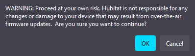

I can't get the OTA firmware to start. Maybe I'm not doing it correctly. I have the 1810 paired. About a foot away from the hub. I press a button on the remote right before pressing the firmware update to wake it up. I see nothing about it updating in the logs.
Do you see the "Are you sure" warning popping up?
fwu_warning
Make sure that you view all log entries: in a new tab, go to "Logs" from the left menu (not the "Logs" button on the top of the device page). Check that you're on the "Live logs" tab on the top. Also click the "Clear filters" button, just to make sure that some log entries are not filtered out.
You should get a log entry from the Hub device (sys:1). I get this, but you should see something else if you're not on the latest firmware:
It is good that you (re) paired the device really close to the Hub just before starting the firmware update process! By doing this, you "force" the device to choose the Hub as its Parent. This way the Zigbee update messages (~2K) go directly from the Hub to the device, without bouncing all around the Zigbee mesh in order to reach the device.
