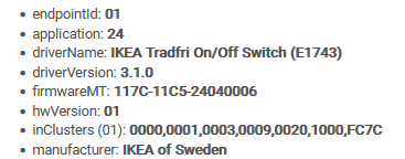

I believe this is not the case. The correct OTA file is identified by looking at the first 2 identifiers in the firmwareMT property (last one identifies the version):
firmware-mt
I think that any IKEA smart device can be paired with HE, just follow the pairing instructions in the README file from the OP. Devices with old firmwares have the problem that, after pairing, they don't send any events to HE (but they pair just fine).

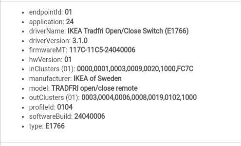

This is the detail from my E1766, updated by Tradfri hub:
Open-Close details
117C-11C5 does appear to be the same firmware as the on-off controller. From what I was reading elsewhere, it looks like they control the difference between the E1766 and E1743 with userdata in a non-firmware portion of the flash, there were people investigating being able to convert E1766 and E1743 by overwriting this data (with a flasher cable): IKEA TRÅDFRI / DIRIGERA OTA file versions matrix · zigpy/zigpy · Discussion #660 · GitHub
You, sir, are right. I stand corrected. Nice find!

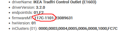

Hi @mike.maxwell ,
Can you add also 117C-1101-23089631-tradfri_control_outlet-2.3.089.zigbee please?
I can test the OTA update for this device.
done
Thank you - the update was completed in 8 minutes!
No need to restart / repair - all working OK now, thanks!
