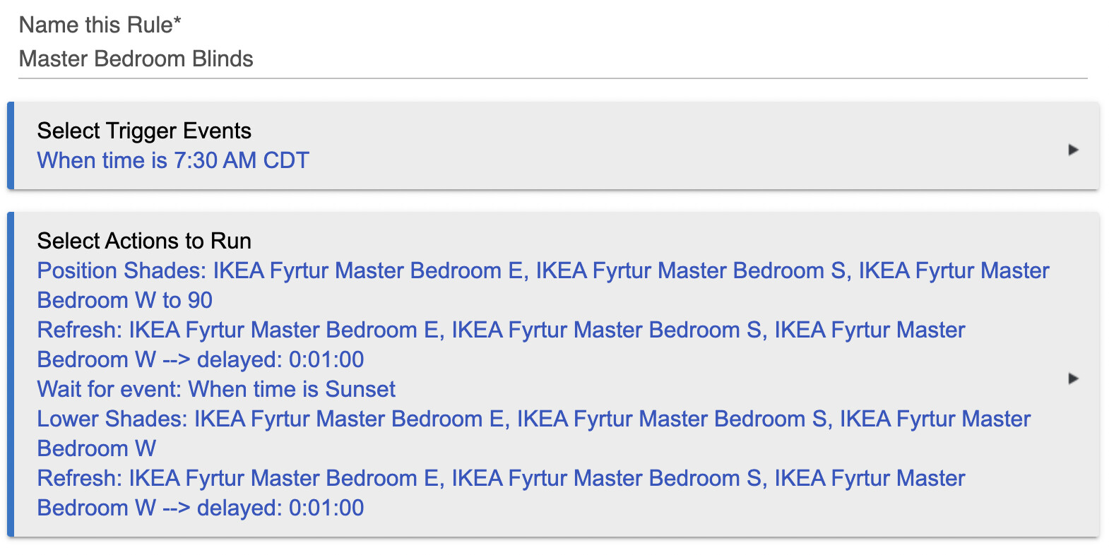

I also have seen the blinds status out of sync from actual state issue. I've added a line to the Rule Machine automation that drives them to do a Refresh of these devices +1 min after moving them, as pressing the refresh button on the Device page for each seems to do the trick. Hope this works.

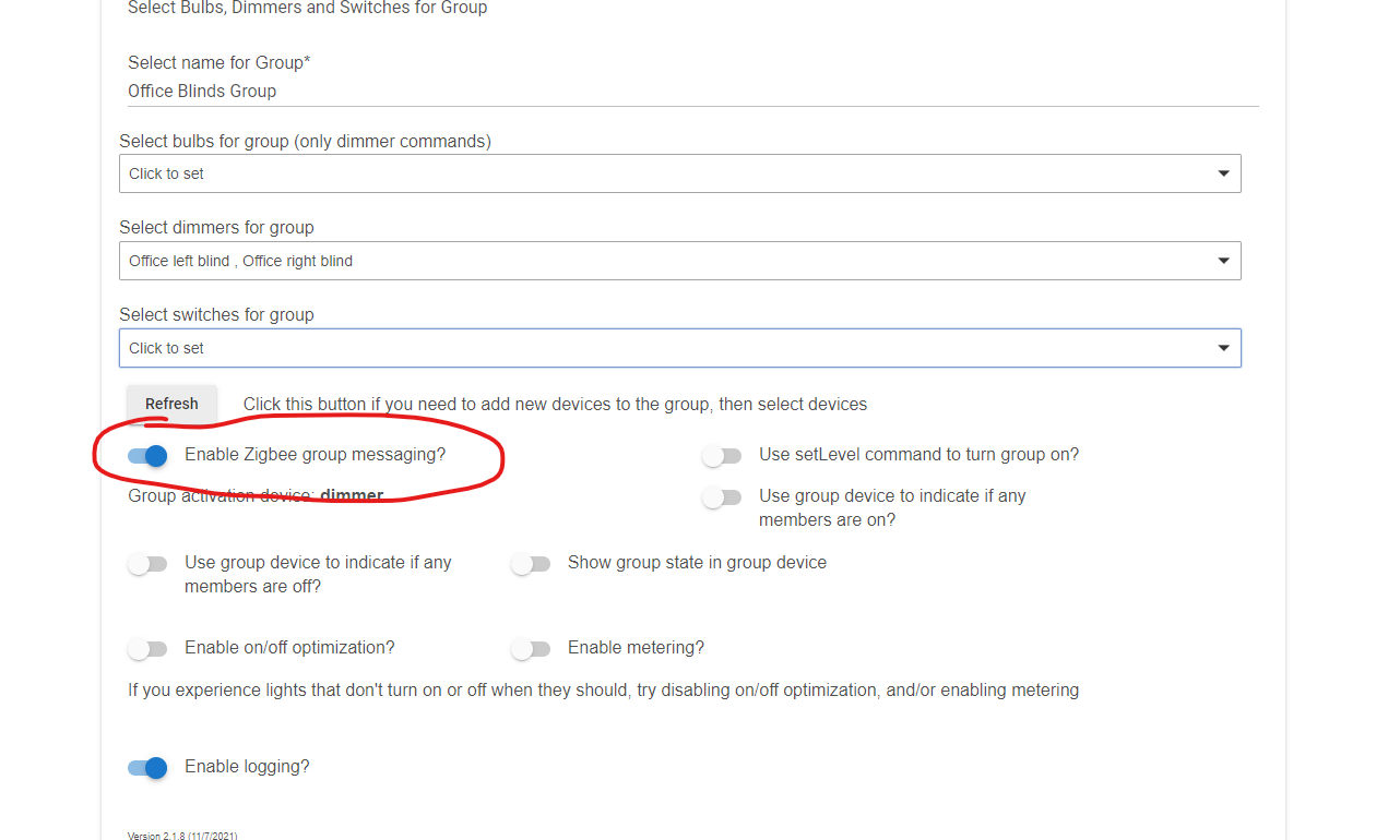

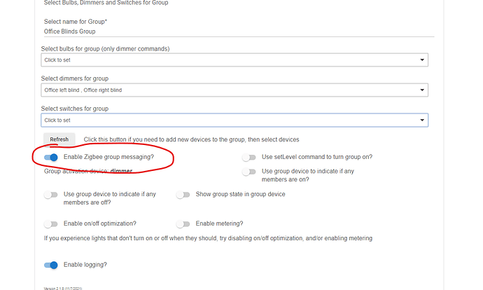

Has anyone successfully set up a group that uses the zigbee group messaging?
I was hoping to create one group for all 15 of my blinds and utilize zigbee group messaging like I'm able to with other zigbee devices ( one single command instead of flooding the network with commands to all of them individually as far as I understand it). With the group messaging checked, the blinds don't respond to the group. When I uncheck it, they do respond, but lnot to a group message. Is this a limitation of the device firmware or something?
Would sound like it. It's designed for lamps and switches rather than blinds so it may be a case that blind group messages use a different command or does not have that ability.
