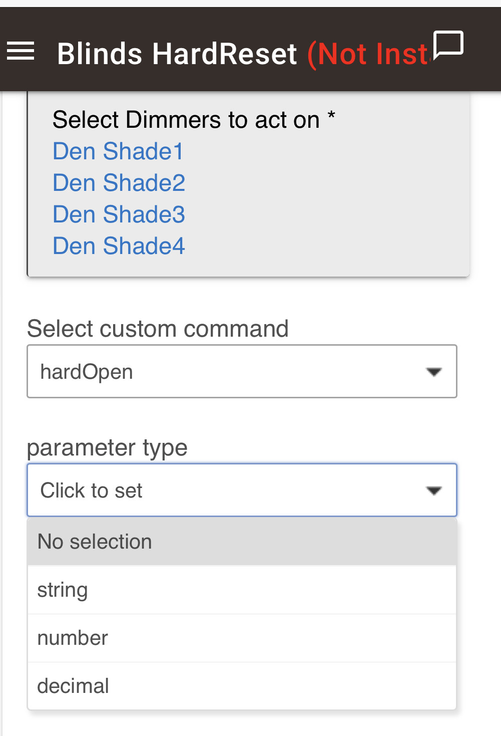

Thanks. About actuating the custom command, what parameter should be passed. 0-1 didn’t work.
Thanks again.
There is no parameter
Ok. Am I doing this wrong?
Looks like you are doing it right. You don't even need to click on parameter type.

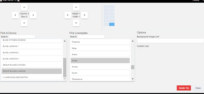

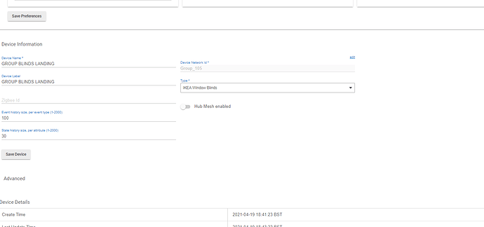

Hi, i have a number of these blinds and they work great with the @a4refillpad driver. However, my inexperience is getting the better of me. I have bunched the blinds into groups but cant seem to get the groups working from my group dashboard tile.
So i've given the group device the Ikea driver and then i've set my group tile as a shade? however when i alter the tile position of the group tile, the blinds won't move.
I know this is simple but what trick am i missing guys?
Ignore this guys, my brain fart is over. Ive set the driver to be a dimmer and also tile to be a dimmer. I think i'm getting a bit dimmer too :thinking: :thinking:
