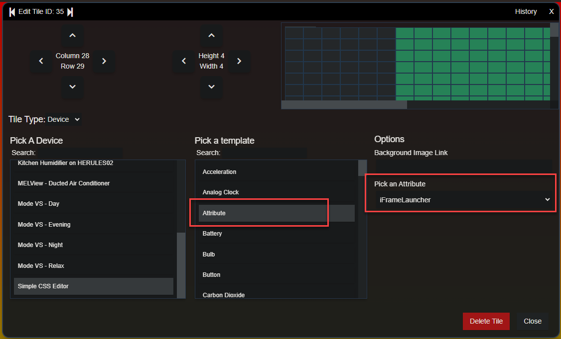

What tile Template should be used with iFrame Advanced?
You need to use the Attribute template, which will allow you to select the attribute that contains the iFrame.

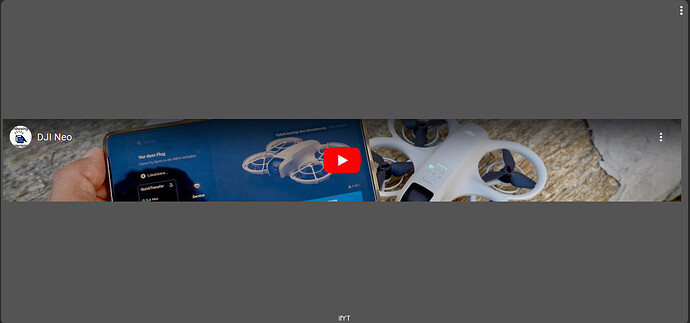

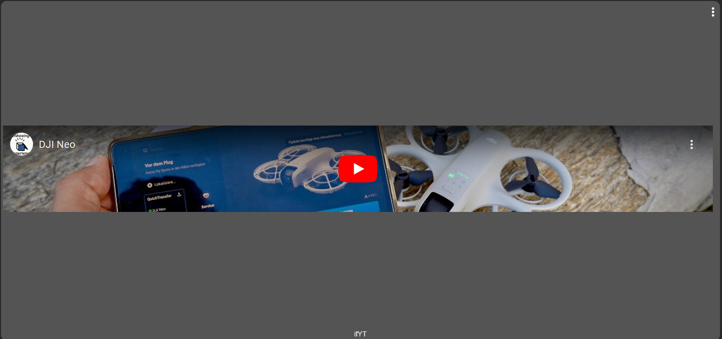

Hi everyone:
How to fill up the entire tile with the iframesource ?
Thanks ahead !
Can you show or describe some of your settings for the iFrame device in HE?
What have you set the following Preferences on the Device Details page:
  • "Width of iFrame..."
  • "Height of iFrame..."
  • "Style applied to modal...."
I expect you need to set the Width and Height to their defaults of 100, but the more likely fix will be in the Style setting. If you can provide another example URL we could test some similar setup. My guess it is any YouTube clip, but if you could find some other URL than your own, we can test different options in more detail.
My iFrame device settings are as follows:
Width of iFrame: 100
Height of iFrame: 100
Style applied to modal: position:fixed;top:0;left:0;width:100%;height:100%;background-color:rgba(0,0,0,.85);

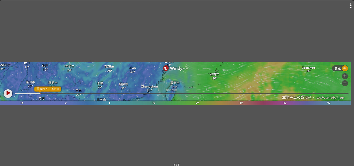

Yes, the URL I’m using is a YouTube clip, but I’ve also tried with a Windy page, and both yield the same result.
YouTube link: YouTube
Windy link: Windy: Wind map & weather forecast
Thanks!
