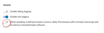

Then, trying to set the settings, I got an error saying I needed to fill out all the required fields.
It REQUIRES at least ONE Beta package to be selected. And, I really do not want one selected.
Thoughts?
Thanks!

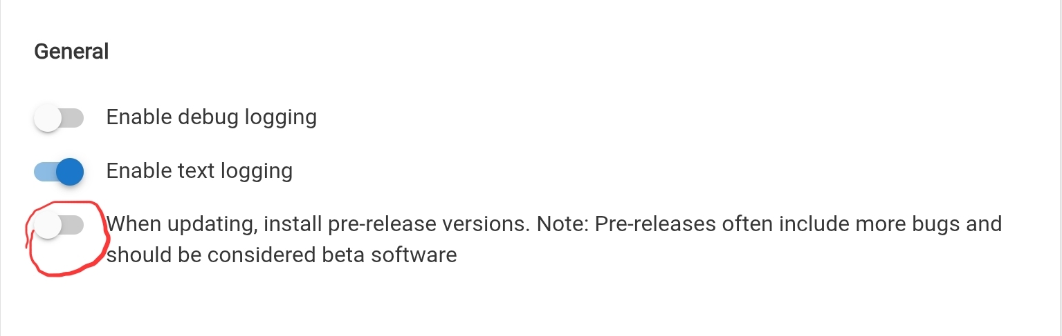

Did you turn off this toggle?
Mine was apparently on by default. But I did not have to pick any beta's either
You should only get that message if you have the option to install betas turned in but none selected to install.
If you dont want any betas, turn it off and that message should go away.
That changes was made in 1.9.8. It was to allow better control over what beta packages are installed. Before, once you turned in the beta switch, everything if enanled, would inatall the beta packages. That could be a problem if several of the softeare packages you used had beta options but you only wanted one.

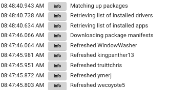

Current method:
16:51s
08:51:27.807 AM info  Matching up packages
08:51:11.297 AM debug Performing Package Matching

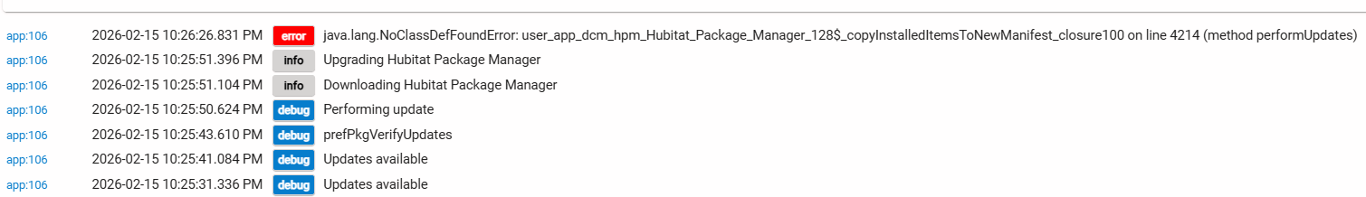

error trying to update : v1.9.9 Just Hung.
java.lang.NoClassDefFoundError: user_app_dcm_hpm_Hubitat_Package_Manager_128$_copyInstalledItemsToNewManifest_closure100 on line 4214 (method performUpdates)
Upgrading Hubitat Package Manager
However after I moved away it shows this .. Updating HPM version to 1.9.9 from previous upgrade
That's the classic "random code where the old code used to be" issue. v1.9.9 has one of the most likely methods moved to the top, so it doesn't move version to version. Future changes are likely to be in the 4500 lines of code AFTER the relocated method. :smiley: Most likely :smiley:
We'll have to see with the next version of HPM when the two methods will be in the same place.
