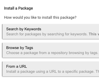

HPM has, and always had, 3 search mechanisms.
Screenshot 2026-02-16 at 6.01.25 AM
Only the first one uses an external tool. Originally, it was Azure only. I thought it was rather slow, given other search experience we all have. I added Fast Search, doubling the external tools, back in May of 2022. Certainly Developers can offer instructions via either of the two BUT "just search for: <word>" does feel a bit more straightforward. :smiley:
Wouldn't tags be a similar solution?
similar to which discussion point?? :smiley:
'by Tags' doesn't use an external tool and neither does 'from URL'

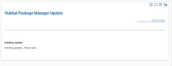

This thread is gigantic. Will take me forever to read. Can someone TLDR it for me and tell me if I need to do anything about this?
Click on the Home button:
Screenshot 2026-02-17 at 6.49.11 AM
Then go back into HPM, you'll probably see the version is correct:
Screenshot 2026-02-17 at 6.49.32 AM

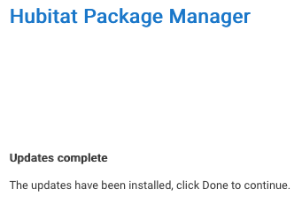

When HPM is done upgrading ANY package, it wants to end by displaying this screen:
Screenshot 2026-02-17 at 7.47.24 AM
But, because the upgrade involved HPM itself, the code for that page has probably moved. This v1.9.9 has moved some code to the TOP, and future code changes are likely to be further down in the 4100 lines that are HPM. Ideally, that means the NEXT version of HPM will have the before and after code in the same spot. I wish all of us good luck with that :smiley:
