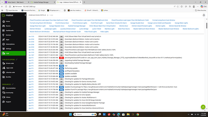

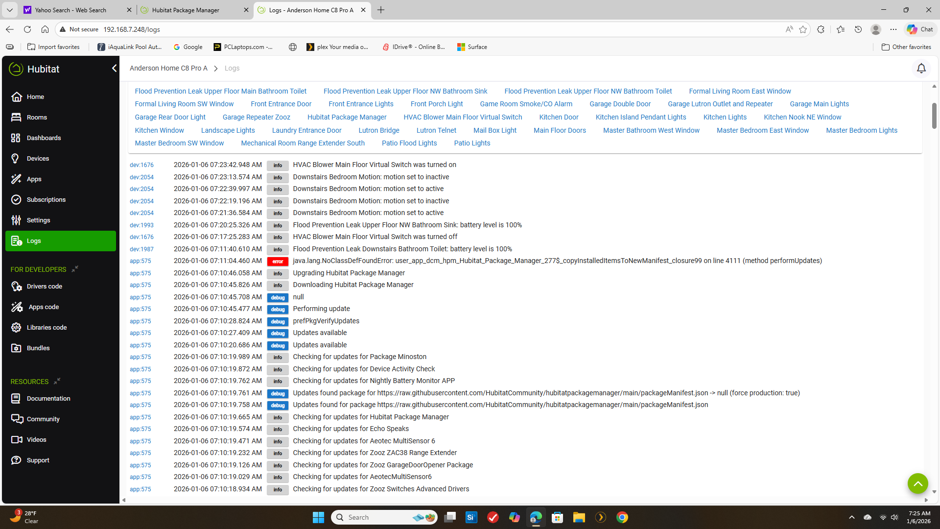

The update 1.9.6 seems to have an issue, I have two C8 Pro Hubs and for both of them, the Update would not complete and return back.
Have I done something wrong or does this update need a tweak?
I have attached my logs.
I just waited a few minutes and reopened it and it was 196.
Yes.... I did the same thing. However, the update seems to have a bug. It should reach "Complete" after finishing the update rather than just getting stuck with the phrase "Updating".
HPM updating itself means that the code for the return to Complete is NOT where it was. It does the return to Complete, trying to go back to where the code was in the old version. But the new version is bigger (or smaller) and thus the return goes to the wrong place and appears to hang. But an error is thrown and HPM quits. Simply open HPM again and notice the correct version in the upper right. To ease your mind, running a Repair on HPM will install the new version on top of the new version and it will Complete, without error :smiley:
app:2550 2026-01-06 07:19:39.795 AM error java.lang.NoClassDefFoundError: user_app_dcm_hpm_Hubitat_Package_Manager_1384$_copyInstalledItemsToNewManifest_closure99 on line 4097 (method performUpdates)
app:2550 2026-01-06 07:19:21.451 AM info  Upgrading Hubitat Package Manager
app:2550 2026-01-06 07:19:21.113 AM info  Downloading Hubitat Package Manager
Using the error shown as an example, the return to Complete WAS at line 4097 but in the new code it's well after line 4100. Your line numbers may vary :smiley:
