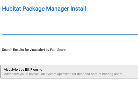

I haven't clicked Install, but it's at least showing up in HPM. :smiley:
Are you going to create a release topic on this (I couldn't find one), sounds very interesting!
I will .. I am still running into issue trying to get it to set up on HPM so I want to get HPM issue resolved before I post about this app.
I tried installing it from HPM from search and also tried from a URL both give this message
Error Occurred During Installation
An error occurred while installing the package: Failed to install app https://raw.githubusercontent.com/TechBill/visualalert/master/VisualAlertChild.groovy. Please notify the package developer.. Be sure the package is not in use with devices.
The path to child is correct so I assume there have to be a code/logic in child that I am missing for HPM or something
Any idea what I do wrong this time?
At least I got it to show up in HPM menu.

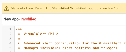

The best debuging mechanism for developers is to manually install the code manually and verify that the HUB accepts the code. In this case:
Screenshot 2025-04-11 at 11.18.07 AM
Which is caused by Namespace confusion:
Screenshot 2025-04-11 at 11.21.49 AM
The child is looking for "VisualAlert:VisualAlert" but the parent code is "TechBill:VisualAlert"
Fixup the child code and it will probably compile.
Screenshot 2025-04-11 at 11.26.23 AM
Resulting in:
That did the trick!
Thank you for you help!

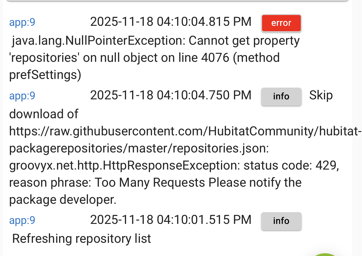

I've jusy tried to get into HPM and I'm getting the following error on my C7 and C8 hubs.
[app:51](http://192.168.0.23/logs#)2025-11-18 21:04:15.098 error java.lang.NullPointerException: Cannot get property 'repositories' on null object on line 4076 (method prefSettings)
[app:51](http://192.168.0.23/logs#)2025-11-18 21:04:14.966 info Skip download of https://raw.githubusercontent.com/HubitatCommunity/hubitat-packagerepositories/master/repositories.json: groovyx.net.http.HttpResponseException: status code: 404, reason phrase: Not Found Please notify the package developer.
My hubs build is 2.4.3.158.
I've tried a reboot with db rebuild with no success.
Anyone else on the latest build getting this?
Tagging @csteele for info.
Yup, same here.
