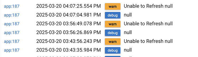

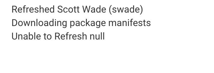

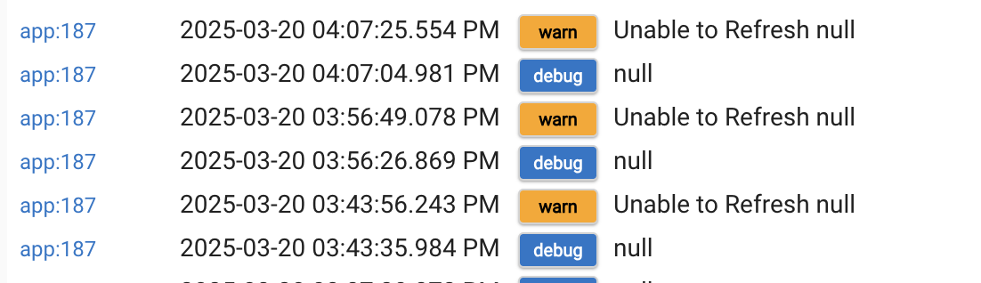

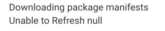

I am doing an HPM Matchup and getting the following:
What is the most efficient method in trying to figure out which repository is causing the issue, instead of trial and error? Or is there another cause of this error?
I just tried Matchup twice and they both worked. No "Unable to Refresh" but did get more names after mine each time and they changed.
Try it again and see if your run just happed to be while some repository was getting changed (Just me guessing)

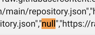

From what I can tell, a "null" got injected into the master repo apparently.
You can detect it by clicking on the Info button, top right. (circle with I)
Screenshot 2025-03-21 at 7.11.46 AM
If you use your browser's search for null, you might get a match:
Screenshot 2025-03-21 at 7.13.01 AM

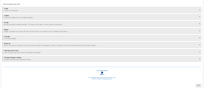

I believe you can remove that with a simple (but odd) recipe:

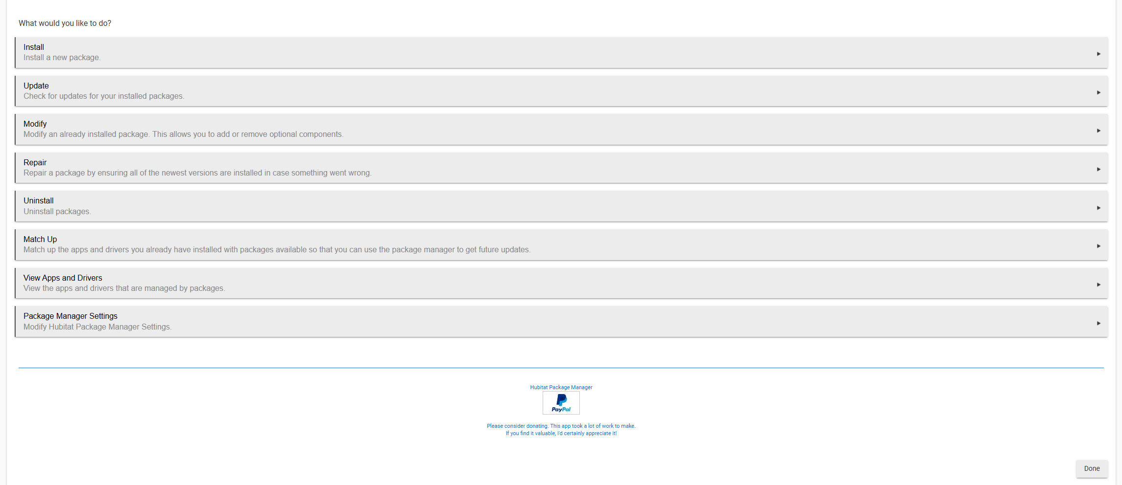

Go to Package Manager Settings and scroll down to Available Repositories:
Screenshot 2025-03-21 at 7.15.21 AM
Click Add a Custom Repository and a URL field will become available. Type "test" into that field and click Next. An error will be displayed, saying your URL is invalid (expected) and that should cause the null to be removed.

I did the "add repository", but had trouble completing the match. A few times of opening HPM, adding repository, and closing the app eventually got everything working correctly. Thank you!
Maybe I wasn't clear :smiley:
Add Repository is a step that is intended to fail. :+1:
What it does is force a "rebuild" causing the null to be dropped. The null is in there, and just zooming through the process of trying to add a repo, causes it to be rebuilt. You don't need another repository, they are already all there. This 'recipe' just takes advantage of the fact that the table gets rebuilt, and drops nulls. Coincidence really. :slight_smile:

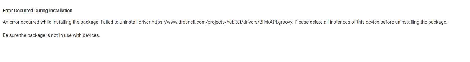

I am not sure if this is a Blink Integration issue or an HPM issue.
I cannot get Blink to go away since I don't use those cameras anymore. I have had this problem for a long time and finally at point I want it to go away.
I get this error message when I try to uninstall:
However, I don't have any devices using a Blink Driver and even manually deleted any of the Blink Drivers code.
I have tried Repair then delete and still won't get rid of it.
Any suggestions? Although it doesn't affect performance, it bugs me and I get update messages for HPM that refer to Blink.
In HPM go to settings, then UnMatch at the bottom.
Then you can delete the code manually from the app/device code lists.
Where is Unmatch?
In the "Package Manger Settings" at the bottom of that page.
Found it! Sorry. Brain fart.

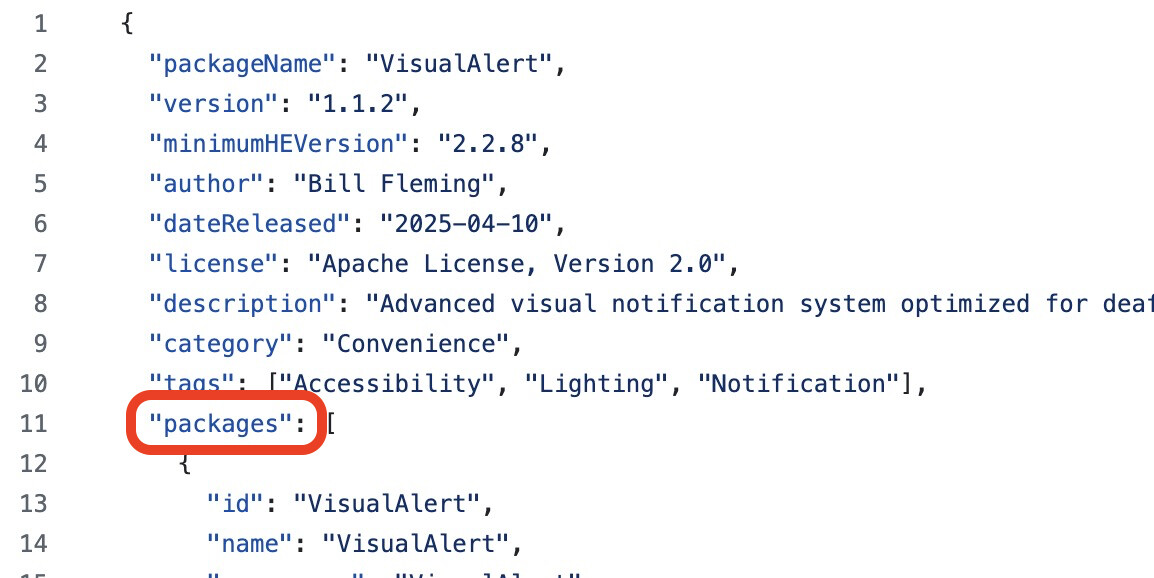

I wrote an app and I am trying to add it to HPM so I tested it using install "From a URL" but it kept giving me a You are about to install null
Once I had it working then it stopped again so I checked my manifest.json but I can't seem to find the mistake ..
Can you help and point it out to me?
This is my first app so I am like ultra newbie to this ..
Bill
When I view the manifest file on github link, it displays "packages" on line 11?
Line 11 should be "apps".
