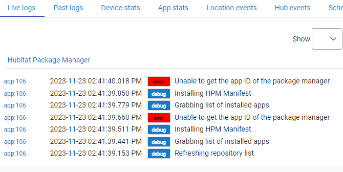

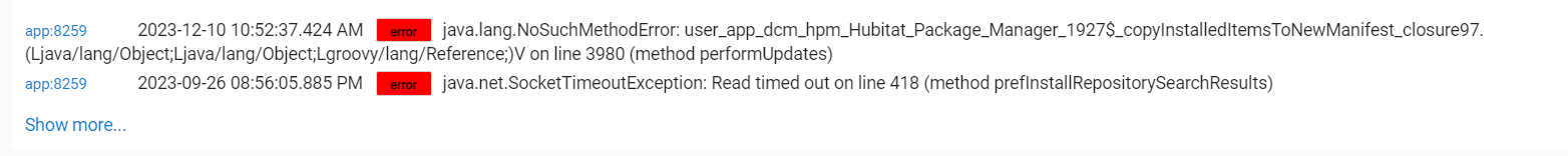

Sorry .. is this normal ? Get this every time I enter it from the APPS tab.
Have you read this Topic yet?
If you upgraded to platform v2.3.6++ before upgrading HPM to v1.9.0 then there is an issue. That Topic also covers how to recover.

Is your problem resolved? Did the Recovery method help you?
Thank you very much for your response. I really appreciate it. As newbies don't always understand how all this stuff works. And all we see is errors in the logs. That we know aren't supposed to be there. HB is a very robust. Very complicated. System for the general user. I came from an X10. Era. And many of the things that you need to do in HB. Are amazingly. Not as easy. However, it has the flexibility. To do a million things other systems can't do. If you can figure out how to make it do it, lol.
Sometimes it's hard to read through 550 comments. Worse. Look at the very top topic. When it automatically brings you to the bottom. Very much appreciated.
All, I was saying. Is that sometimes it's easier to give a simple answer. To a simpleton like me.
And yes with your help .. I was able to fix the problem. I'm not sure if I did it correctly,
I went to " Bundles" and used import zip and basically just reinstalled it. and now the errors are gone :slight_smile: thank you very much for your help. And I appreciate Everyone here at HB !

The errors being gone is great... but there's also the element of Duplicate Apps in that 'recipe' for recovering. Having duplicates will cause a problem 'tomorrow' and none of us want that.

The problem arises when you are using Platform v2.3.6 and try and click Update in pre-v1.9.0 HPM and select an App. HPM will try and get a list of the Apps installed to find the correct app number to update. It won't find one on platform v2.3.6, and will import another copy. If you never attempted an App Update with the pre-v1.9.0 HPM, then you would not have gotten duplicates.

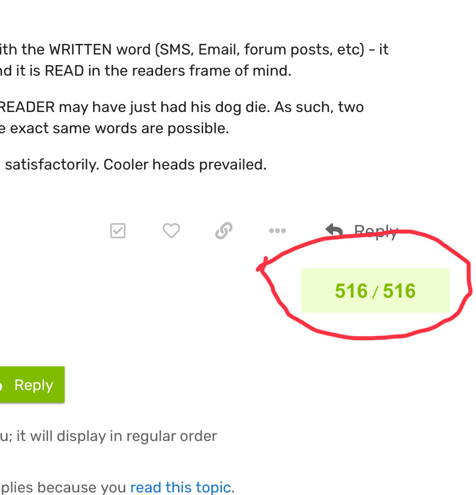

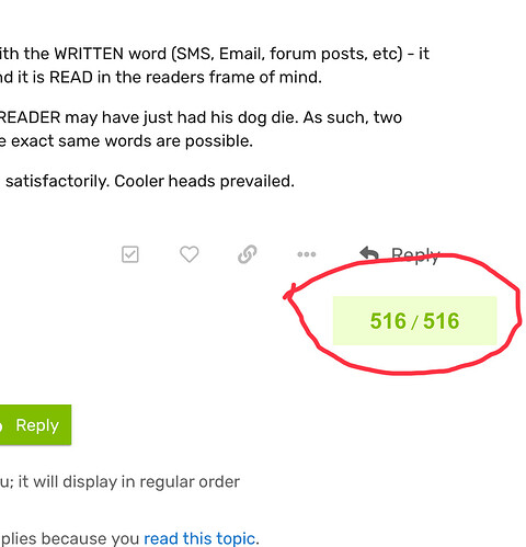

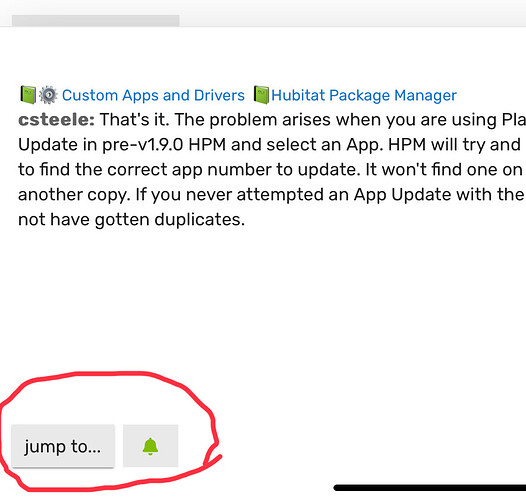

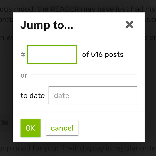

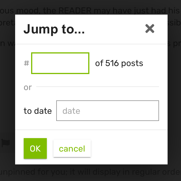

I took me a while to find this a the beginning:
CLICK IN RED CIRCLED AREAS TO NAVIGATE THREAD.

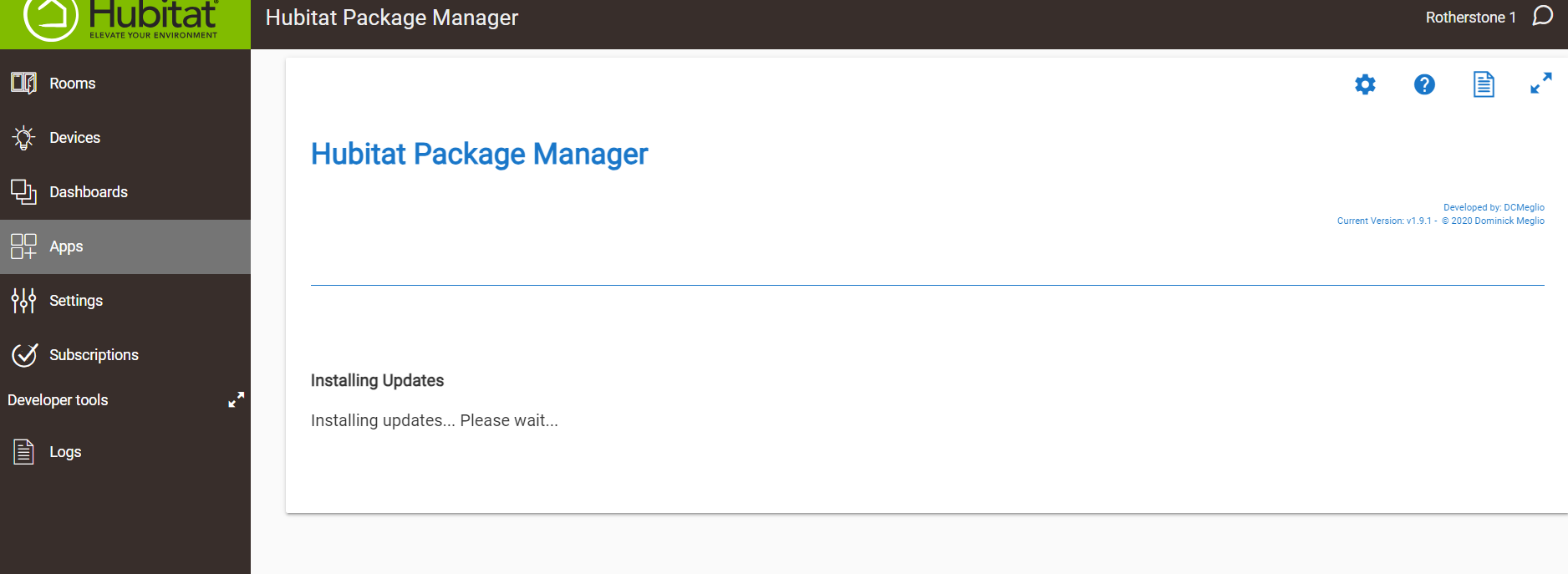

Released v1.9.1
seems to be hanging on the beta
I'm not on the beta, and it hung on one of my hubs. But when I just reloaded the app 10 minutes later, it had updated to 1.9.1.
