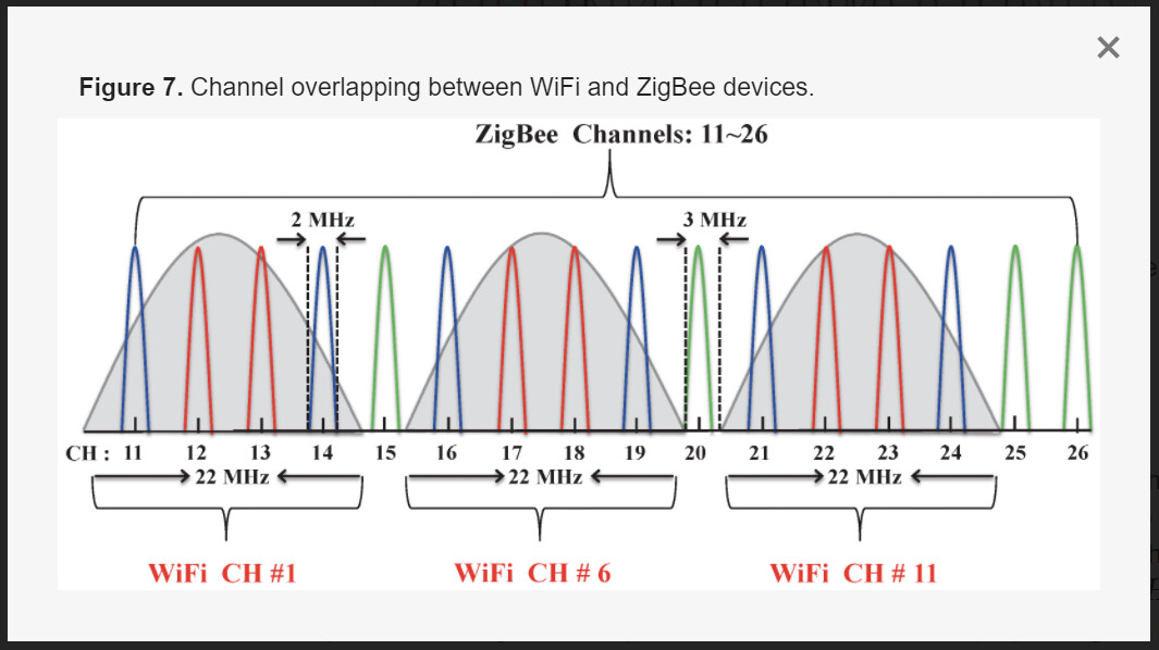

The Hue lamp is a Zigbee device that operates at 2.4GHz. If your Hue Zigbee network is using a Zigbee channel that conflicts with your current 2.4GHz WiFi channel, than that might explain what you've seen. Assuming your Hue lights are attached to a Hue bridge, the bridge will use channel 15, 20, or 25 (IIRC). If you also have a Hubitat Zigbee network, then you should choose a channel for it that does not conflict with your Hue Zigbee network. I would try to run the Hubitat Hub Zigbee network on channels 15 or 20, as channels 25+26 can have issues with some older Zigbee devices. For your WiFi network, make sure that your 2.4GHz network is set to only use WiFi channels 1, 6, and/or 11, at 20MHz channel width.

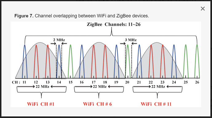

Here is a visual chart of how Zigbee and 2.4GHz WiFi overlap. I run my Hue Zigbee network on channel 25, my Hubitat Zigbee network on channel 20, and my 2.4 GHz WiFi access points on channels 1, 6, and 11. This has worked without any issues for years.
Yep, I have been dealing with 2,4ghz interference earlier and I'm trying to minimize use of that frequency. Only Hue and few devices (for example arduinos) use that and all other are behind z wave or 5ghz wifi. It could be that certain device could be messed up if channels are overlapping. That been said as I'm using combination of Google Wifi, Hue bridges and Ikea bulbs. Hue channel can't be easily changed because of Ikea bulbs and Google wifi does not allow channel changing at all... so smart home environment here is sort of a compromise of...well all these smart stuff and systems that I have..

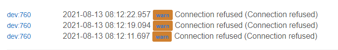

Ok so morning I noticed that board did not work and this is the new board I'm talking about.
Log says:
Same "connection refused" log lines as with the different board before.
Tried to telnet 8090 and it was listening. Then tested to open and close servo again from Hubitat and it started to work. So basically I have same issue with new board but this time board came back alive for some reason. I can't figure anything else than power issue. Next I'm going to unplug devices behind same outlet and see if that helps.
