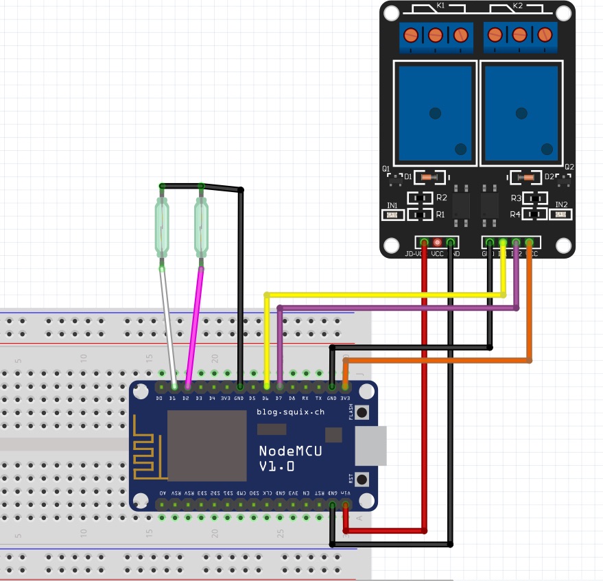

How do you have the relay wired? Here is how I would recommend wiring it (ignore the two reed switches in this diagram.)
You could also power the relay coils (lower black/red pair of wires) from a separate power supply.
Thanks I appreciate this lies outside this topic. I think thats how I have it. Well similar anyway but my relay only has the vcc input but supposedly has an optocoupler.

I have the 3.3V pin from the wemos mini connected to the relay to power the coils on vcc. And switching with the digital out directly to the in of the relay..
I would use the 5v pin for poweting but I had challenges soldering to it... So used the 3.3V pin. Both voltages are ok for the specs of the relay and it switches with 2.5V.. But I have heard that the 3.3V from some clone wemos use a small regulator so perhaps the voltage of supply is dropping.. But then again I would think the digital state would change before rebooting (due to power requirements from the relay) before the reset? So that theory may not be right
In saying all this.. It seems that hubduino is not the cause here so maybe I should go and do some debugging/effort.. I'll report back.
how are you powering the board? through usb? or through external 5V? an external 5V might be needed in this case to power the board and relay. i'm using a 3.3v relay in my smart dog bowl and it works no issues (i'm using an external 5v power supply)
