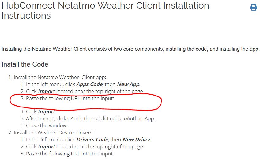

Uh, the URL is missing from the Installation Instructions:
I tried both Firefox and Edge. Please advise.
Thx
https://hubconnect.to/download/category/5/HubConnect-Netatmo-Weather-Client.html
The HubConnect.to site works via unique URLs for each user, therefore a common link in the documentation isn't possible.
99.9% of the world has never heard of HubConnect.to and even fewer know how it works...
May I suggest modifying the instructions to something like:
- Visit https://hubconnect.to and create an account
- Copy the URL from the bottom of the 'Files' section at the HubConnect-Netatmo-Weather-Client page.
- In the Hubitat UI the left menu, click Apps Code, then New App.
- Click Import located near the top-right of the page.
- Paste the URL you copied from the HubConnect-Netatmo-Weather-Client page into the input.
- Click Import
- Click Save
- After import, click oAuth, then click Enable oAuth in App.
Also, do I use the same URL for both the Client app & Device driver Imports?
"Repeat steps 2-1 to 2-4 for the remaining drivers." Huh? What remaining drivers? I'm lost.
I have just had the client app installed and set up. All seems to be working except that only 1 of my 3 additional modules was detected by the app. Did anyone encounter such issue before or any idea what have I done wrong here?
Is this still supported? Also, did the 24hr clock problem some people reported ever get solved?
Agreed, this makes no sense to me either!
EDIT: I figured it out, on the page with the App URL, click on the "Netatmo Weather Client Drivers" link and then there is a URL for each Driver you need.
