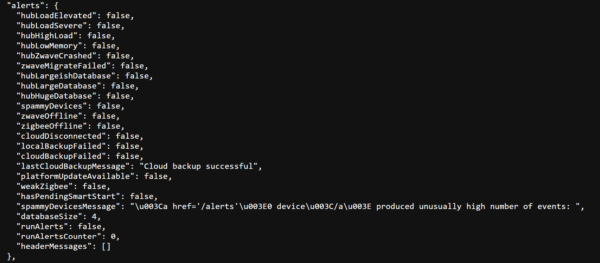

If you manually run http://<HubIPaddress>/hub2/hubData what does the alerts data item look like?
Thanks for that..
Here is the Hub Data
With Debug logging on there were no errors.
Should be working then. Let's try doing a Repair from HPM, and the go into the device and hit Refresh. Should see the hub uptime change if nothing else, but when that changes the alerts table should clear also.

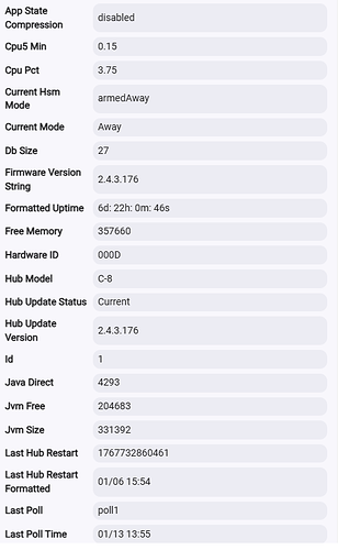

Just wanted report back on this, the driver still refuses to update the Hub Alert. Repaired via HPM, tried rebooting the hub, and still a no go. What's strange is I have a C-7 at a different location that is having the same issue. Both hubs do show "Current" via Hub Update status. It's not a big deal, I just wanted to be able to see Hub Alerts remotely.

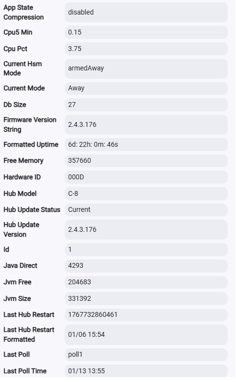

I changed the code and still no update. I shortened the poll time and it ran twice. I know the UI updates because the alert was there before my last update, and gone after. I wonder if anyone else has noticed this. Just weird that it would be happening on both of my hubs, different model hubs at different locations.

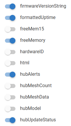

I just came in here to check for a hub alerts issue. I cannot get hub alerts at all. Que 1 is set to poll every 10 minutes. Hub Alerts does not even appear in the attributes list. On firmware 2.4.3.176. I've updated and repaired via HPM and tried the suggestions. Running the endpoint returns the same "alerts" list. No error messages in the logs.
Alertchecked
Hubalert
Edit: Just saw your post above mine. Will try and post back.
@CAZ Where are you seeing those slide switches in your top image? I've never seen those toggles.
Those are from the app and actually not relevant to the issue. It wasn't showing in the app so I wanted to illustrate but as mentioned not actually relevant. The issue for me is the attribute is not there.
