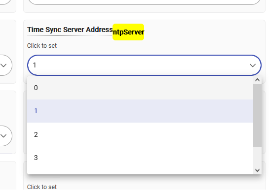

Regarding NTP server field - it is a drop down for me, 0-4.
How/where do I enter my NTP server name (or IP?) I happen to run this service in my Net and would love to get the HE hub involved.
thanks.
/hub/advanced/ntpServer
Just noticed you told me to turn on Suppress Warn Log, duh.
Off now.

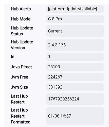

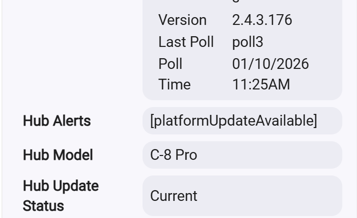

Hello @thebearmay, Has anything changed recently with either your code or one the recent hub updates? I'm using the "Hub Alerts" attribute on a tile on one of my dashboards and after the latest update, it's still showing"[platformUpdateAvailable]."
It's also not updating on the device page

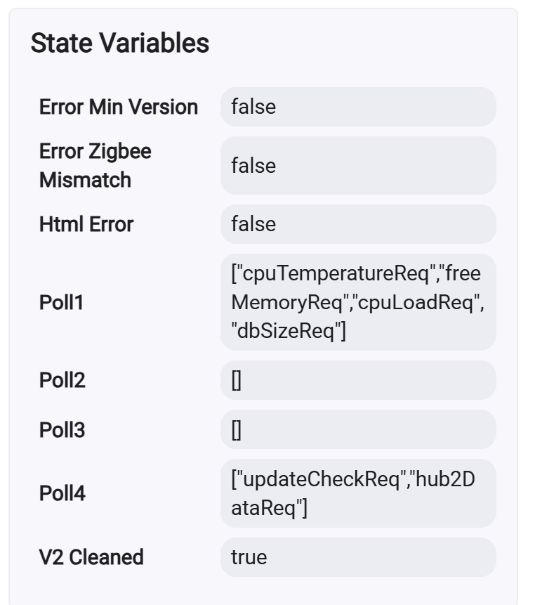

When I look at the "State Variables" for Poll 4, the "hubAlerts" attribute is not listed like the others that I have set to poll.

To answer the State Variables question, Hub Alerts is included within the "hub2DataReq" entry in your Poll 4.
Sounds like the polls aren't running, might try clicking the Initialize command and see if that restarts them. Might also watch to see if the driver generates any errors.
Thank you for that, I thought it may have been it's own attribute.
The initialize command did run after the update and I've tried that a couple times as well. I'm not seeing any errors in the logs and my Poll 1 is running and updating as expected. I do see both Polls under the "Scheduled Jobs" section as well.
I'll try adding those attributes to Poll 3 and eliminating Poll 4 to see if that brings it back to life for some reason. I have not used Polls 2 and 3 for a long time.
Thanks for your replies, I'll report back after my test.

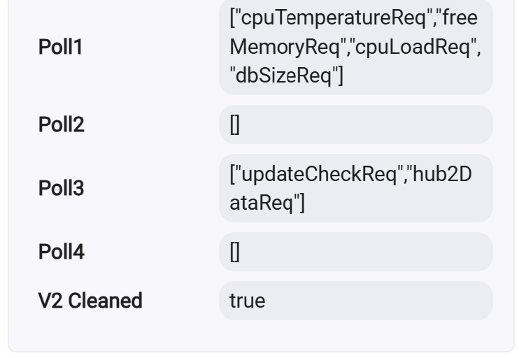

Well, I made the above changes and set Poll3 to run every 30 min. Based on the driver, Poll3 ran, and it still didn't update. I guess I'll turn on Debug logging and see if anything shows up. Strange to say the least.
Thanks!
Wow! Don't know how those images got so large that time lol... Did the sam as the last post.
I think he said poll 4
