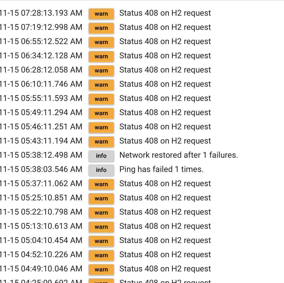

and it threw this log
dev:12282025-11-14 16:07:46.762warnStatus 408 on H2 request

I’m trying to duplicate, but for the moment turn on the Suppress Warn Level Logging switch in the preferences.

I may have fixed the 408 issue on the H2 data read. v3.1.21 is up
