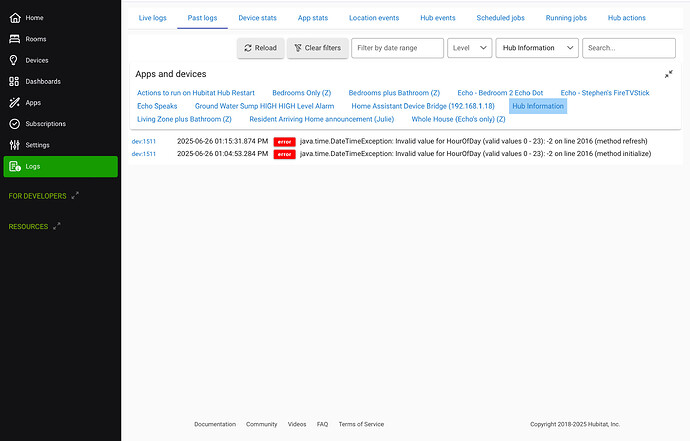

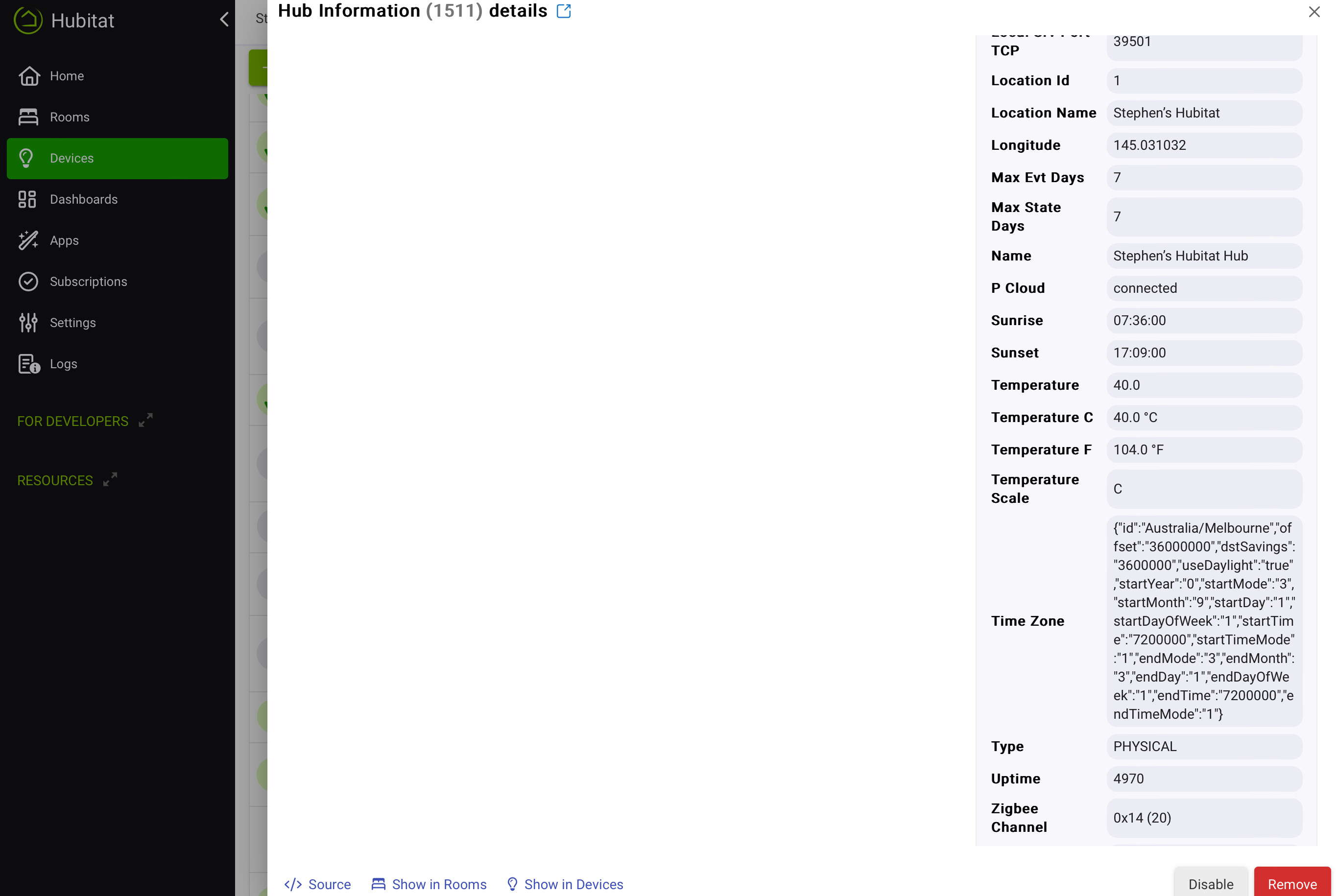

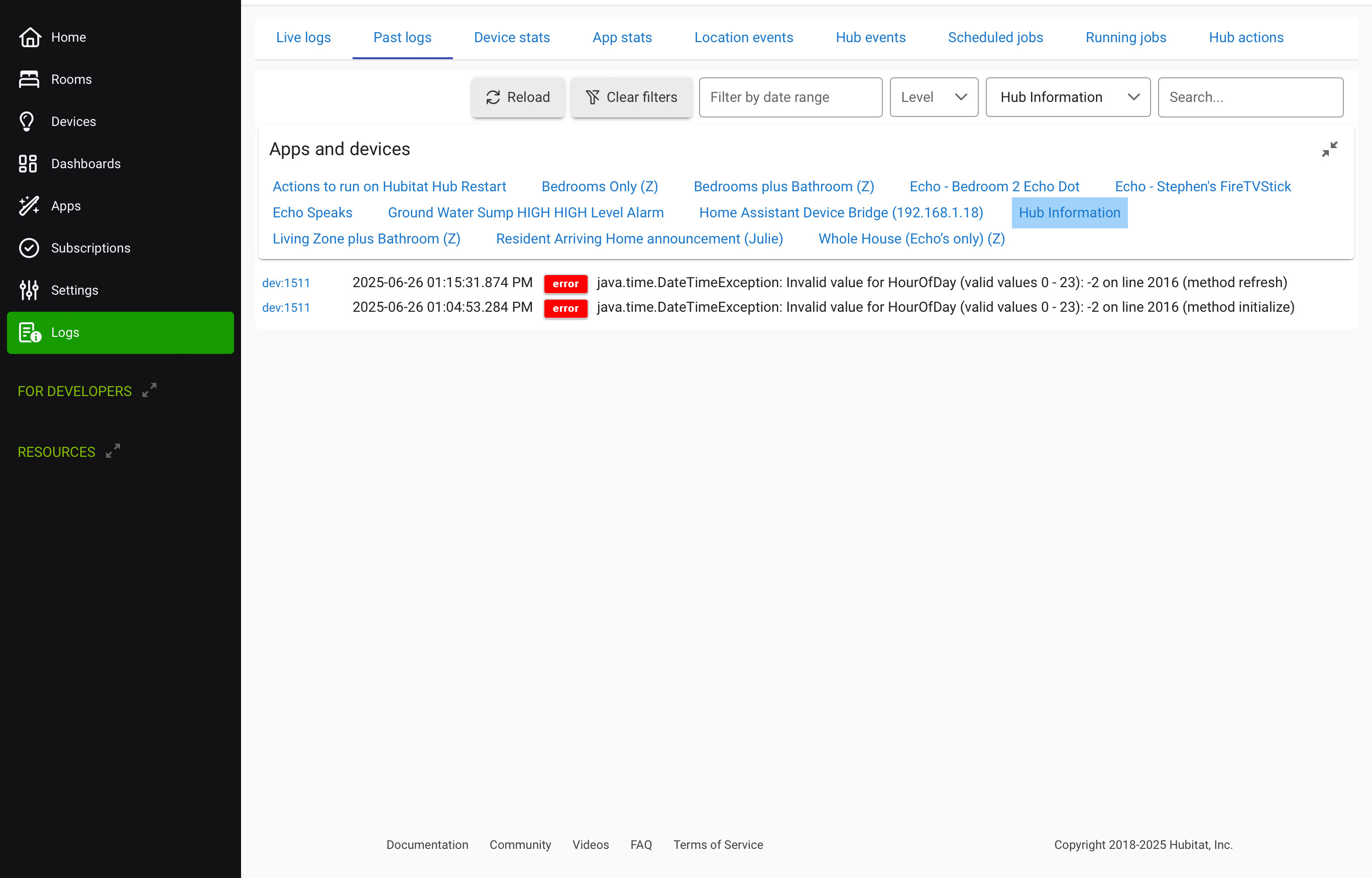

Updated my Hub Information V3 to the latest version via HSM and started seeing these errors in the logs. Looks like the html data on my dashboard has stopped updating as well. Where should I start looking for my problems?
Can’t duplicate, but what is the current sunrise at your location?
I’m in Melbourne Australia. Current sunrise is 7:37am local time
I notice that the “useDaylight” is true but we are in winter time here. Could that be causing the issue?
I’m not looking at that but thanks for reminding me about it being winter there (last couple of days here have had a heat index of about 40°C).

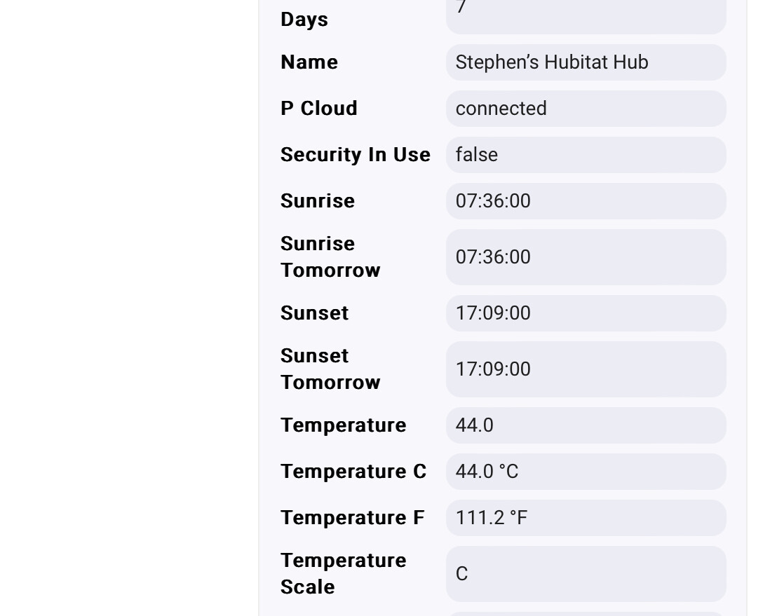

Save the change, and then go to the Hub Info device and hit refresh. Should eliminate the error, but need to know what the sunriseTomorrow value is refreshed to.

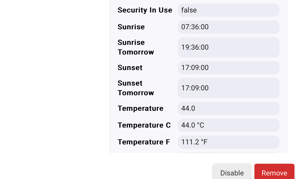

Well, it’s a value, but off by about 12 hours… can you change the 12 in the if statement to 24 and retry?
