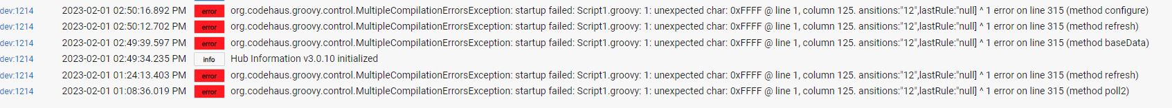

I have poll rates of 5, 15, 30 min and 1 hour. I have hit configure, initialize and refresh.
Now I turned on debugging and I see errors:

US/Arizona why would that impact it showing the correct firmware? The date and time and last restart date and time are correct. Up Time is correct. The free memory does change it's just the firmware version that is not pulling correctly. At least for what I look at that's all that I see that's off.
The line number it is erroring oout on (and stopping the version from updating) is the one that does the formatting of the time zone. I’ll put an error trap around the code, but was curious as to why there is an issue.

Thanks. That will help me figure out why that one doesn't work, and the rest of the data should populate correctly. Thinking that it may be the fact that AZ doesn’t change , i.e. the Last Rule = null.
