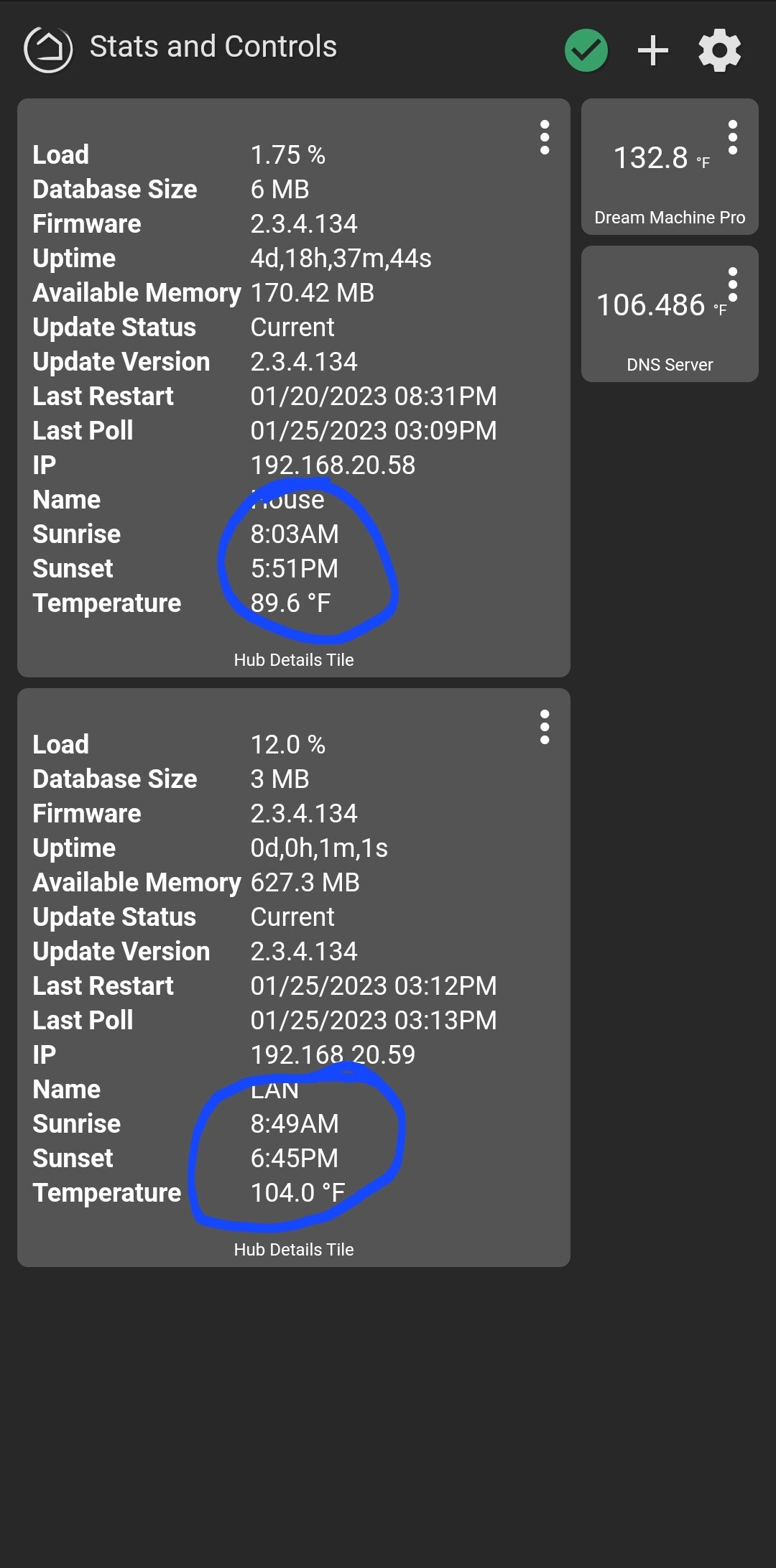

Think I should post in get help about this? I confirmed that it is accurate to what is in hub settings.
Locale, gmt and lat/long are correct?

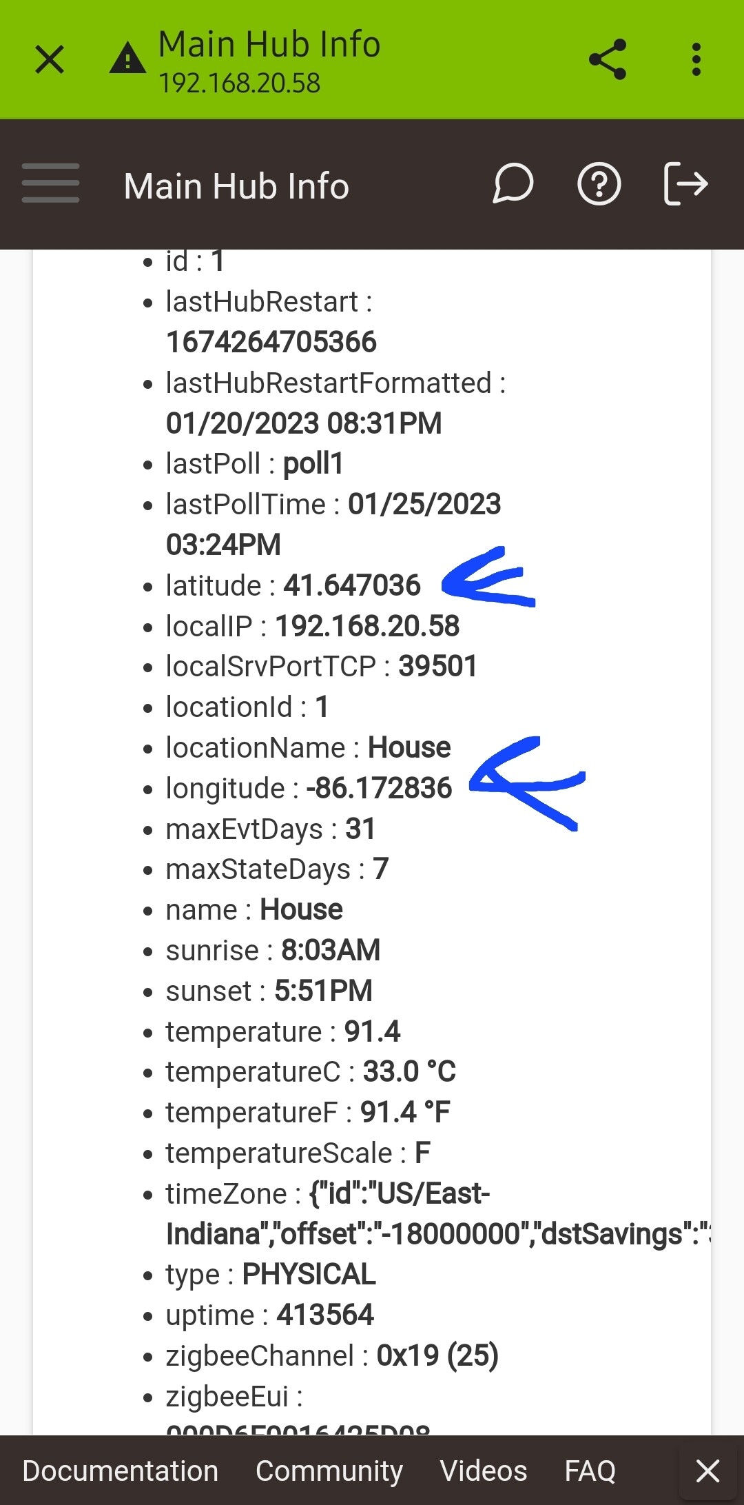

Might check the lat/long in Hub Details to see if they are correct.

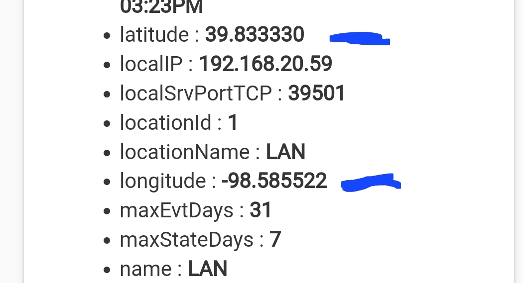

THEY'RE DIFFERENT! but how?
Normally set by the zip/postal code, but you can override them individually.
Well damn. Postal code for second hub is blank!

That's strange I changed zip and rebooted and they are still wrong.
Actually...IP really can only get you so far since they're protected behind the ISP. They narrow down to city/state and provider, but not much past that....at least not from a google search.
Lat/Long on the other hand...one google search and I'm looking at your front porch. A quick search of the address and I've got the full name of the owner.
Do that then get your lat/lon copy pasted from your other hub then hit save
I didn't realize that it was editable at first but that's what I did and it's all good now.
