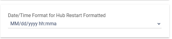

No matter what I change this to
I still get this format
Is this a bug
Sure looks like it.... Let me check the code.
A thought, have you restarted the hub since you set the new format? The attribute only gets set during initialization which normally occurs when you reboot the hub. If you haven't restarted since then, you can force an update by clicking the Initialize button on the driver page.
