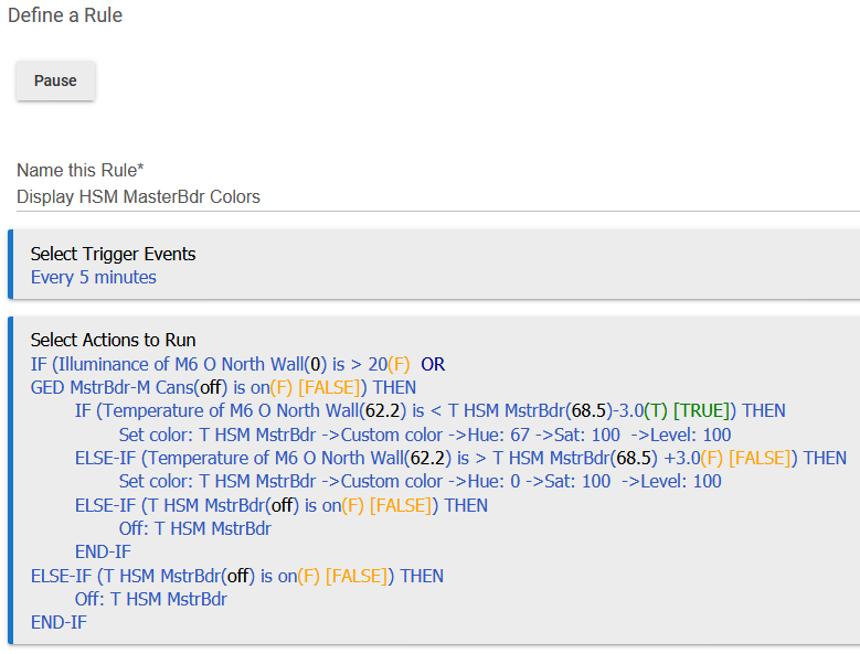

Also, I don't know if this will be of any help, but below is the image of a rule I have in Rule 4, that does the following:
If there is some light outside or the overhead bedroom light is on, then if the outside temperature is more than 3 degrees warmer than this sensor turn the light red, if the outside temperature is more than 3 degrees colder than this sensor turn the light blue, otherwise turn off.
The commands in the rule work perfectly with the driver to set the light exactly as described.
