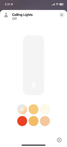

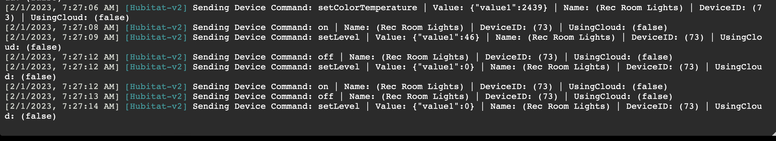

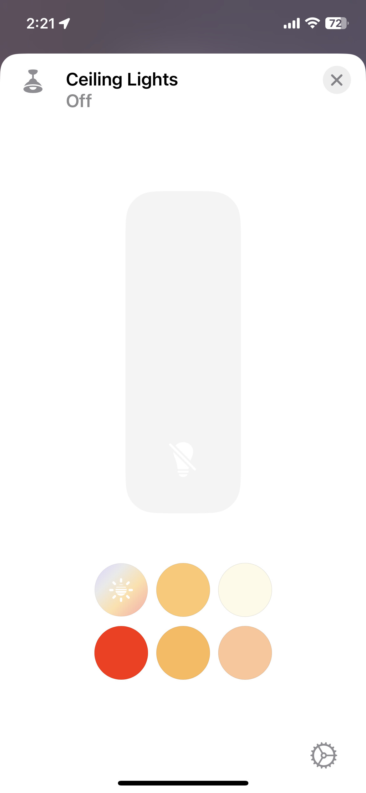

Is there a way to blanket disable adaptive lighting? I recently rebuilt HomeBridge and I think I took a bad turn somewhere. My color capable lights keep getting set to around 5000K which we hate. And per logs the command is definitely coming from HomeKit. Thanks!

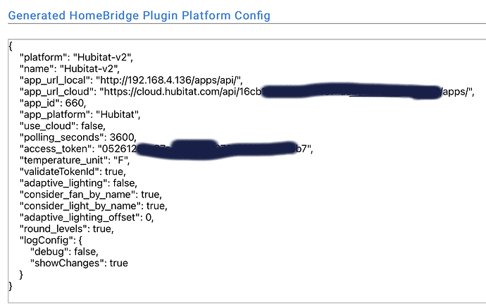

Have you tried:
"adaptive_lighting": false,
Otherwise you could just change them in Apple Home directly which should do the trick.
Just select anything but the pretty multicolored circle
Ugh! So easy. I was completely blind to that. Thanks.

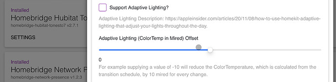

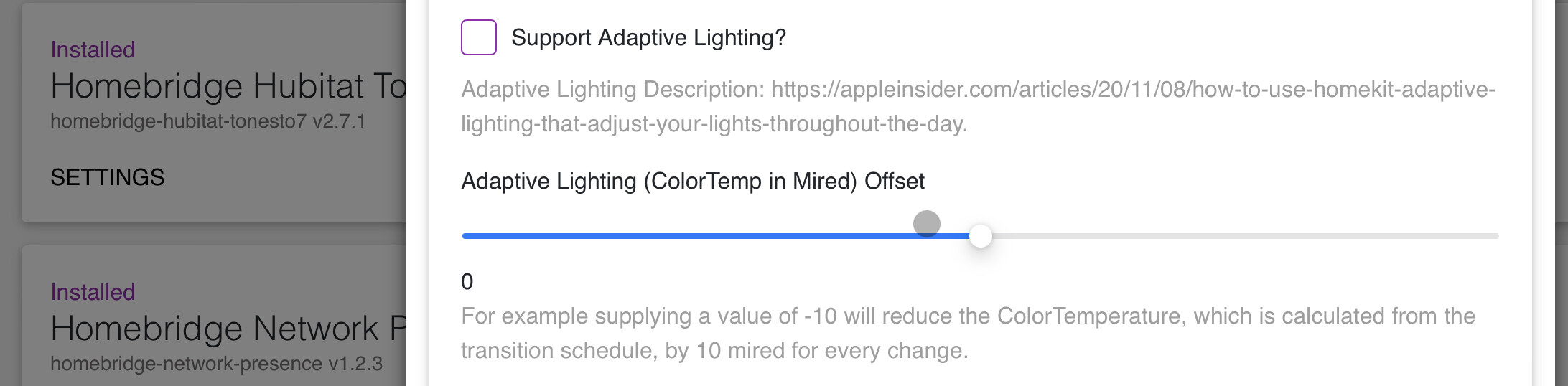

In the Homebridge UI plugin settings for Hubitat v2, there’s a setting to disable support for adaptive lighting.
Thanks. Did that too for good measure.

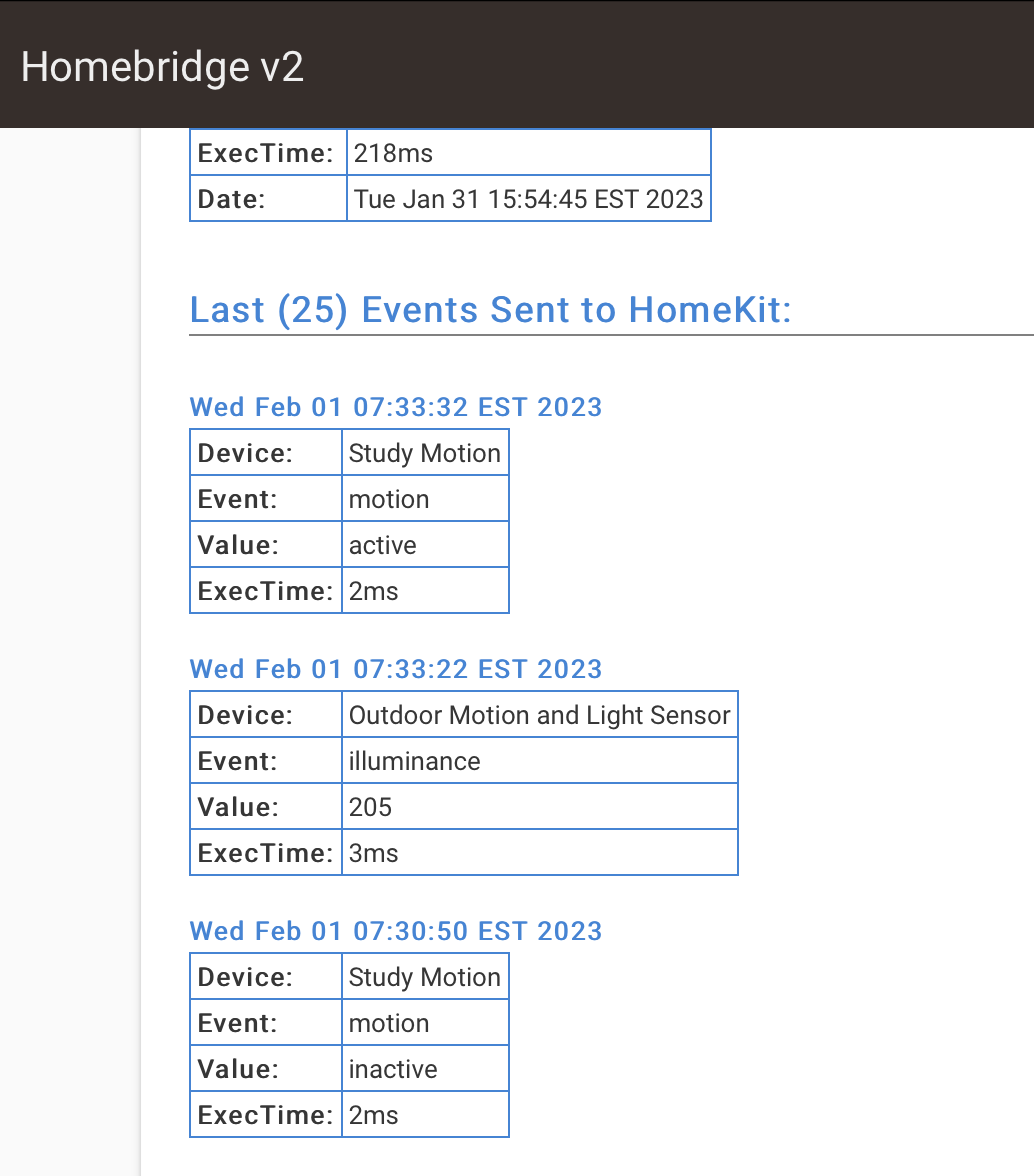

Took me a while to notice, but it seems that the events are only working in one direction. If you control a device on HomeKit, it is very quickly executed on Hubitat. BUT, Hubitat device events are not making it to HomeKit. I see the event on the the HE HomeBridge v2 logs as sent, but the HomeBridge doesn't get the event. I don't even see where this could be. Any pointers for me as to where to look? I moved HomeBridge from one Pi to another and only really tested it in one direction...
Are these the logs in Homebridge or HE? I had this happen intermittently before with the ciao mDNS advertiser. I changed it and the problem went away. I’m using Avahi now since I have my Homebridge running on Ubuntu to avoid problems.
I can see them on the HE HomeBridge Plug-in side like this:
But they never arrive on the HB side like this:

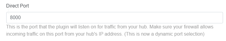

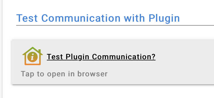

If you click on the “generate plugin config for Homebridge” and scroll to the bottom, there is a “test plugin for Homebridge” tab. Did you try hitting that?
Yes, it doesn't work. But, I don't know where it's even getting this port.
Its been a while but I think once you setup the HB plugin it tells the app on Hubitat how to talk to it. When I click the test link it is hitting port 8000 on the same IP as my HB server. Do you have that port being blocked? Or if you are running docker on a bridge you may need to forward that port. Not seeing anywhere that you can change that port.
Update, found the setting in the HB plugin settings UI

I would try changing that direct port to something else that is available on your server. Make sure it is allowed on the firewall or forwarded if using docker. Also must be a different port than what HB itself is running on. Restart HB and it should tell the Hubitat app the updated info.

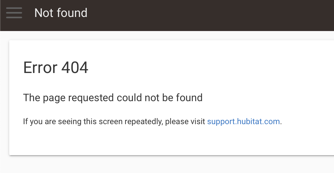

The HE has a web server on port 8080. But /pluginTest doesn't work there. I tried changing to port 8000 but HE isn't listening on port 8000. No port shows up in the "Generated Config"
There's so much "Magic" configuration going on here. I wish there was a straight forward configuration guide.
There is no /pluginTest on port 8080. Or port 80 for that matter.

The Direct IP and Direct Port on the Plugin configuration page of HB are the IP/Port of the HomeBridge instance, not the HomeBridge App on HE. Everything is working now. Geez. Thanks @jtp10181 and @Ken_Fraleigh.
