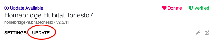

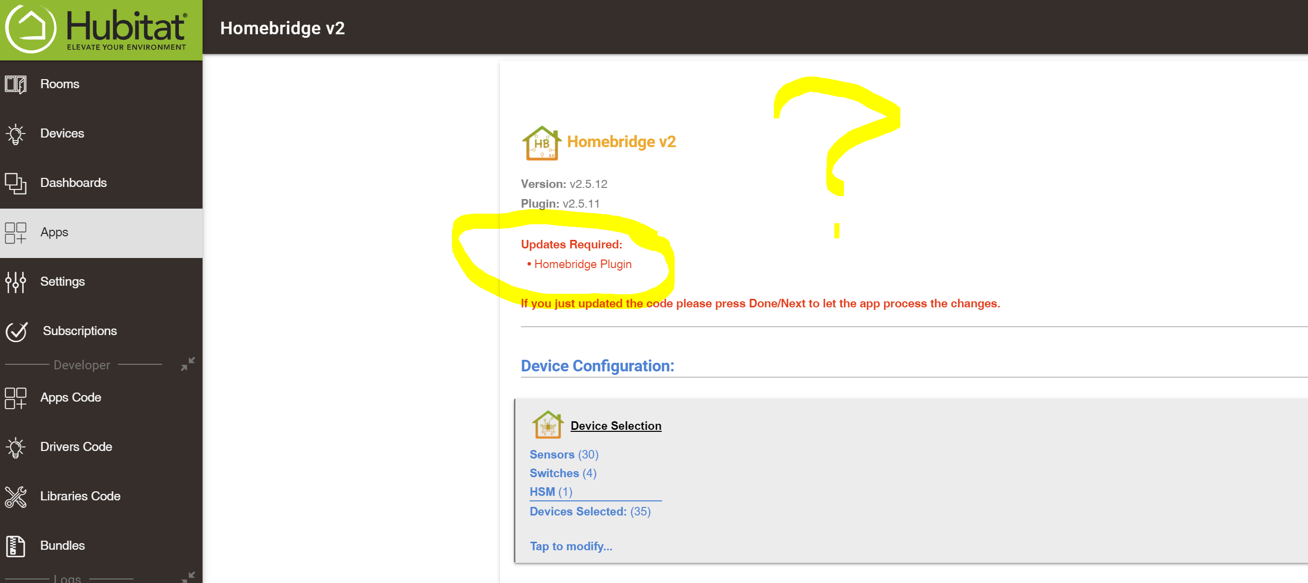

Same issue for me. How did you resolve this 'plugin' update error? I've tried rebooting Hubitat and Homebridge devices, no luck.
How do I get rid of the error in Hubitat saying the homebridge plugin needs to be updated?
You have to update the plugin from the Homebridge server itself, not within Hubitat. My Homebridge setup has been running so well that I forgot about the server piece.

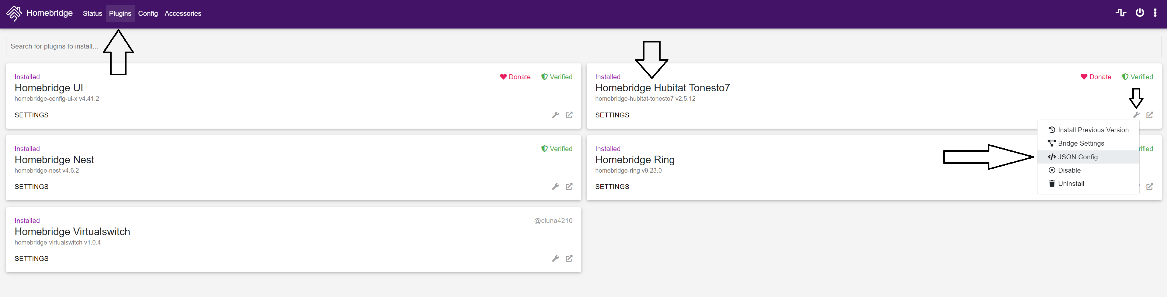

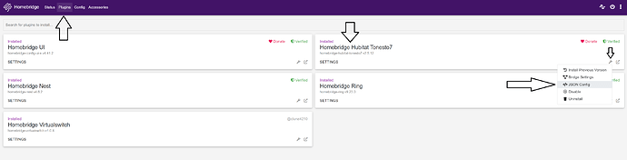

Where do I copy and paste the JSON config from the HUBITAT app?
Right here:
This goes into a bit more depth and also introduces multiple "child instances"... good if you have multiple hubs.
Thanks, I just powered through and installed the Web interface and then when that came up I saw a place for it. I got it running.
