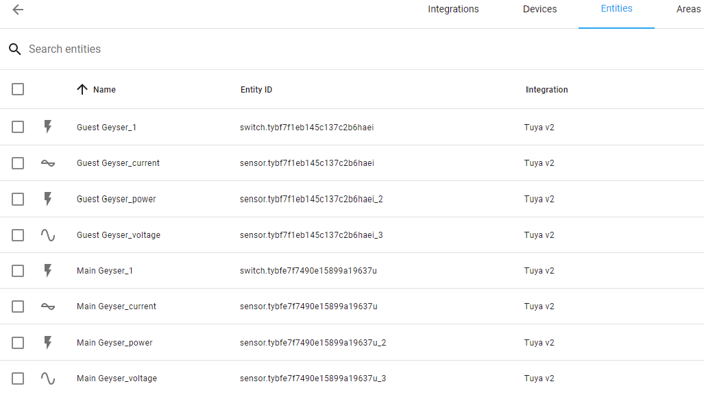

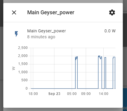

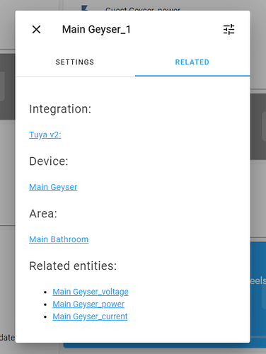

Yes it is a separate entry, but I don't know where to find the "sensor" section. Just as a note it brings through the voltage, just not the power and current.
