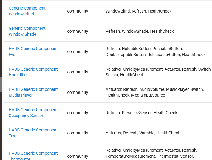

HADB is working really well for me. While checking driver versions on somethings I note that there is a naming issue that munges my listings.
Some drivers from HABD come over as 'Generic ....' some come as 'HABD Generic ...' . This makes my listing messy with my other Generic drivers.
Personally, the HABD prefix works better for me to ID them visually.
The Ask:
Could the Generic Components be updated in the name fields so all begin with 'HABD Generic ...'?
Nope - what I wrote was incorrect.
I'm aware of the confusion. I started to name the newer child drivers as they were introduced for that reason. I could rename the older one with the HADB prefix but users would end up with two copies of the same driver with different names. Newly created devices would use the new named drivers but older devices would still use the original ones.
The same goes for the parent device. I would like to rename it HADB parent but It would probably create a mess.
I don't think there is an automated way to clean that up.
I'm open to clever suggestions

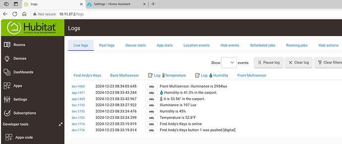

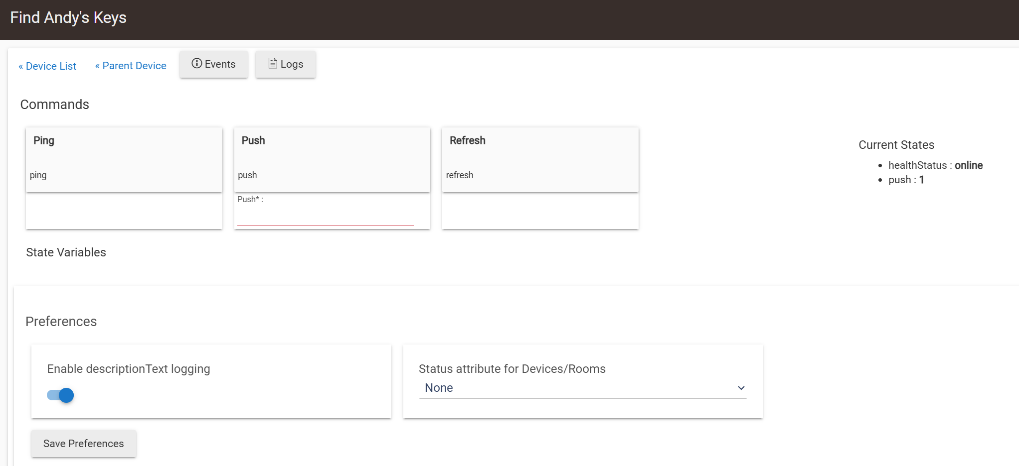

There seems to be a problem with a shared button from HA being able to trigger automations in Rule Machine, or I don't know what I'm doing....
I generally use HA for all my dashboards and statistics and HE for automations. As such, I created a virtual button, or "Helper device", in Home Assistant, and then used HADB to share that button to Hubitat to trigger an automation.
When the "button" is pressed in Home Assistant, the button device page in Hubitat correctly shows a "press" on button 1, and the Hubitat log also shows a press on button 1. Great, all should be working right?

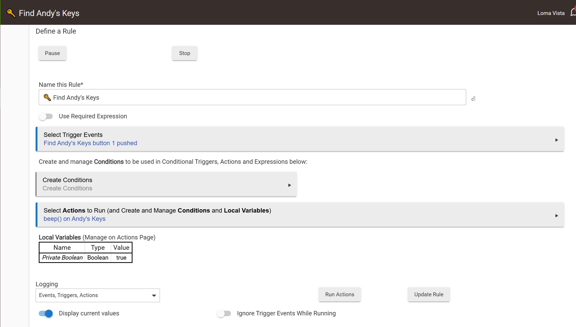

Then I created an automation in Hubitat to beep my keychain when button 1 is pressed. However, despite the fact that Hubitat seems to recognize that button 1 was pressed, the automation from Rule Machine simply will not trigger. What am I doing wrong?
Here's a screenshot of the Rule Machine automation in question, and a short log post showing that Hubitat does recognize the button press, but for whatever reason the rule is not being triggered.
Log:
Rule Machine:
Device Page:
Fix is on the way
