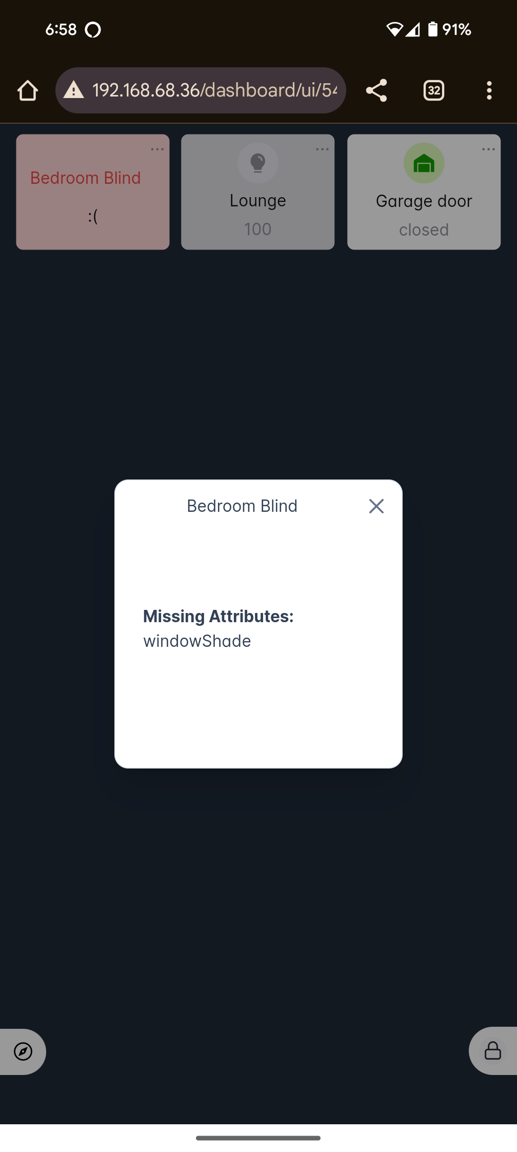

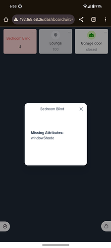

Is it possible to set this attribute when using
the generic blinds driver?
