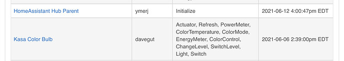

You would need to add in mapping for energy into the parent driver and use one of the component drivers with energy.

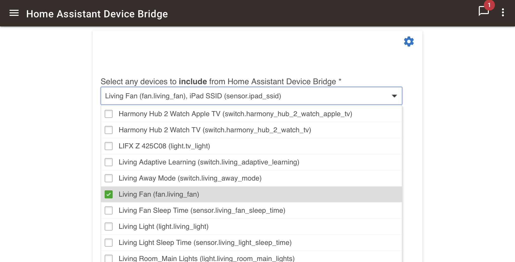

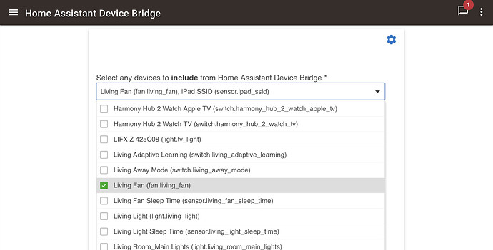

My fan won’t show in devices. Am I doing something wrong?
Thank you
Have you turned the Fan On and Off in Home Assistant? Devices will only be created if Hubitat receives a status update from Home Assistant.
Thanks, works. This is EXACTLY why I use Hubitat over h.a whenever possible
45 mins and a developer answered. That’s invaluable
Thx again
Home Assistant will begin to populate with child devices in Hubitat, upon each device update.
Example: Motion sensors will appear automatically when they are triggered for the first time after selecting them for import to Hubitat.
It was in op, I just did not understand

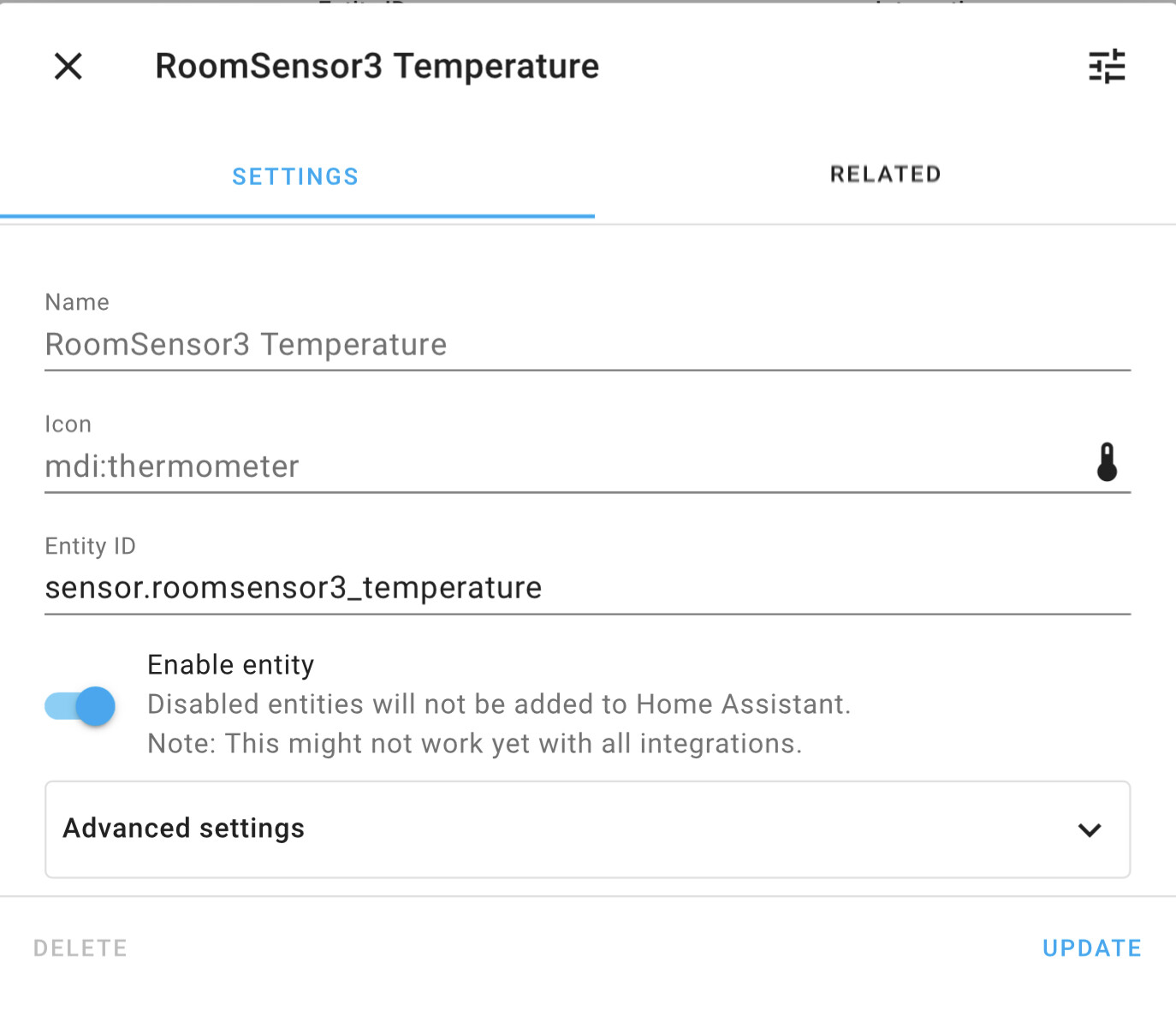

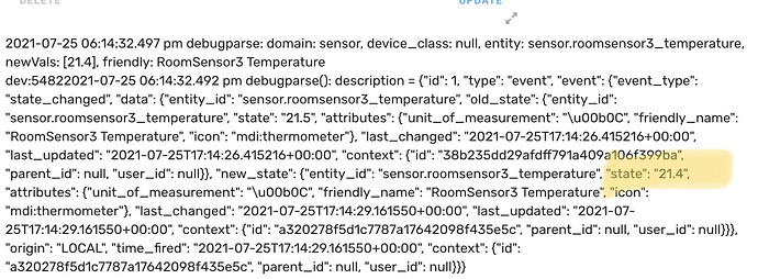

Hi Folks, got a number of devices up and running with this integration, but stuck with this temperature sensor.. any clues?
2021-07-25 06:14:32.497 pm debugparse: domain: sensor, device_class: null, entity: sensor.roomsensor3_temperature, newVals: [21.4], friendly: RoomSensor3 Temperature
dev:54822021-07-25 06:14:32.492 pm debugparse(): description = {"id": 1, "type": "event", "event": {"event_type": "state_changed", "data": {"entity_id": "sensor.roomsensor3_temperature", "old_state": {"entity_id": "sensor.roomsensor3_temperature", "state": "21.5", "attributes": {"unit_of_measurement": "\u00b0C", "friendly_name": "RoomSensor3 Temperature", "icon": "mdi:thermometer"}, "last_changed": "2021-07-25T17:14:26.415216+00:00", "last_updated": "2021-07-25T17:14:26.415216+00:00", "context": {"id": "38b235dd29afdff791a409a106f399ba", "parent_id": null, "user_id": null}}, "new_state": {"entity_id": "sensor.roomsensor3_temperature", "state": "21.4", "attributes": {"unit_of_measurement": "\u00b0C", "friendly_name": "RoomSensor3 Temperature", "icon": "mdi:thermometer"}, "last_changed": "2021-07-25T17:14:29.161550+00:00", "last_updated": "2021-07-25T17:14:29.161550+00:00", "context": {"id": "a320278f5d1c7787a17642098f435e5c", "parent_id": null, "user_id": null}}}, "origin": "LOCAL", "time_fired": "2021-07-25T17:14:29.161550+00:00", "context": {"id": "a320278f5d1c7787a17642098f435e5c", "parent_id": null, "user_id": null}}}
I assume this particular HA device is not creating a child device in Hubitat? Anything in the logs? The child device will not appear until HA sends a status update, which it appears is what you’re showing above…:thinking:
That’s right .. no child device is created. What I see in the logs is just below the screenshot .. I see temperature updates coming through in the app logs from the device but no child device is created …
I think the issue is device_class: null in the event. Is it possible to customize that to report as temperature?
Brilliant Thanks - That was it!
