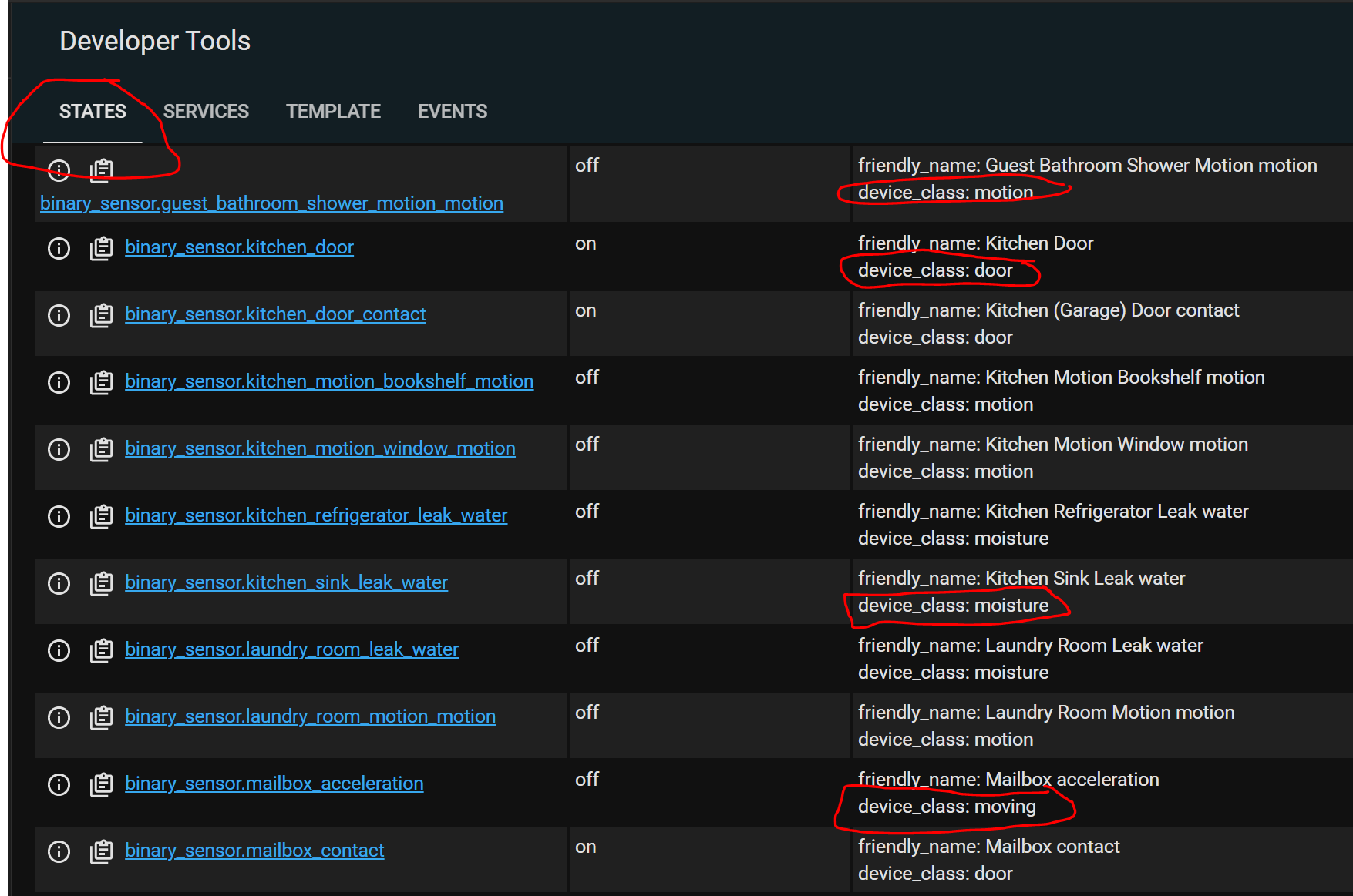

If you go into the Hass Developer Tools, and then the select States at the top, what Device Class are your Nest Protects showing up as in Home Assistant? (see examples below)

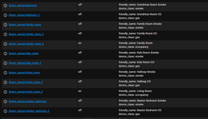

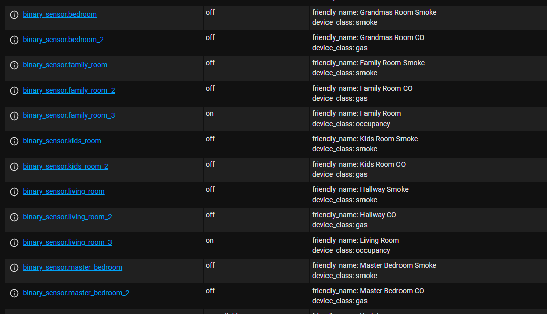

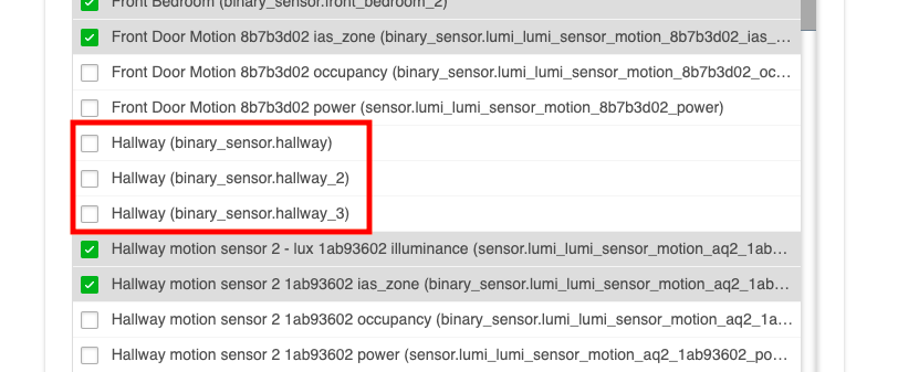

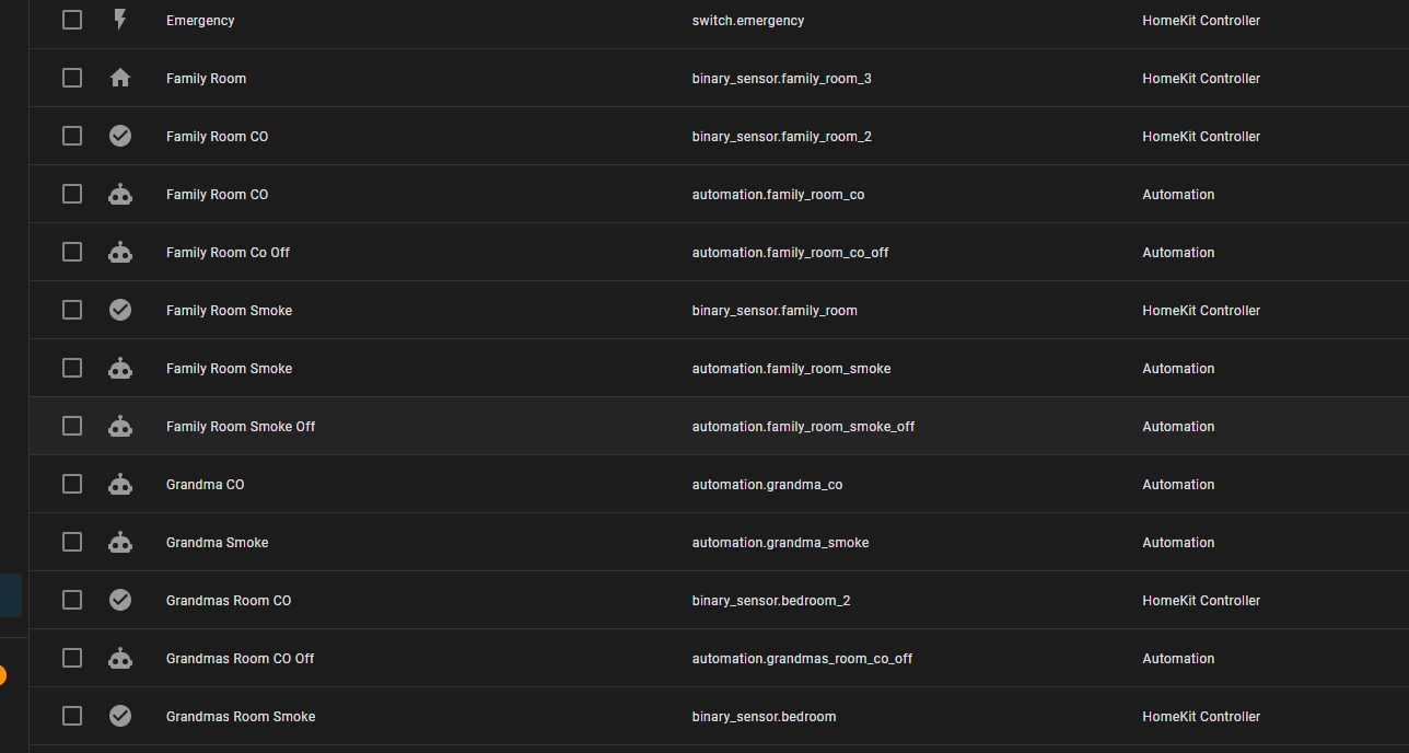

These are from one of my detectors

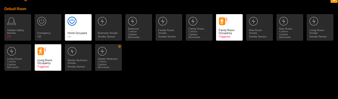

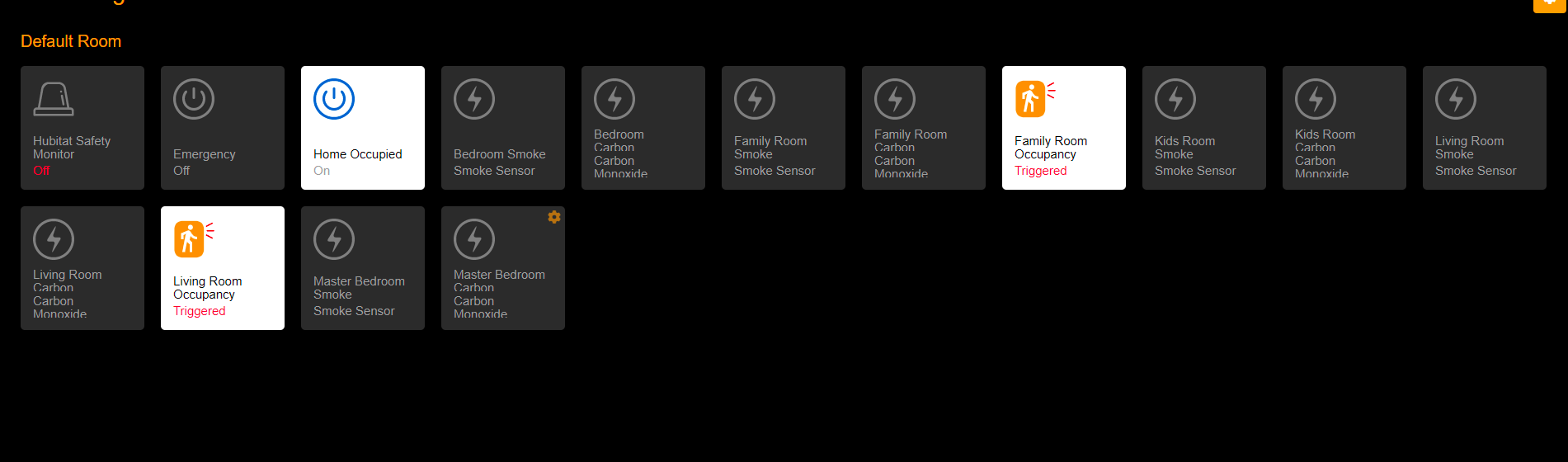

I don't know how it is for you in Homebridge to HA, but I don't like how it's showing up in Hoobs, and then HA. It shows the name of the detector but it's just labelling the other components as _2 and _3 (i.e. Hallway, Hallway_2, Hallway_3). With that, I have no idea which one is Smoke, which is CO. Whereas in HomeKit, it labels them Smoke and CO, along with icons.

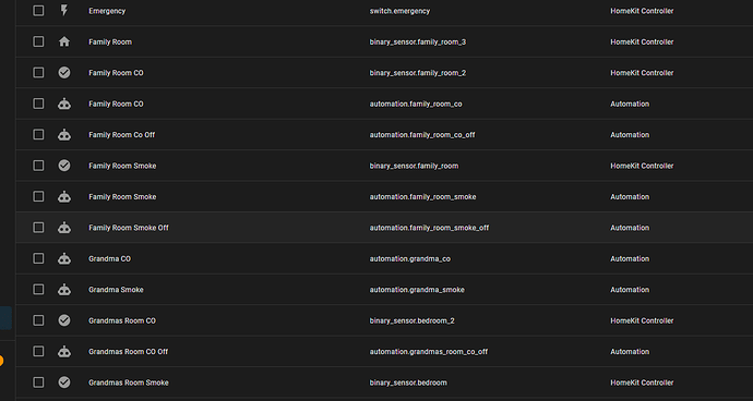

I can see them in the app as well but if I trigger them still nothing. I checked each one in HAAS to determine which ones have states of smoke vs gas and renamed them as I had that same issue. The wired ones properly get called motion sensors.
