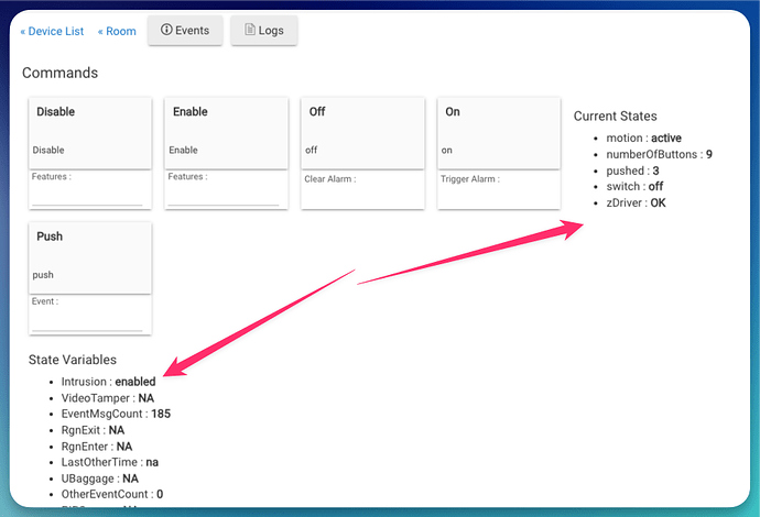

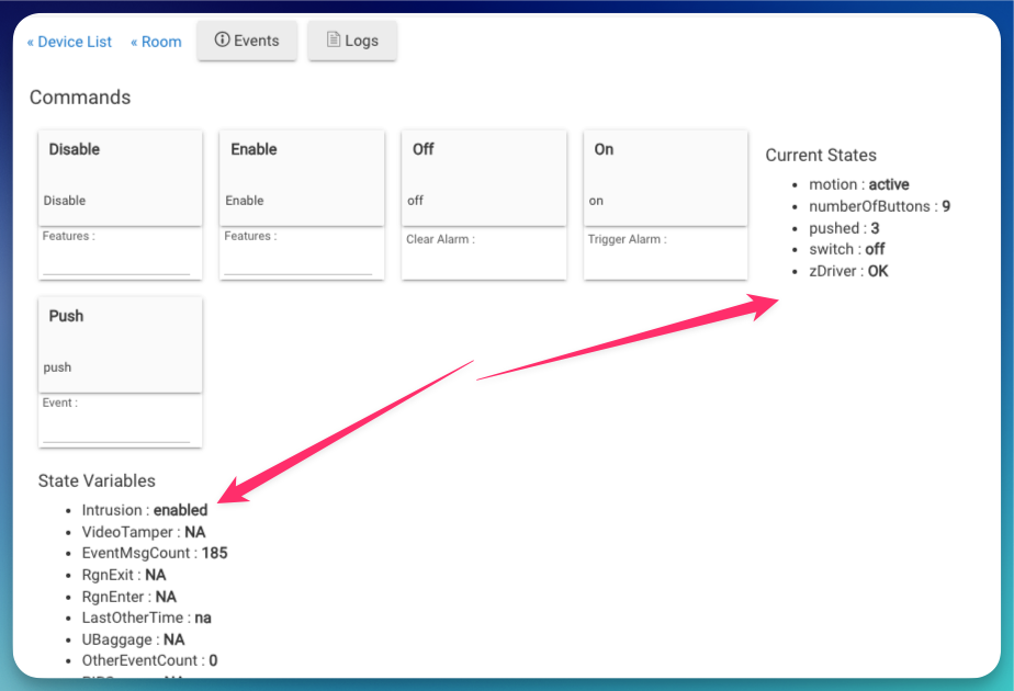

I have the setup working basically but there is one feature I'm missing. I'd like to display on my dashboard the state of a given feature on the camera. I.e. I'm only using the "Intrusion" now and I'd love to display on my dashboard the state of that boolean as it represents the state of the toggle on the camera side so I'd be sure that the system worked and everything is armed properly by looking at that flag on the dashboard.
AFAIK it's not possible to extract that internal state from a device in Hubitat (the Custom Attribute is only for the "Current State" items).
Is there a workaround I can make to access this "State Variable" globally in Hubitat?

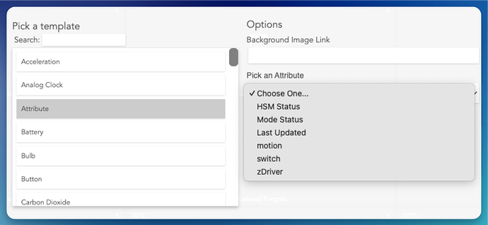

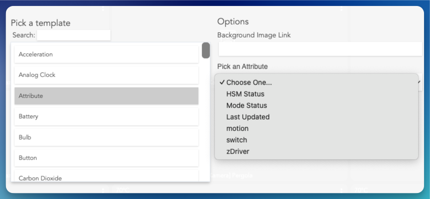

Thanks, glad you like and find this driver useful. You can add a tile to your dashboard to display the value of any state variable. To do so: 1) Add a new tile, 2) Select your camera device, 3) Select the Attribute template, 4) Select the Intrusion attribute. The tile will display its value. Clicking the tile will have no effect. Hope that's all you need!
Thank you but I think the attribute only shows Current States stuff. This is the list on my side when selecting the camera:
Here someone from support wrote that:
Any app can only use the current states of a device. The state variables are for informational purpose, and visible only for that driver.
So as far as a I understand, the "State Variables" are only internal, and nothing outside the device/driver code can access them.
