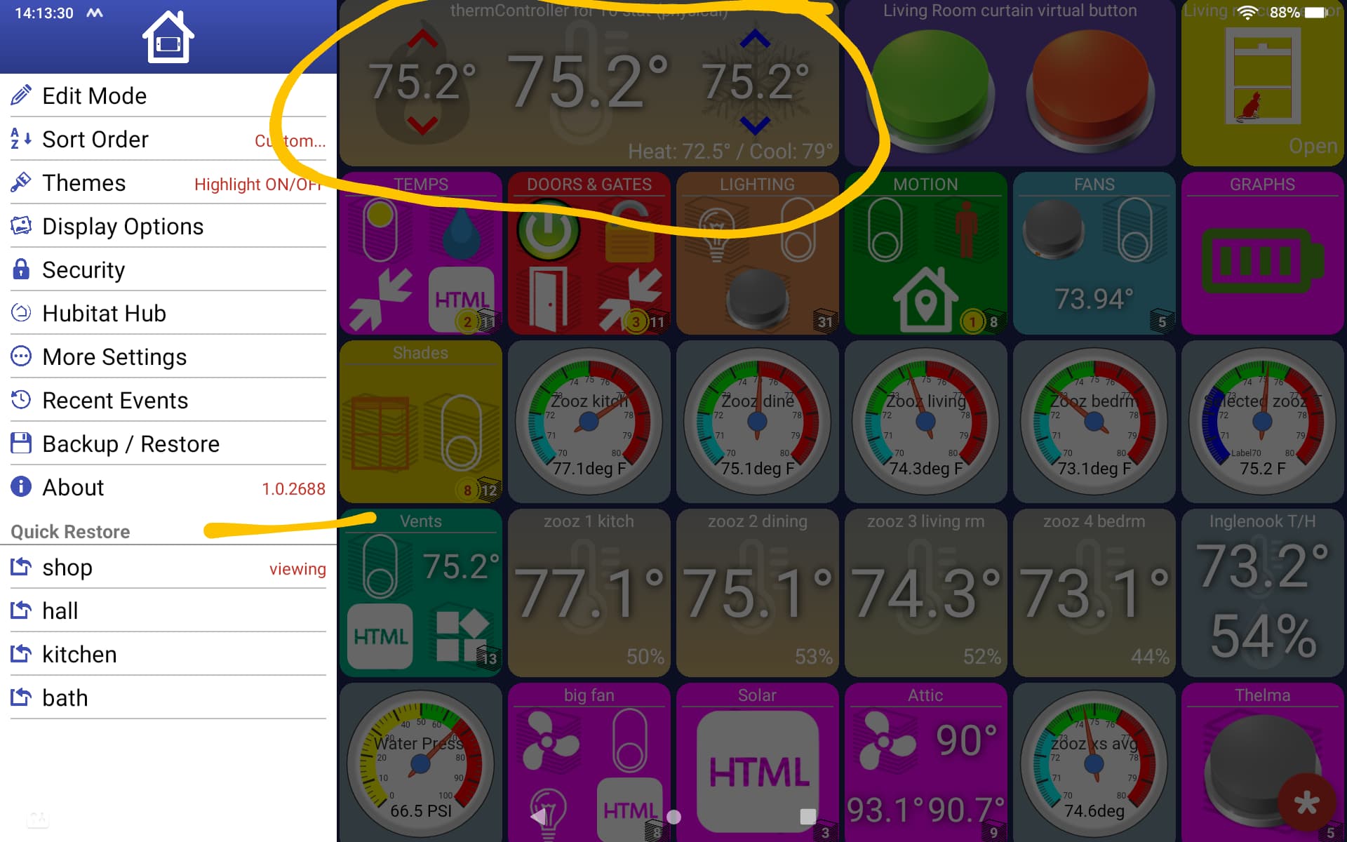

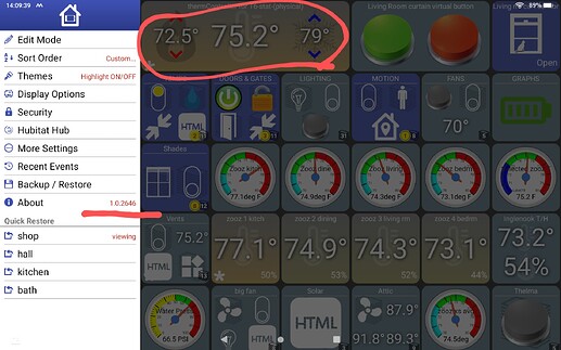

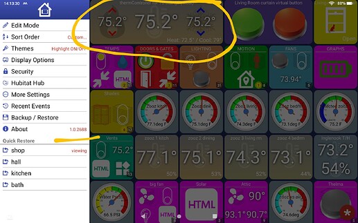

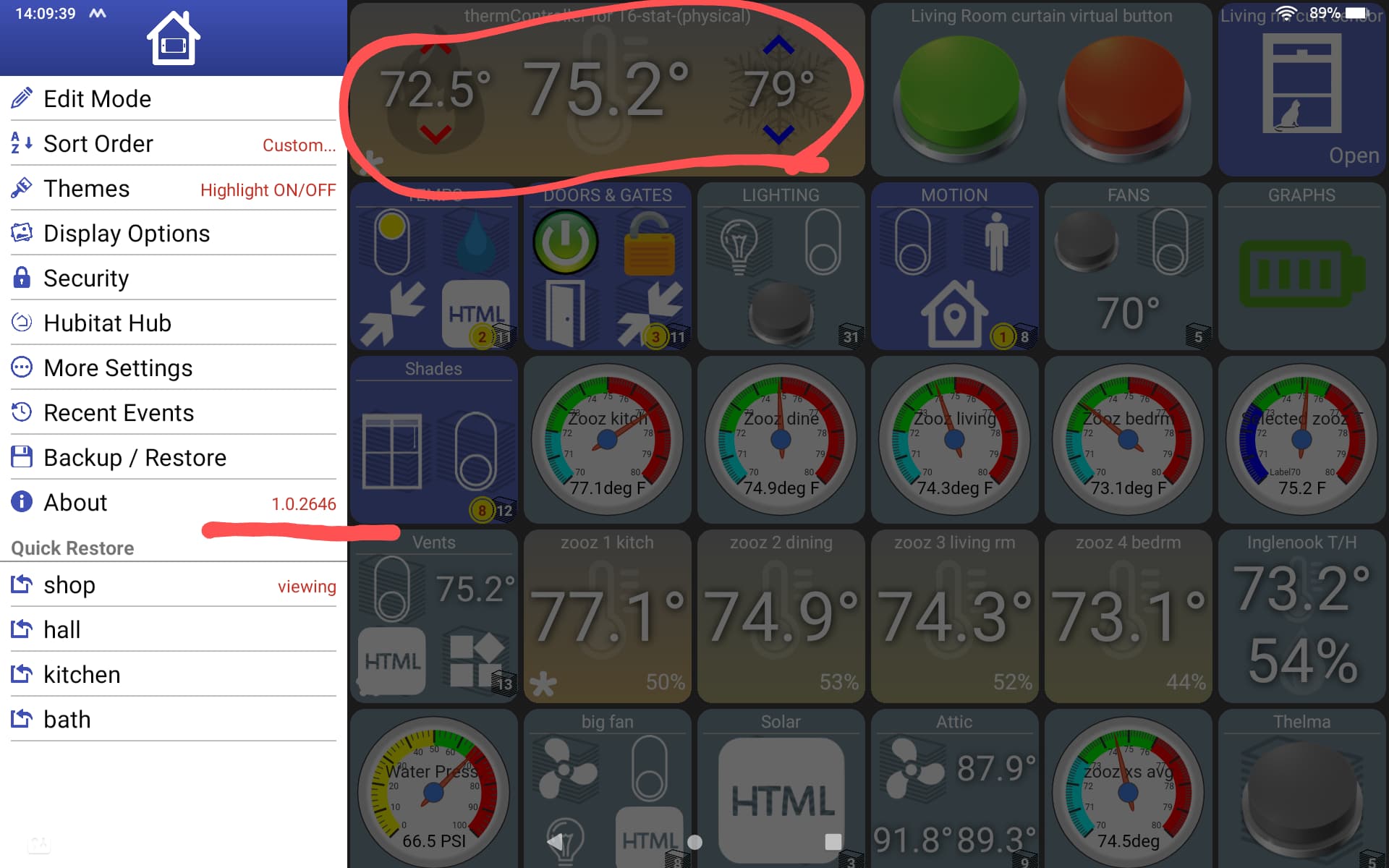

Yep, that's a bug. I hadn't tested that size and in auto mode
Thank you.

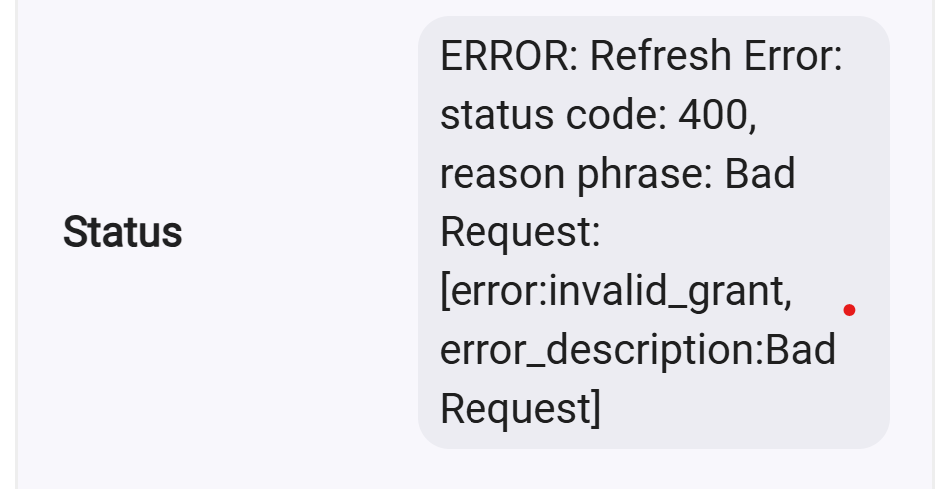

Any idea why I would get this error? Happened after a hub reboot while upgrading platform version. I'm up to date on your driver according to HPM. Hub is a C5.
What is that FollowMe tile? How are you tracking the presence in the specific location in the home?
I don't think I've had that happen but I do remember something about the oauth token that Google gives you only being valid for an hour or so.. so if the Hub was offline and not able to get a new token for a while maybe that could cause this?
Are you able to use that Authorize App button?

  • fix thermostat in auto mode and wide view

should be fixed
fixed

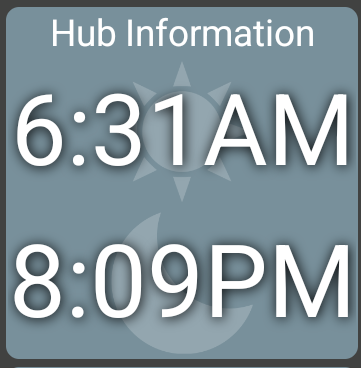

Lastly, I added simple support for the Hub Information Driver. It just shows the sunrise and sunset by default. You also might want to change the sunrise date format too in the driver like I did below just to keep the text as large as possible.
20250502-1935PM-1
There's a lot more that could be done with this one but I remember someone asking about sunset support so I thought this would be a good starting point.

Yes, that button works. I ran it again, but it already said it was authorized.
We'll see what happens now. I did notice that there was an unusual error in the status field:
That error went away when I sent a test message via the Device Notification function (after I re-ran the Authorize). Maybe something happened when my hub was stuck last week in an overload condition.

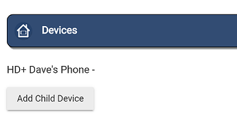

Looking again at the device in the app I now see that since I sent the sucessful test message that the "null" that was showing up after my device name in the App is gone:
(There was the word "null" after the dash before.)
