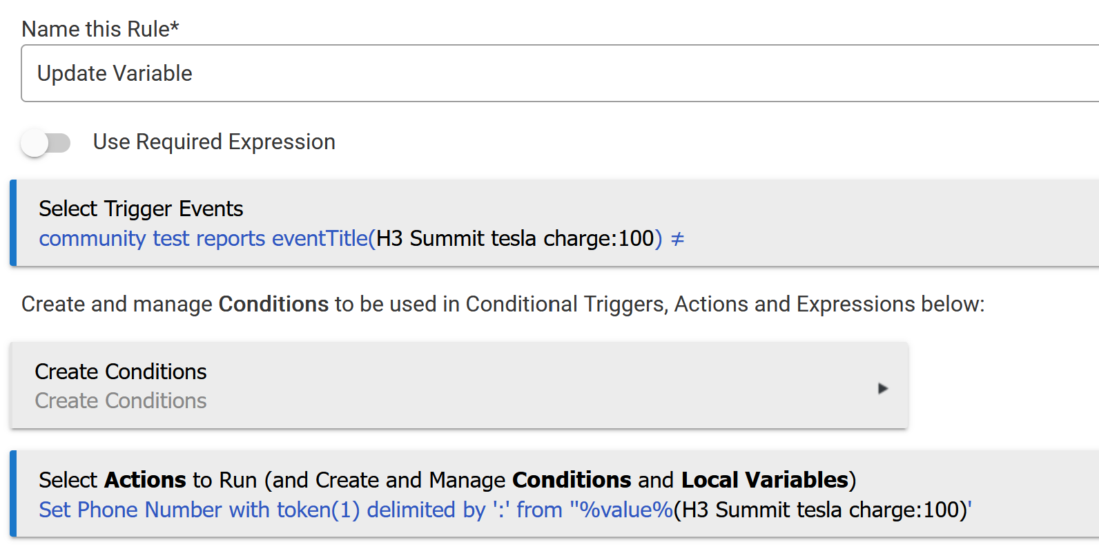

Unfortunately this functionality isn't going to work for your use case. Instead you could use Rule Machine to trigger on changes to your child switch eventTitle and extract your value via token function but the fact your string has a % in it will cause problems. Know you mention your words tend to vary but I would recommend standardizing them or choose something other than % as a delimiter.
See this article on how to extract token from strings:

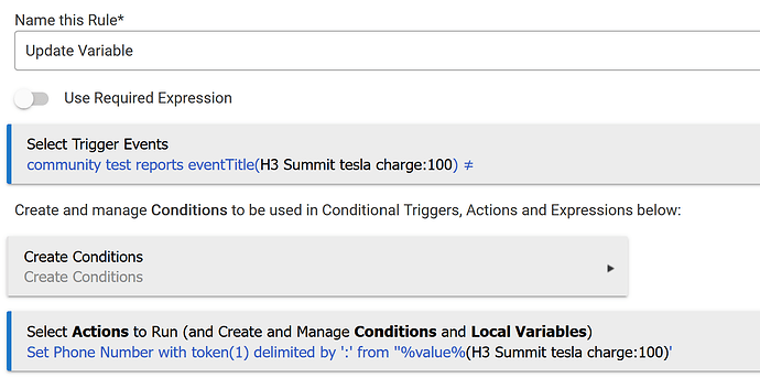

Here is an example where I changed your % to a : and the rule properly extracted the 100 from the string, ignore the "phone number" as I reused an existing string variable I have on my dev hub.
Variable value:
Note the rule trigger is eventTitle does not equal a space " ". When no event is found by the search trigger the app sets all state variables to a single space. So you can catch this by looking for eventTitle != " "
Thanks! Having real difficulty finding the Extract Token action - doesn't seem to be on any options?
I created a new rule in example above so v5.1 and it shows up with a string type variable, not number.
Ok. That was a bit cryptic but I think I got it now. Set up the variable as a string and then the Extract Token option appears in RM. Thanks!

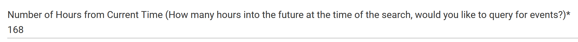

So I was wondering if I could get some help with understanding how to do something with this app. What I would like to happen is create a GCal Search that looks for a certain calendar event, and if it finds one that is within the next 7 days, to turn on a child switch.
I have other GCal Searches set up for other things that work well this way, but they only look to the end of the current day. I want this new one to look into the next 7 days. I thought I could do that by using the "Number of Hours from Current Time" in the Search Range drop down. I set it to 168 hours (7 days). But this did not seem to work. There is a calendar event 6 days out it should have found but seems to not have found it.
I hope this makes some sense.
Any help would be appreciated! Thanks.
This use case should work in the current version. Would you mind sharing your search trigger settings and screenshot of your calendar entry that should have been found? I can verify settings and try to reproduce the issue. Feel free to PM the details instead if you prefer.

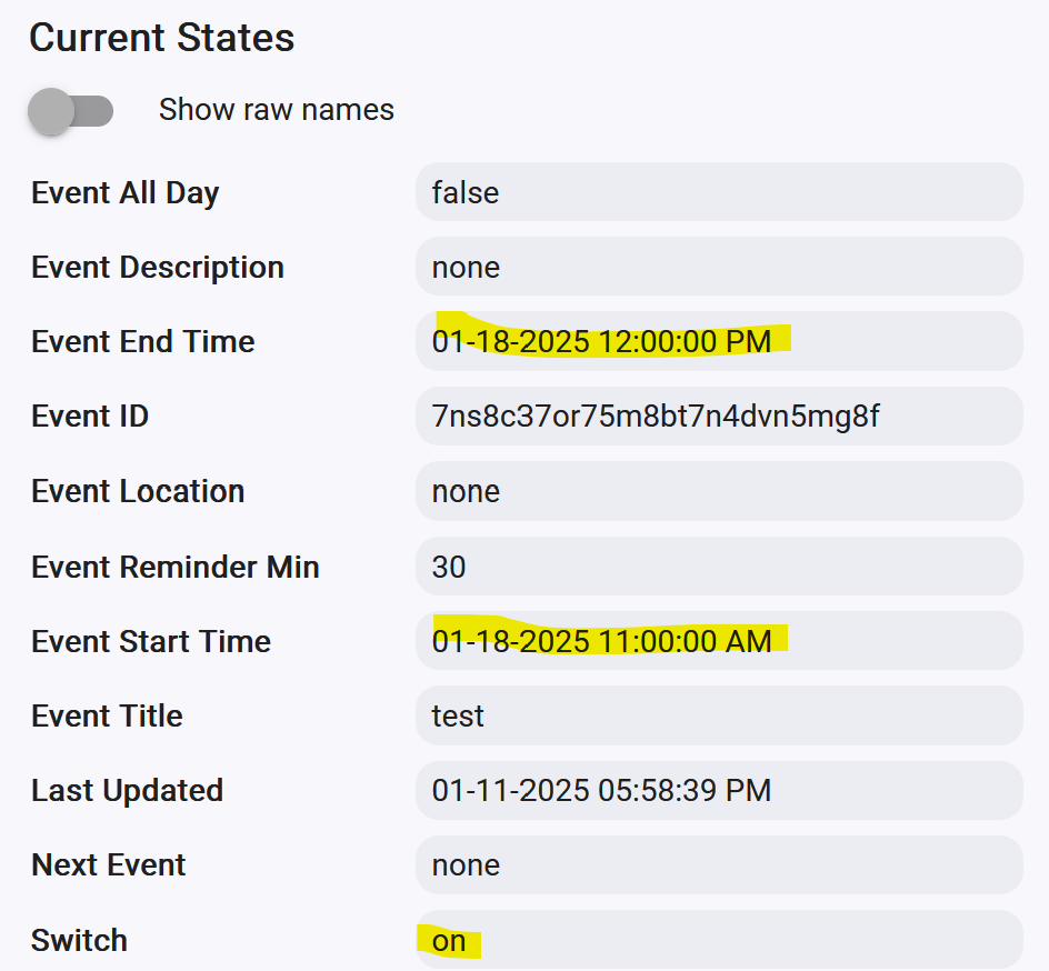

@maxq10 I just setup a quick test:
- Created a calendar event on Saturday, 1/18 at 11 AM
- Set the search trigger to:

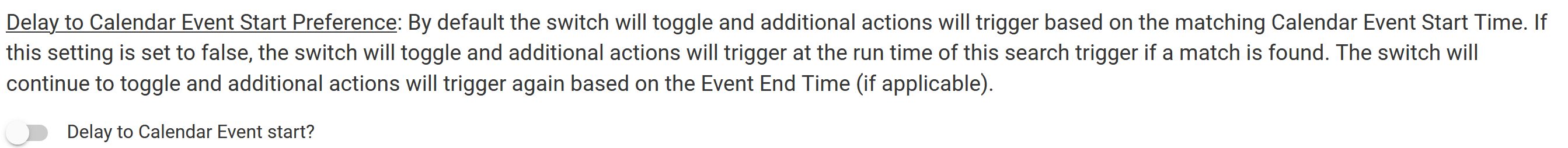

- If this setting is on, then the switch won't turn on until the 18th at 11 but if you set it to off the switch will turn on at the time of the scheduled query of your calendar (when the matching event is found).
- I set the above setting to off and the switch turned on:
This was it! It is working as I expected it to now. Thanks!
