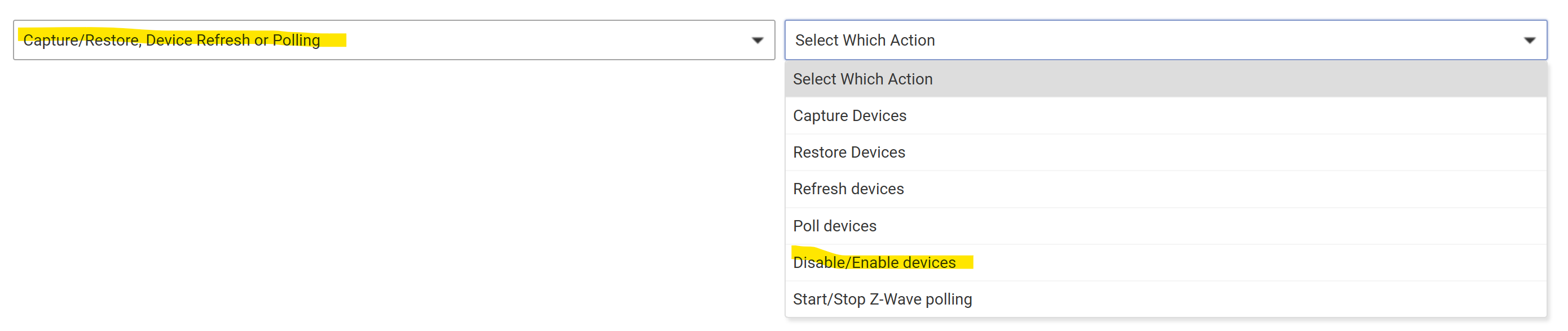

This is great, I just set it up. One question. I want the gcal integration to speak all events from one calendar at the start of that event on one of my speakers. But only if a certain switch is off. How can I pull this off, so it reads the %eventTitle% %eventDescription%
Happy you are finding this useful. Within the Additional Actions \ Notifications there is an option to include details from all matching events. But this fires based on the start time of the event found by the search trigger and cannot check values of other switches.
My only idea is you use a Rule Machine rule to enable and disable your notification device based on the value of the switch you are referring to. If the notification device is disabled the notification won't happen when GCal tries to send the notification.

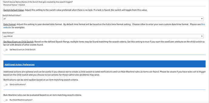

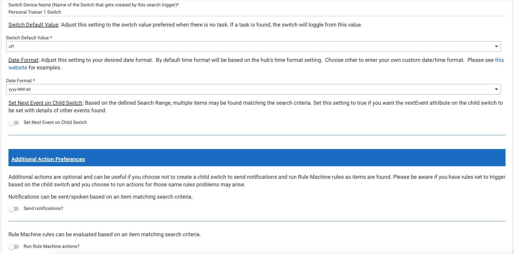

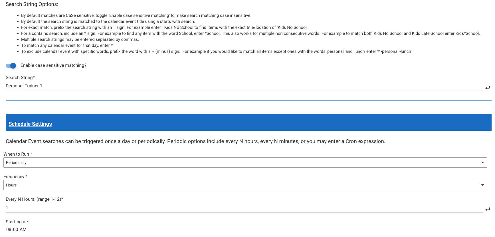

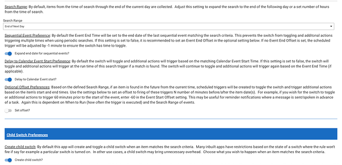

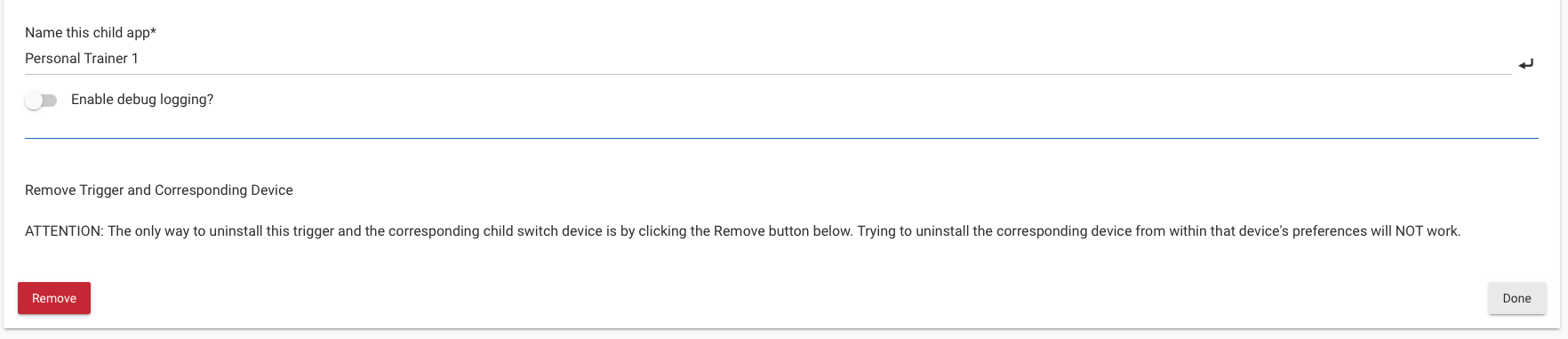

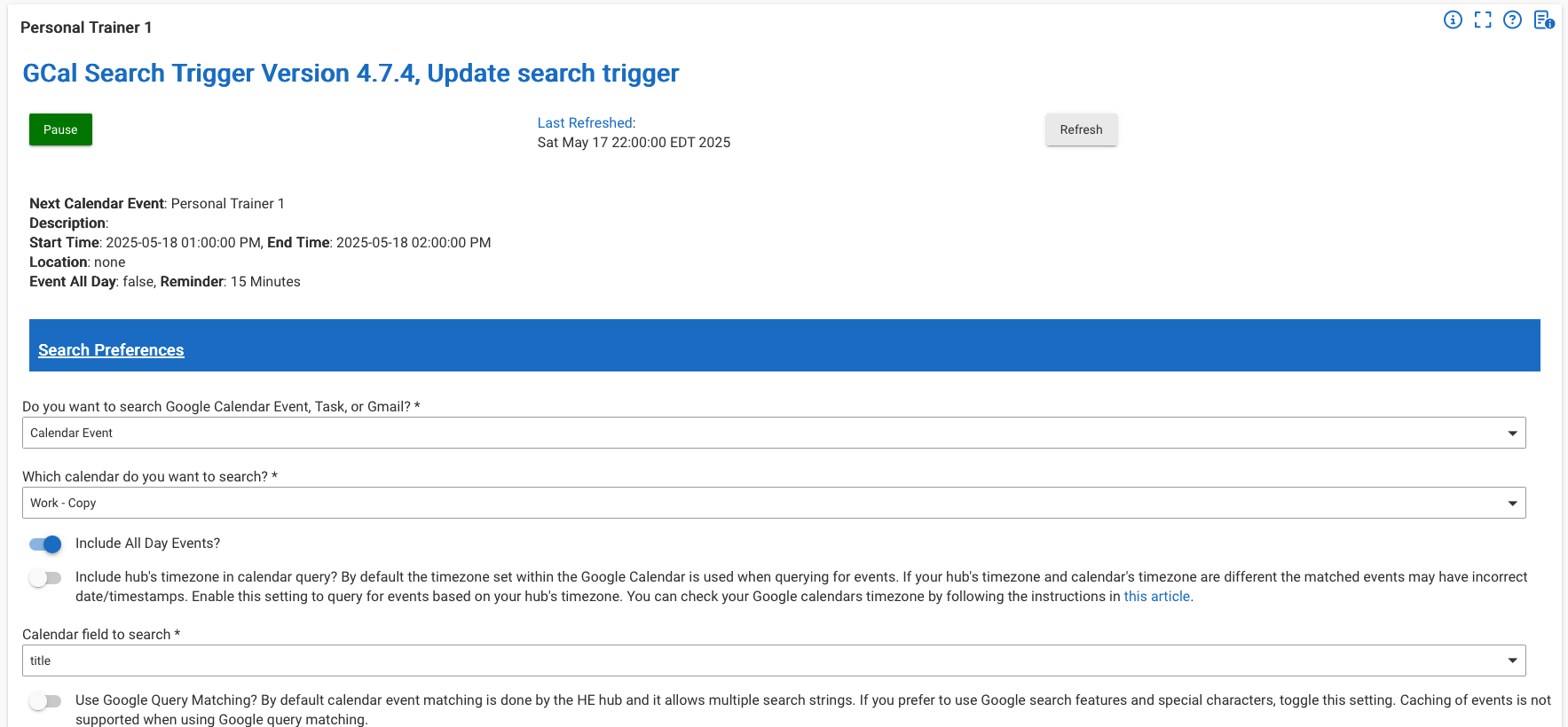

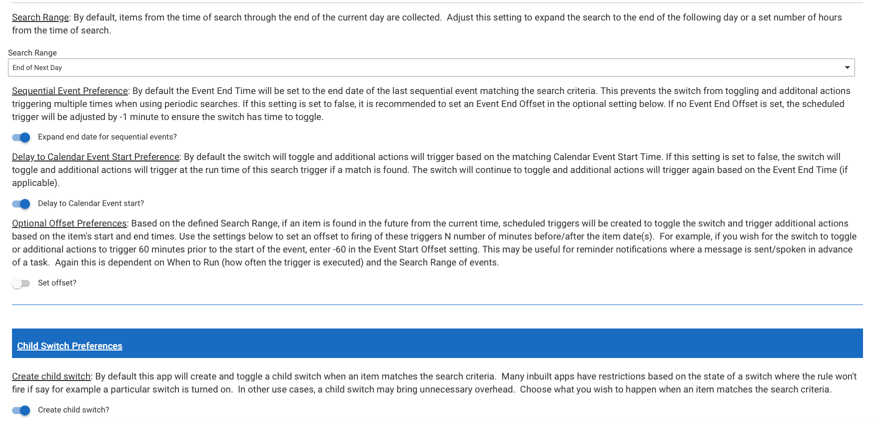

I would like to set up a GCal Search that lets me know if an appointment with a certain title is in the calendar. I have it searching for "Personal Trainer" in my calendar to see if there is an occurrence by "End of Next Day". It seems to be working but only turning the switch on at the start of the appointment and then off at the end of the appointment.
This might be the desired behavior. But if it is then why is the "End of Next Day" option available?
What I want is for the switch to go on to indicate that I have a training the next day. Is this possible? I have included my setup below if that is helpful. Thanks.
This is the default behavior to wait for the event start. Within the Schedule Settings section you will see a “Delay to Calendar Event Start” toggle that you can turn off and it will immediately turn on the switch when the Search Trigger finds a matching event. Obviously you would need to time the search trigger to query toy calendar at an appropriate time when you want the switch to turn on if an event is found.
Thanks!

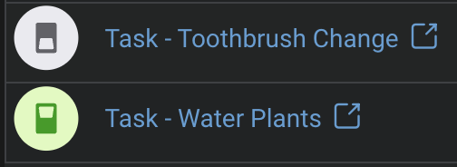

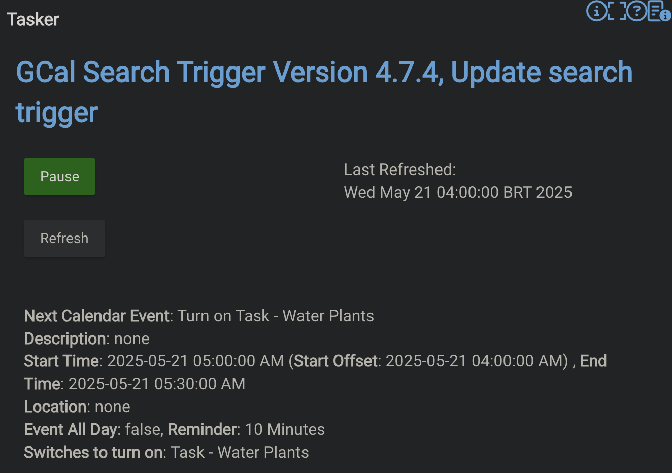

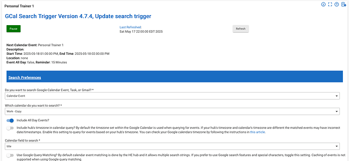

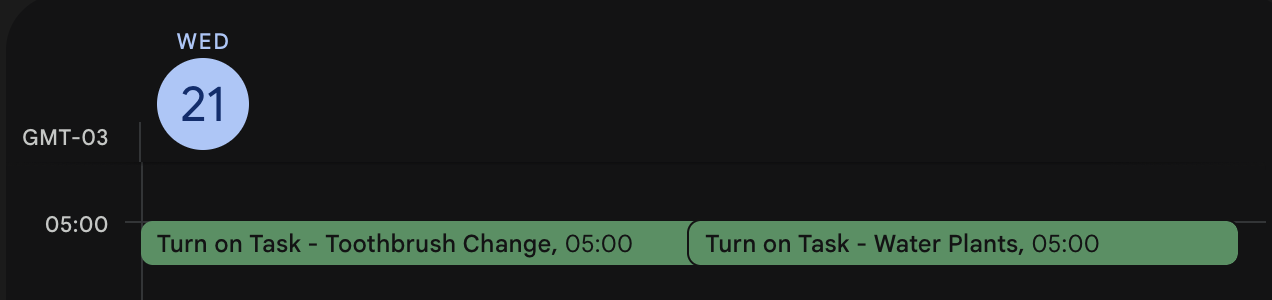

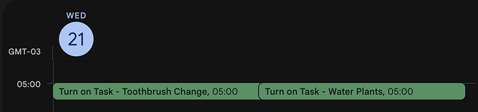

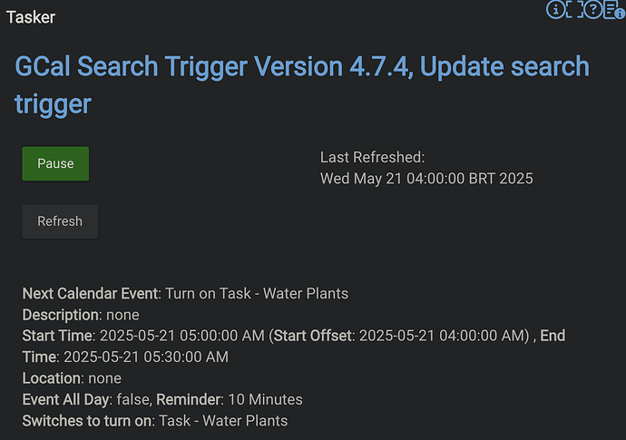

@ritchierich, first of all thanks for the app, it is extremely useful!
I've been using it for several months and it works really well, except for a very strange issue.
I use it only to turn switches on (tasks) based on calendar events, currently I have 9 switches and they all work except for 1, I'm not sure if is something in its name, it should turn on every 3 months, last time it didn't work and I thought it was a network communication issue, but today it should have been turned on, and again it didn't work, but today there was another calendar event together (same time), and that one had no issues, so I ruled out a network issue.
The one that is not working is 'Turn on Task - Toothbrush Change'
These were the logs produced
app:454 2025-05-21 04:00:10.735 info Toggling Switches -
app:454 2025-05-21 04:00:10.733 info Toggling Switches - turning on: Task - Water Plants
dev:807 2025-05-21 04:00:10.726 info Task - Water Plants was turned on
I have double checked the name of the calendar event and that of the switch
The top of the Tasker app page is showing the following at the moment:
Do you have a clue on what could be the problem?
Edit: Solved
I had set this up so long ago that I forgot that the switches to be controlled should be specified in the app page :man_facepalming:
