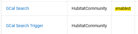

Also in your list of Apps code make sure that GCal Search has Oauth enabled:
If everything above is correct, open the parent GCal Search app, go to the Options section and enable debug logging. Open Logs in a separate browser tab and go through the Google API Authorization again to capture what is happening for clues. These logs will contain your login details so please be careful posting them back here or PM me those.
