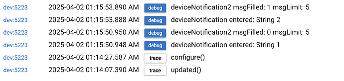

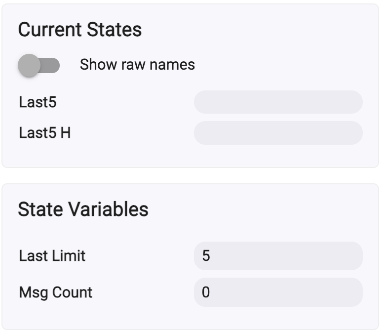

@thebearmay I have been using this driver since Oct 2024. Awesome! Thank you.
Sometime between then and Jan/Feb 2025 through various HE betas and releases, this driver stopped working. I can add messages manually from the driver page, but the Current States are still blank. Changes to the state are what trigger a rule to take the text, modify it, and send it via pushover. Blank state = no rule trigger.
Any suggestions on getting this to work again?
I would check to make sure it is still selected as a notification device in the source app(s) - maybe remove and re-add it to them.
