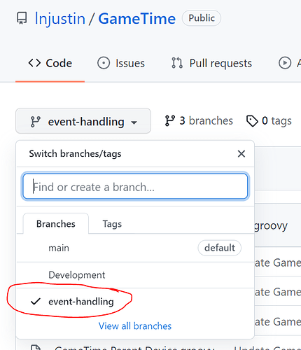

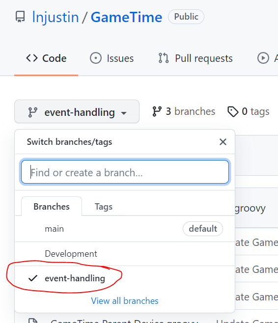

Ah. I think somehow you got to the wrong branch on github. Looks like you're in the Development branch, not the event-handling branch.
Should be v 1.5.0
Ah okay. My bad. Don't know how that happened. I actually had a combo of v1.5.0 and v1.4.3 installed. I erroneously said I was using v1.2.0 because I looked at the top line of your version history and assumed that was your most recent. Most developers go bottom up with the versioning. Just figured out you went top down. Oops sorry. Anyway, I got v1.5.0 installed now and everything looks good.

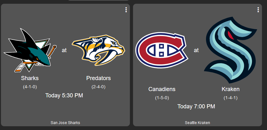

Stumbled onto this app - wow! amazing work! Loving how it works on Hubitat dashboard for Android! As I was playing - there is a new team in Hockey called the Seattle Kraken. My hubitatDashboard Android is messing up with their logo - I believe it's a bit oddly shaped:
I did a rushed comparison to all the other NHL logo's and this thing is a bit strange in that it's taller than it is wide, only thing nearly close is the LA Kings :).
Glad you're enjoying the app. I'm not very observant when it comes to artistic things like this, so I might need a bit more help from you in identifying the issue. I can't seem to figure out what's wrong with the logo being displayed. A side-by-side that I got from nhl.com makes them look the same to me, but like i said i'm not very observant...
@@ this is not life threatening!

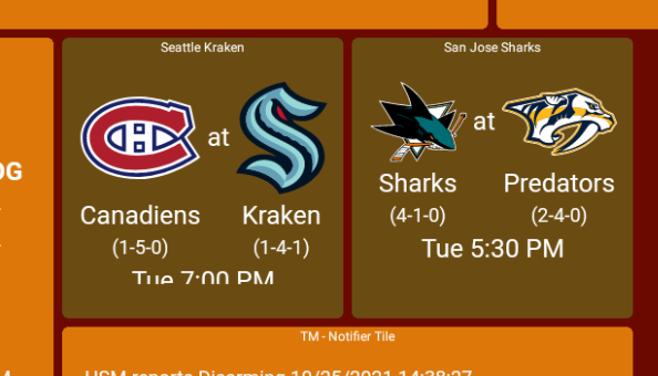

as I look at the WxH ratio of many logos in the NHL, there is a fairly 'square' shape to them. When you apply a sizing via css ala 'width:100' you get a default 'height:100'. Since AFAICT the seattle logo much more rectangular with the longer side being the height. Looking at the code it seems that there is width defined in your table (which is a work of art, if I may add) and the adjustment of the row height is dynamic to the images being displayed. Here's a much more useful image to see the impact:
As I think you can easily see, the Seattle logo is nearly twice as tall as any other logo, but is the exact width shared by all 4 logo's.
I was thinking you'd need to set max-height but since HE doesn't use predefined container you can't rely on that - honestly, I'm not sure how to work around this!
PS - the image in the preceding post was from the AndroidDashboard - this image is from a HE dashboard.
