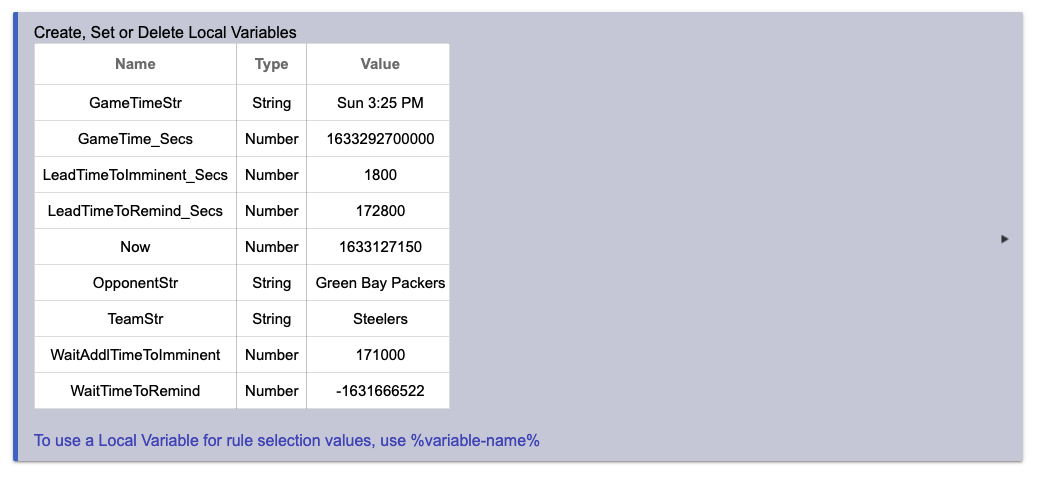

Warning: there is one problem I haven't resolved yet. Perhaps @JustinL could weigh in here? When I try to convert the gameTime attribute into seconds (looks like its stored in the device in milliseconds), it throws off a "java.lang.NumberFormatException: For input string: "1633292700000" on line 733 (method appButtonHandler)" error. All I'm trying to do is divide that number by 1000 to convert from ms to sec. Wonder if HE can't handle math on such a huge number.
Beyond that known problem, I believe everything works, but I haven't tested much. You're welcome to take it if helpful. Would appreciate knowing if there are problems.
Here are both the rule and the local variables:

Speaking of Rule Machine headaches, I think this is because I've defined the gameTime attribute as a string, not a number. I had it as a number at first, but then realized I needed to be able to handle the case where there's no game scheduled. I can't set the gameTime attribute to null when there's no game (lots of posts in this community about that....). So I needed to assign it some value (like "No Game Scheduled") when there's nothing scheduled. In any event, I see you specified the variable in Rule Machine as a number but I'm guessing Rule Machine just keeps it as a string? Not sure how they do type casting in that case, or if there's a way for you to cast it as a number before assigning it to your variable....or if it will matter once I do the above....
