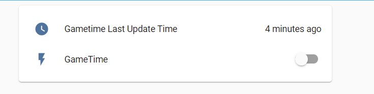

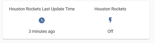

So a dashboard question. After incorporating in Hubitat Dashboard for Android with no issues I've started dabbling with Home Assistant. Using the Hubitat integration in Home Assistant I added these to Lovelace dashboard but it shows up as a switch and a clock:
I also tried adding the child devices (my teams) to Maker API to see how they looked in Home Assistant but it doesn't provide any of the custom attributes like Game Start time or opponent:
Is there any way these attributes can be brought into home assistant lovelace dashboards?
Completely understand if this is out of scope for this app but just thought I'd ask.
I'm not sure since I don't have Home Assistant or use Lovelace. Seems like they would have an option to display a custom attribute? I'm guessing you would want to show the "tile" attribute. Perhaps you can look into that on the Home Assistant forums and report back. If there's no way to do it, then I guess I could expose a URL for you to point an image tile at, assuming you can display an image from a URL in Home Assistant?

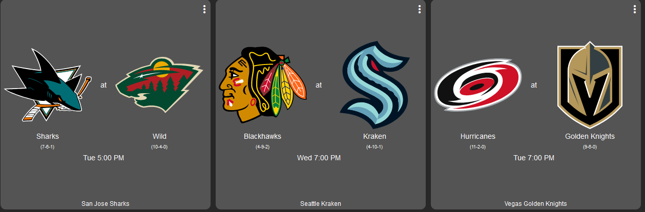

Here is how I had it looking on first pass on the android Dash (which doesn't care about the tile size limit)

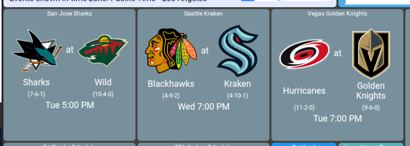

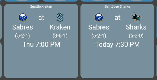

As you can see on the HE dash (I've set text to 80% as that is needed to make my Android dashboard PERFECT!)

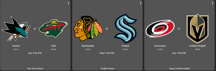

And the equivalent on the Android Dash (the Vegas team name is 2 lines so hence the difference)
I hope you determine my mods are useful and correct and that they help you and others with this fantastic (I USE IT DAILY!) app.

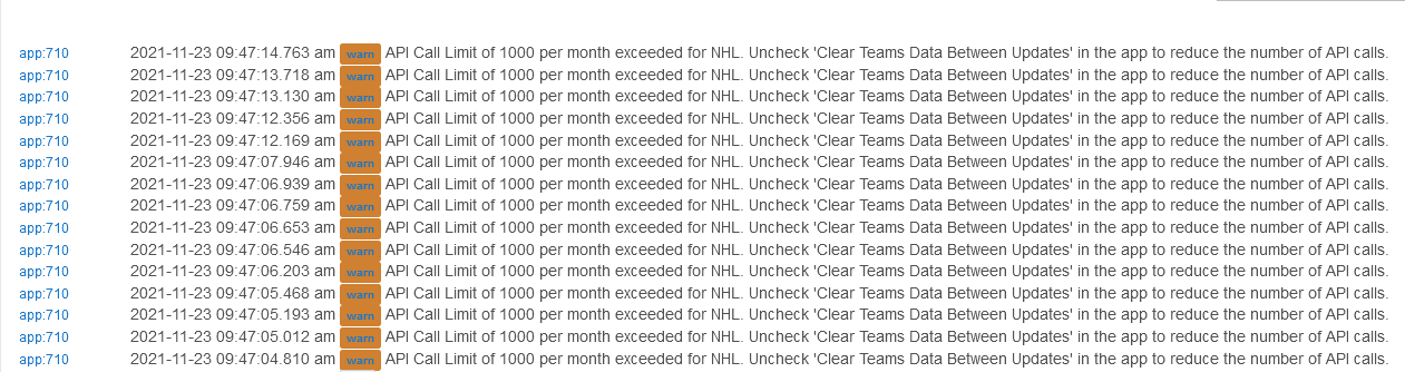

I'm unable to locate this toggle:
That's actually only an option in college sports. The teams data is not as big in pro sports, so the teams data isn't cleared. So, that's not going to help reduce your API count. Do you just have 3 NHL teams? I might have to dig a bit to figure out where / how to reduce the API call count. Off the top of my head, it might reduce it some to make the update period longer. But not sure if that alone would do it since I'm not sure how close to the 1000 calls you are.
Morning - I had 3, and removed 1 today that wasn't really necessary to monitor. I think that GT is updating very frequently when it's not necessary - if the update rate was hourly except when pre-game time is reached it would help!
Or - a variable that allows user config of the update period. I was trying to deduce if there was a way to see the # of updates (such as an attribute or sendEvent counter on the device) as a debug tool. I suspect this might need a bit of foundational thought...
Unless you're seeing a bug in the updates, the app is intended to update fairly infrequently when there's no game ongoing. Once per day. The in-game updates are somewhat frequent out of the box (every 10 minutes). That is what I think could be made configurable for people like you who monitor 3+ teams per league. It would be pretty simple to make it configurable - just have to get some time... hopefully next week.
Look at the state of the Gametime parent device. There's a state variable called apiCallsThisMonth. Bear in mind that, given the structure of the API, there are usually multiple API calls required for each update that needs to happen. So it's not as simple as 1 API call per day when there's no game.

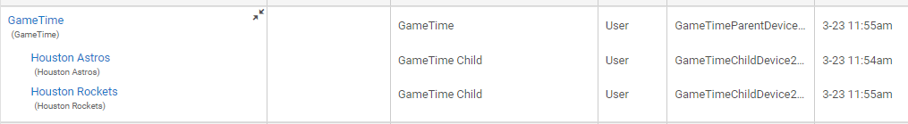

So I recently bought a new c7 hub that I'm dedicating for all my apps/automatons and I'm trying to set up my GameTime app and child devices on the new hub. I installed the app via HPM and tried to add my 3 teams. The first two teams (Rockets and Astros) installed just fine. But when I tried to add the Texans it shows up in the app section:
But it does not create a child device in the Device page:
I looked at the log and this is what I see:
2022-03-23 11:55:00.897 am [error]groovy.lang.MissingPropertyException: No such property: Team for class: java.lang.String on line 1129 (method updated)
When I click the error it takes me to the Texans setup page but I don't know how to resolve the error so that the child device appears.
I've tried uninstalling/installing several times and only the Texans gives me this issue. I still have it installed on my original hub and it shows up just fine there.
Any idea what my issue is?
What version of the app are you using? If the error relates to the line of code that I think it does, it suggests that the app thinks the Houston Astros are in the NFL, not the MLB. I'm not sure if it would even be possible in the app to do this, but can you confirm the Houston Astros app has MLB selected for the league and not the NFL?

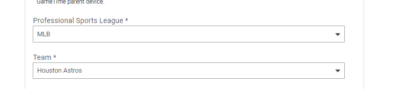

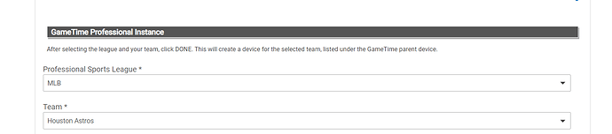

I'm using the latest version from HPM. I just checked all my HPM packages and they are up to date. I did confirm that the Astros have MLB selected both on my original hub and my new hub:
New Hub
Original Hub:

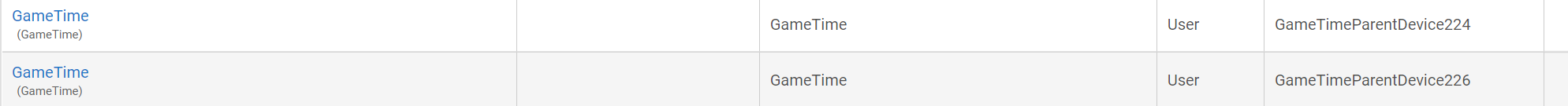

Another troubleshooting step I tried in the new hub is to delete the GameTime app and re-install it. Then I added Texans first but it still wouldn't create the child device in the device page. It just showed a parent device in the device page:
Lastly, I tried to export the Texans from the apps page on my old hub and then import it on my new hub. It still creates a parent device without the Texans child device.:
Apps Page:
Device Page:
