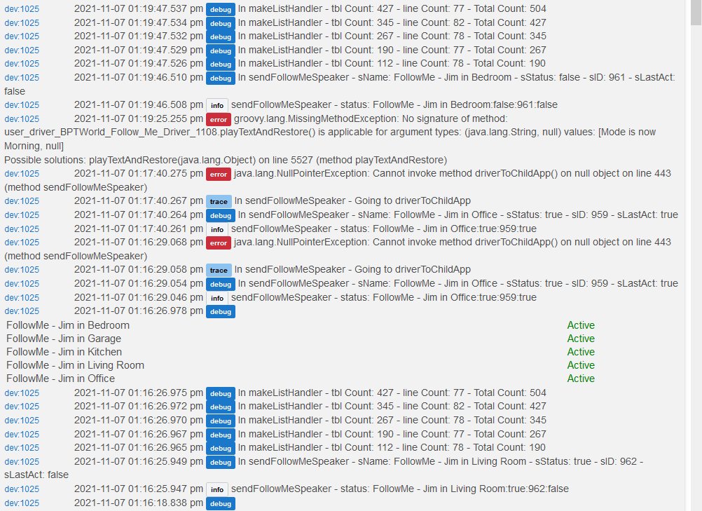

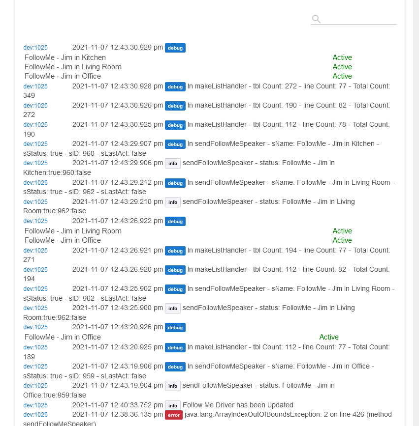

At 12:38 I installed the update - enabled logging and debugging on each child, and enabled logging on the virtual device:
Here is the result of the log:
Seeing activity in the dashboard got me overly excited. I wasn't hearing anything and I realized since I had gutted and reinstalled FollowMe from scratch I had to go back and clean up all my rules that generated text.

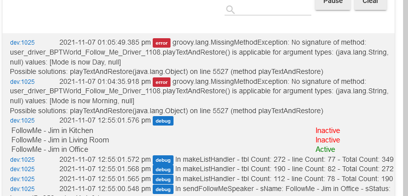

After repair - I triggered a rule that tells me the mode when it changes - I got not audio on my device: here is that log.
I'm going back to reenable all logging/debugging and try it again so it can generate more useful content.
Okay, I see where the error is coming from. Will have to wait until the family is not home tomorrow to do any testing.
