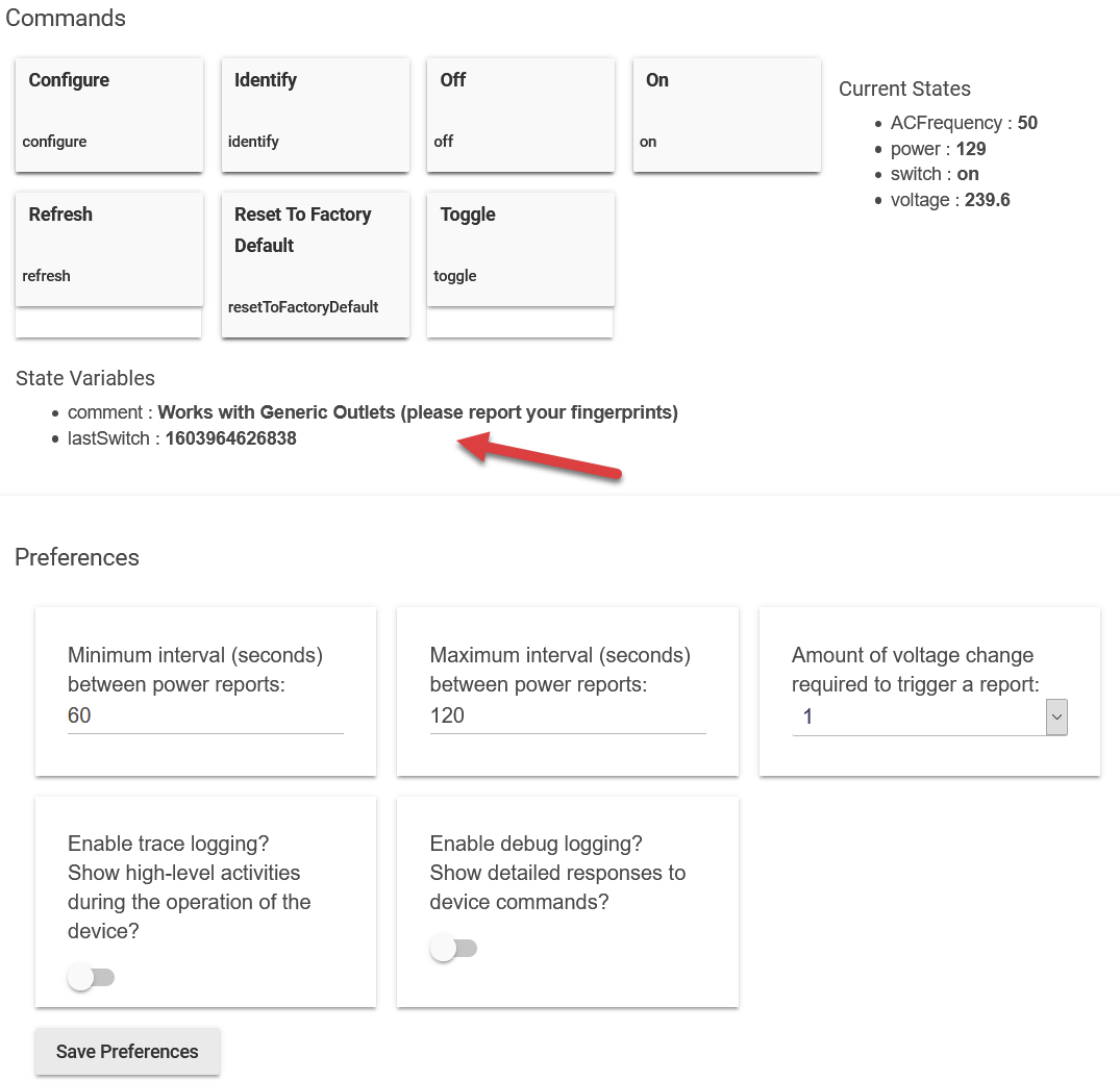

Power is reported, but voltage and line frequency are not. I guess that the V1 Iris outlets do not support those functions. It was worth asking though. Thanks.

And the plug is generating some errors in the log:
dev:1302020-10-29 10:34:08.096 errorgroovy.lang.MissingMethodException: No signature of method: user_driver_shackrat_Iris_Smart_Plug_419.checkPresence() is applicable for argument types: () values: (checkPresence)
dev:1302020-10-29 10:18:57.074 errorgroovy.lang.MissingMethodException: No signature of method: user_driver_shackrat_Iris_Smart_Plug_419.ping() is applicable for argument types: () values: Possible solutions: find(), print(java.lang.Object), print(java.io.PrintWriter), print(java.lang.Object), find(groovy.lang.Closure), run() (ping)
dev:1302020-10-29 10:08:26.104 errorgroovy.lang.MissingMethodException: No signature of method: user_driver_shackrat_Iris_Smart_Plug_419.checkEventInterval() is applicable for argument types: () values: (checkEventInterval)
As i read earlier in this post, this could also be because i've had another driver loaded before yours.
How do i get this sorted out? Do i need to delete the device from HE and re-pair, or do you have another trick..?
Try temporarily switching to this Toolbox driver, resetting and clearing everything, reloading the webpage and then go back to the "Iris Smart Plug" driver.
