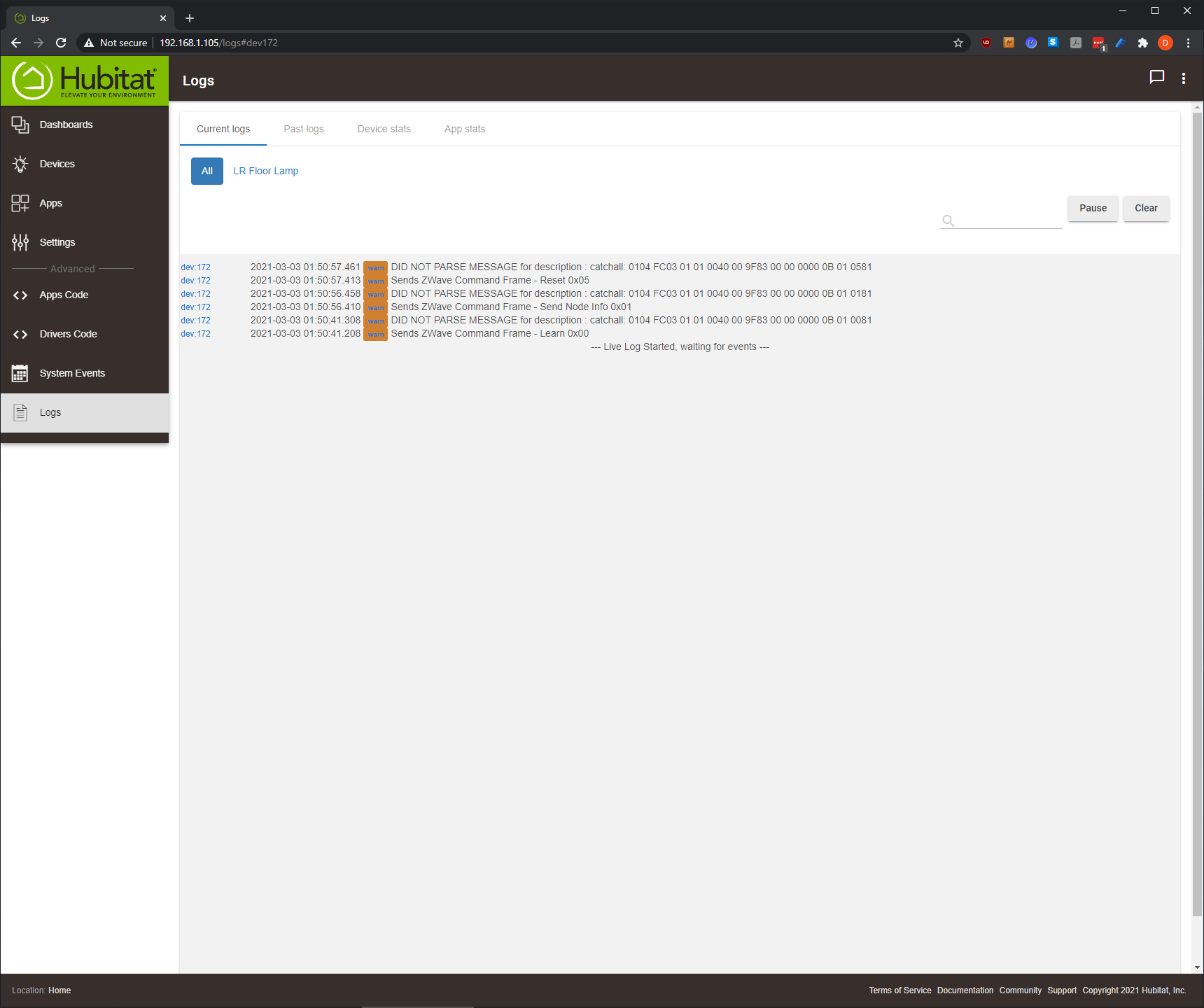

When I try to actually send the commands from the buttons on the device page, however, I ge tthe following errors:
What am I missing here?
